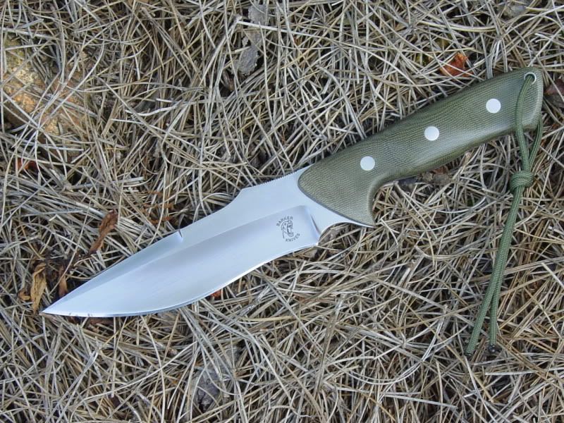

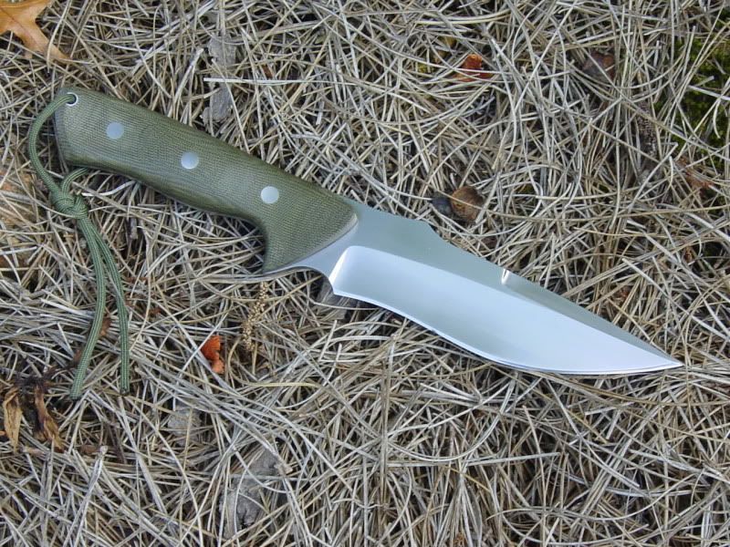

Here is my lastest Tosa in Green Canvas Micarta. I made some minor changes in the handle. It really feels great. 6" cutting edge. 12" OAL. CPM 154 satin finish blade is 3/16" at the ricasso. Tapered tang. Weighs 11.25oz.
I really love making this knife. This is the 4th one I have made.
Thanks for looking.
-John

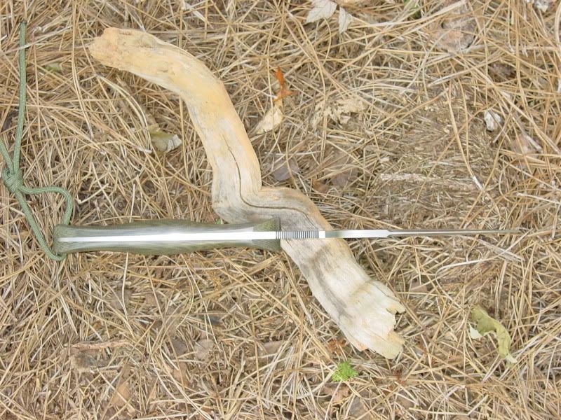

hey, how do you like working with cpm154? do you do the heat treat?
a shot showing off that tapered tang would be good too. that takes a lot of work.

I've been working with CPM 154 for about 3 years. It's a real good steel. I think it is very easy to work. I do my own heat treating. I made up my mind last year to taper the tang on every knife I make and now I'm just accustomed to doing it. It's really not that hard and doesn't take that much more time, but I feel like what it does for the feel of the knife is worth the time. Here is a pic of the tapered tang. I think I only tapered this one to about 0.080" to 0.090". I like to leave a little more for a bigger knife like this, otherwise the knife is blade heavy. Thanks for asking and thanks for the feedback folks.
-John
