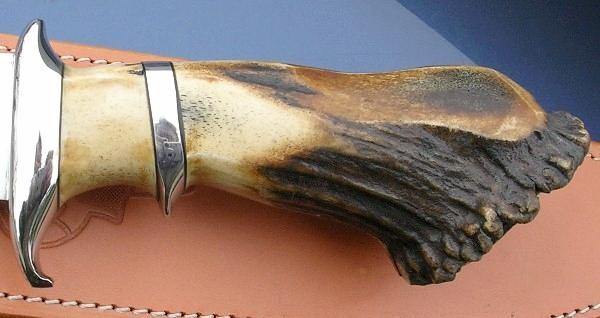

scott if you didn't see this..
this is from red deer it's just about the same..yours could be just a tad denser,, it's very easy stuff to work just make sure it's good and dry.
Very nice! I was thinking of using a piece in the middle of the rack for the first knife, but now I'll have to take a closer look at the crowns to see if they would make something stunning. Thanks for the pictures.
