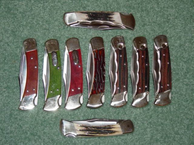

Repaired under warranty... Didn't know at the time about blade upgrades. It is sure pretty..
It is the one on the far left. Pardon the bad reflections, They are all nice and shiny.
