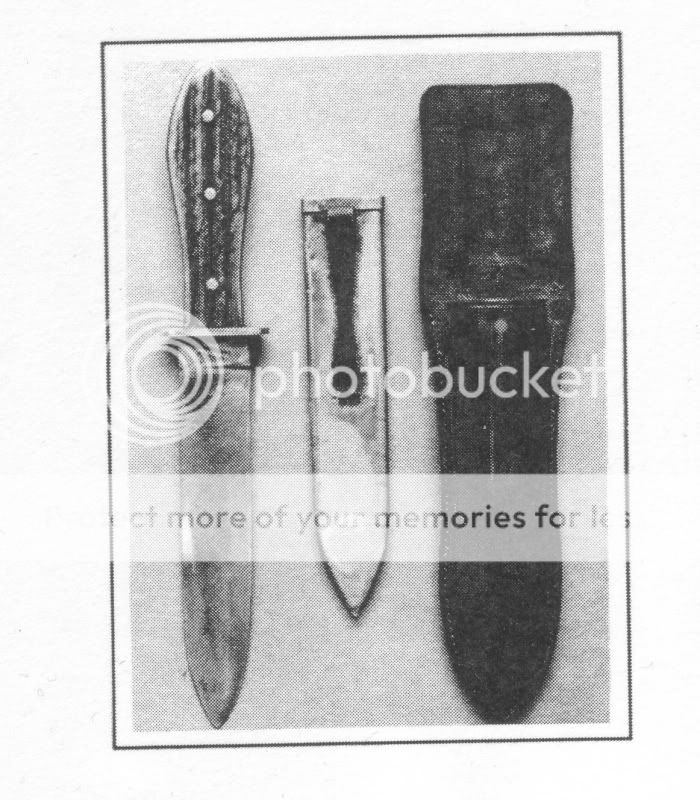

Your sheath reminded me of the Will & Finck and Michael Price San Francisco bowie style. Both of those makers used an attachment for hanging the sheath directly on a belt rather than a frog button. The over sheath was simply two pieces of leather stitched together with belt loop slots on the back piece. You can see photo's on pages 102 and 103 in Levine's "Knifemakers of Old San Francisco".
As I understand it tanned leather in the early to mid 1800's didn't hold up very well. I'm guessing a bit here but using a metal sheath (often silver) that could be slid into an easily replaced leather pouch made the knife more secure in the field and protected the fancy "in town" scabbard. If you posted in Bernard Levine's forum you will get a more factual background and possibly some pictures.

I pulled out my copy of Levines book, and never noticed that was an over scabbard. Thanks for the heads up. The S.F. style knives are one of my favorites and I plan to do work in several of the makers style.
I plan to do the attachment style as seen on page 15 next time.
That's the patented Will & Finck clip on page 15, there's a write up of the patent on page 69 and a side view showing a spring on page 70. Pretty innovative.
Thinking back maybe only the Will & Finck scabbards could be hooked on a belt and the Michael Price knives needed an over sheath.
Here's a couple of close up shots...
Thanks for pointing out the spring clip, I had missed that also. Time to reread the book.

Here is the patent drawing from one of Bernard's posts. The pin is a screw that can be tightened locking the clip from opening.
No idea how the blades were held, I would have thought the interior of the scabbard would be slotted for the blade to ride in. BRL will be able to tell you.

Metal sheaths seem often to have been worn inside expendable leather over-sheaths
-- M Price metal sheaths with steel spring clips could ONLY be worn that way
-- much the way sword scabbards (and English bowie scabbards) with frog studs were worn buttoned into expendable leather frogs that hung on the belt.
I have seen quite a few English bowie scabbards with leather over-scabbards, and probably quite a few more over-scabbards were discarded by iggerant collectors and the dealers who cater to them.
