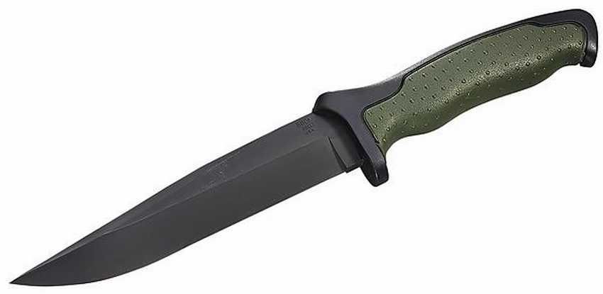

Nighthawk re-handled?
No, as it would be very difficult to do . Now should you want to rehandle it ---its not so difficult . DM
Has anyone actually wore out the grip on their Nighthawk and had to re-handle it?

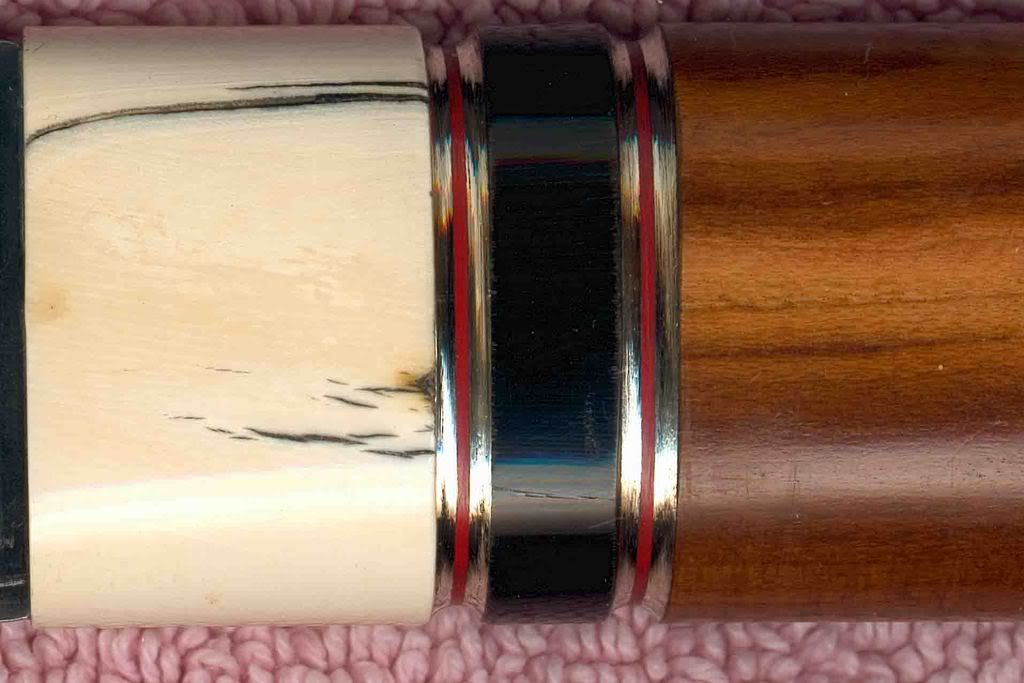

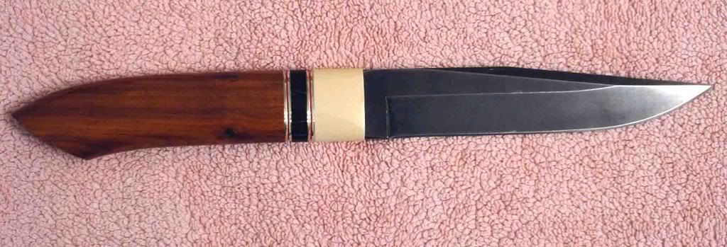

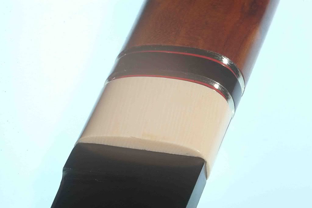

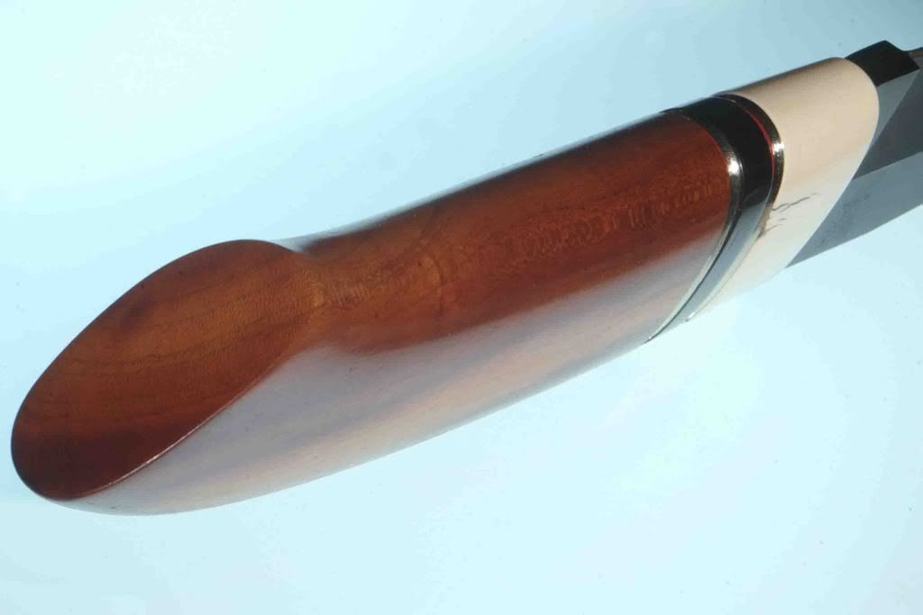

Doc, David, it is no problem to rehandle the Nighthawk. The "rubber" is easily
cut off with a draw knife and then you can do what you want.
The tang has two holes you can use for rivets - if you like. I made a handle
with a stick tang (is that the correct word?)
I drilled a hole in a piece of plumwood, honed it, that the hole fits to the
tang, filed a square hole in a piece of mammoth ivory, tins of nickel silver,
two pieces of red paper fiber and a piece of buffalo horn.
Than I glued all together, ground and filed off what doesn't fit to a knife
handle, varnished and polished it, and ready was the Haebbie NIghthawk.
To your success!
Best,
Haebbie

Been really looking at the pics Haebbie, how did you get the tin and red spacers with such a smooth concave? I love it, so you've got color and some texture.
R
Thank you, guys, for your kind comments. It is nice to read that you like this Haebbie/Buck Nighthawk.
The knife copies the scandianvian style and I like the symmetry from edge and back of the handle.
russde, the concaves are filed with a small key file. everything is handmade.
