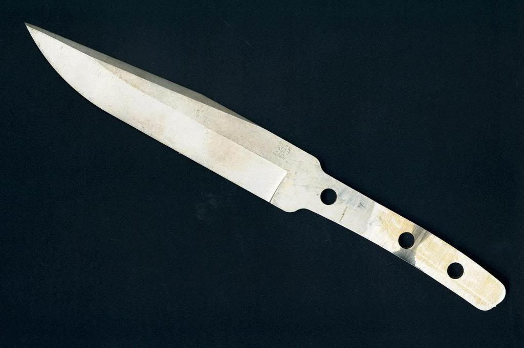

I own 4 Nighthawks but they are not users to me. I know Haebbie has removed the handle off at least one so he would know.
There was a discussion at the BF what a full tang is.
The sparks really flew in the debate. So I'm not able
to give you an answer without to reopen old sores.
But have a look and decide by yourself what kind of
tang the Nighthawk has ;)
Haebbie
please excuse the bad scan quality
