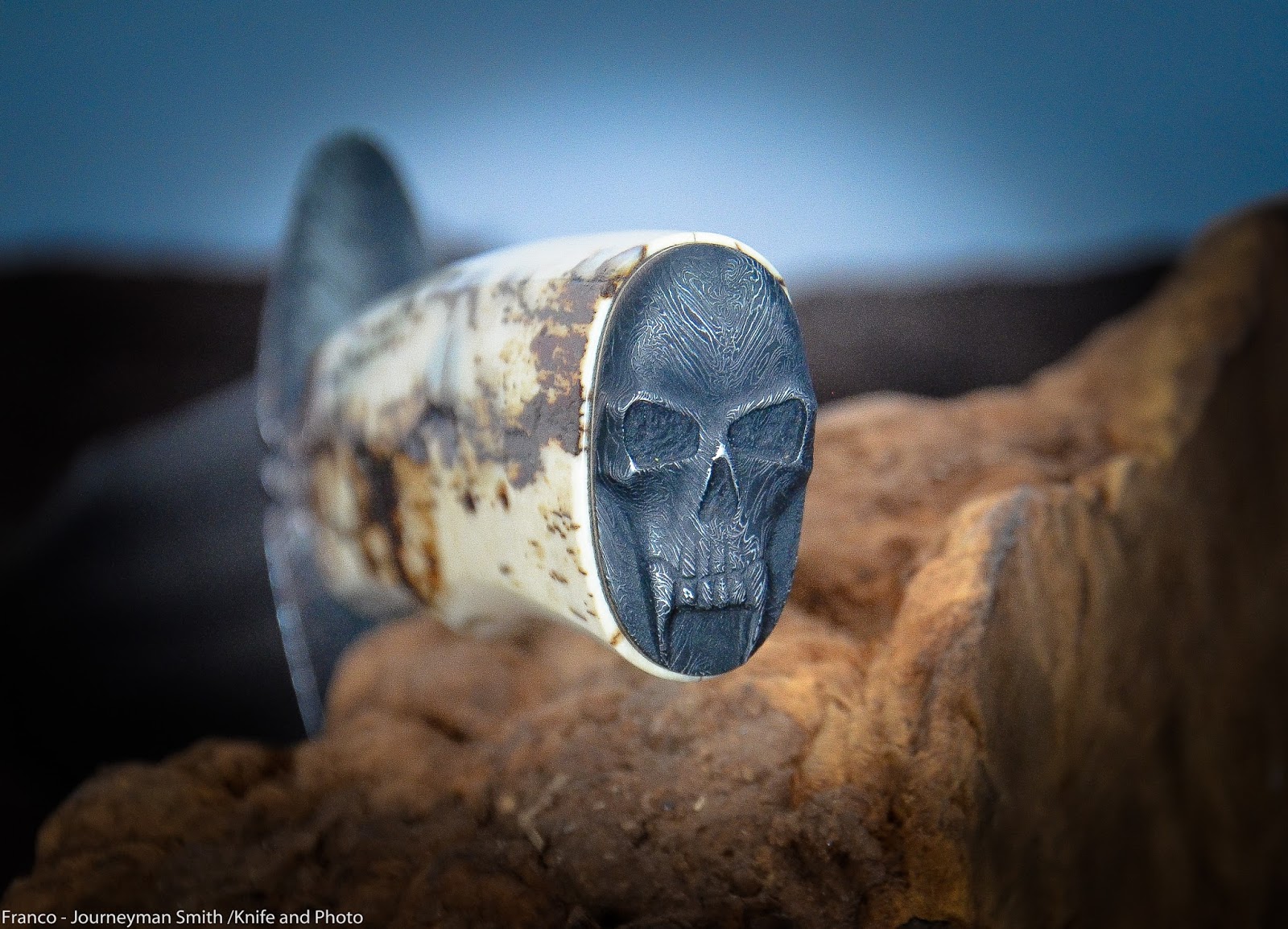

I wanna present to you one recently work, named Nightmare Bowie.
The blade: forged sphirograph turkish damascus pattern, 8 bars, 1070 x 15n20.
Dimentions: 473 mm overall, 323 mm blade, 6,7 mm thickness, width 55 mm.
Fornitures: Sphirograph damascus pattern guard, Ferrule and pommel, with 18k gold inlay.
At the pommel i carved one Skull... with vampire inspiration.
Sheath: cow leather with a ostrich skin inlay.
I hope you like it!!
All comments and critics are welcome!!

What a great piece! Excellent work. I love the leather pattern in the sheath, complements the skull motif well. Also a big fan of the ferrule inlay.

Super cool man. I love the vampire skull on the back. It turns a familiar design into something extremely unique. If I saw this at a show I can imagine myself saying man, there were a ton of incredible bowies there, but that one with the carved vampire skull was especially fuckin sick!!!
Sweet!!!! It didn't look at all nightmarish until I saw that buttcap. :D

This knife have this name because, was a real nightmare to produce... 3 blades to the same knife... but i love the results of much study and steel.

Super piece, great sheath to compliment. That steel 'steals' the show for me. Awesome work, my friend.
