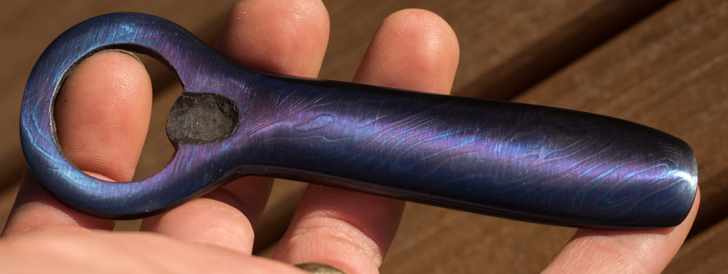

I've been dunking damascus steel in NitreBlue for a week now, experimenting, and figured I'd see if other folks were willing to share their thoughts. With 15N20 and 1080 steels, I'm really just seeing the difference in the etching itself, not in the NB effect, but when CruForgeV is added to the mix, then I'm getting a nice color shift between the steels (15N20, 1080, and CruForgeV - I believe it's the 15N20 that is turning color first):
So my first thought is the tempering/oxide colors versus temperature is dependent on carbon content (since the CruForge should be a few points higher), but could be other elements alloyed in the mix... Unfortunately I've got limited steel on hand (and don't really want to throw any mild in the mix), so figured I'd see who else has experimented with this?
Currently have another gordian knot billet (CW twists 15N20/5160 and CCW twists 15N20/CruForgeV), that could give an interesting pattern if the carbon content is the main indicator for color... will post results of that once it's done.
Curious if folks have any favorite steels for NitreBluing as well...
Cheers,
David
Don't remember which steel is which (aside from the 15N20), but a little contrasting color came through in the gordian knot billet... the 15N20 seems to be the 'bluest' of them, so thinking the carbon content is not the primary indicator... have to see what other steels I've got laying around. Tempted to blue up some punches and chisels as well (S7) next time I fire up the salt pot.

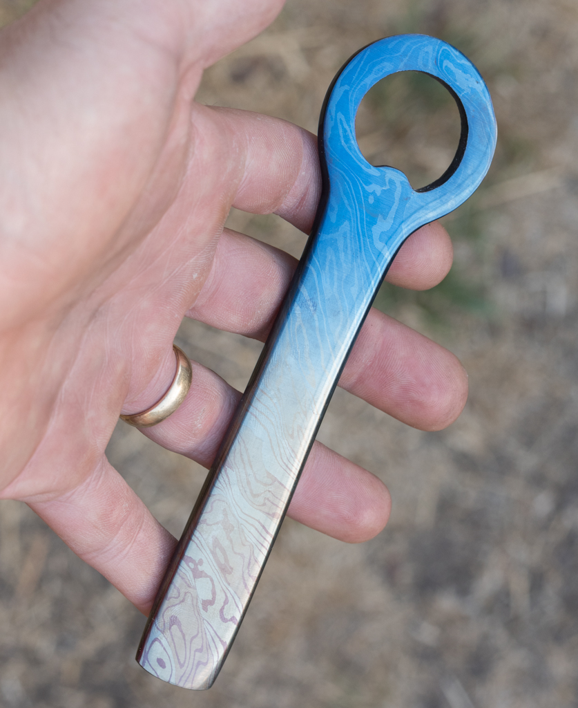

5160 and CruForgeV give slightly different colors in the 600F bath, and enough of a shift compared to 15N20 to provide a nice color contrast without etching the steels. I've also gotten a pale copper color from leaving 1080 in the bath a while at a little bit higher temperature, but haven't experimented too much beyond the gray-blue color range yet.
A203E is next on the list to try as the claim is that turns green at ?? temperature...
Cheers,
David

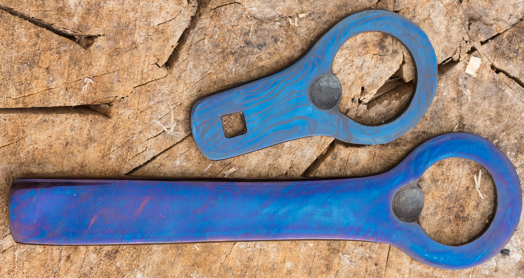

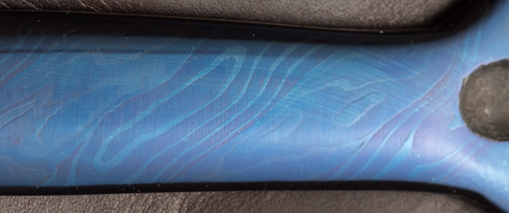

Getting a bit of color shift between each of the steels, although the main shift is between the 15N20 and the two non-nickel steels (slight shift between the 5160 and CruForgeV). A gray ScotchBrite belt was used to finish them before bluing. Pretty happy with the middle pic, but think I'll stick with just 2 steels until I can find something else with a larger color shift:

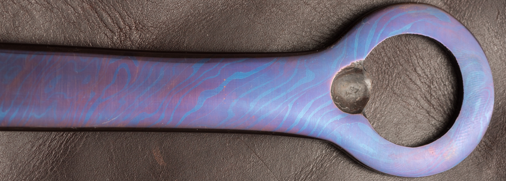

And the first one again in sunlight:

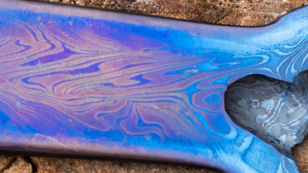

and some more experimenting with longer soaks this afternoon, in the 10-30 minute range, still with the salts around 615F.
here's the results of blue and beyond for the three steels - the candy cane effect comes out much better.
not your usual tempering spectrum obviously... ranging from almost purple at the end, through copper, pale green, and yellowish tan and then to the blues. next try will be at higher salt temp...
