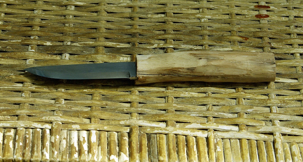

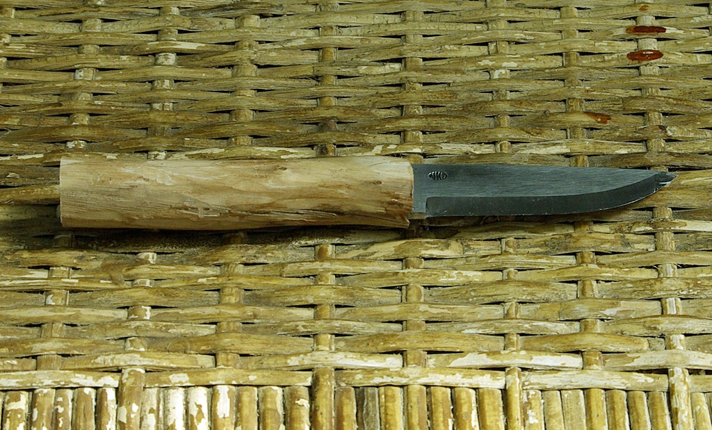

Been eyeballing this blade for some time :
Plan was to take some Gumtree and drill it for the stick tang ( press and glue fit )
The stick tang is a little long so got the chop with my old bolt cutters .
Took some 2 hours to drill the Gum for a decent fit .
Then mixed some epoxy glue and smacked the grip in place ( that press fit ) .
Rough as , at the moment . Sanding will come in the future , where I try to make the gumtree more knife like .
Testing soon ! ( Just need to make a knife first )
