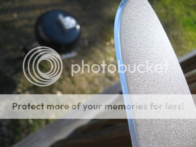

Hello fellow " Where does all my money go " BUSSEHOGS. Question? It looks from the B-site pics that the MMFBM LE has the convex edge ground, and that the standard ones are the usual V-ground edges.
Whatta you all think??

Nope. Just like the SAR5's, the convex is there, just hard to see b/c of hte coating.
There might be a bit of loss b/c they have to grind that coating off at the end, but it shoudl be mostly convex. You can re-convex it pretty quick as some have done here. For $400, how much work are you willing to do? ;)

The cg nmfbm has a convex main gind, but the edge bevel is more of a V,
The NMFBM LE has no edge bevel, it's zero edge, meaning the main grind is the edge, very cool.:thumbup:
You can convert the CG to this style....

It wasn't much work at all to "blend" a convex final edge to the convex grind. Now it should cut as well as the LE, although it's not quite as pretty.
