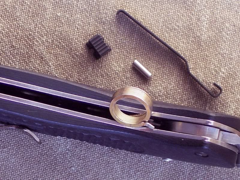

For a non-assist barrage you simply remove this:
This from a 583-1, same frame
It's very easy to de-assist a Barrage. And it can be put-back if you ever want. I just put the spring in the box for safe keeping.

Hmmm - I removed the spring in my mini, but hadn't thought about removing the safety lock as well... That pic has me thinking about doing it now.

The question was asked what the spine of my Warn looks like w/ all the assist stuff removed:
I dyed the red b'spacer more of a violet.
And Joe, you take the knife apart, the spring comes right out. Your call.
