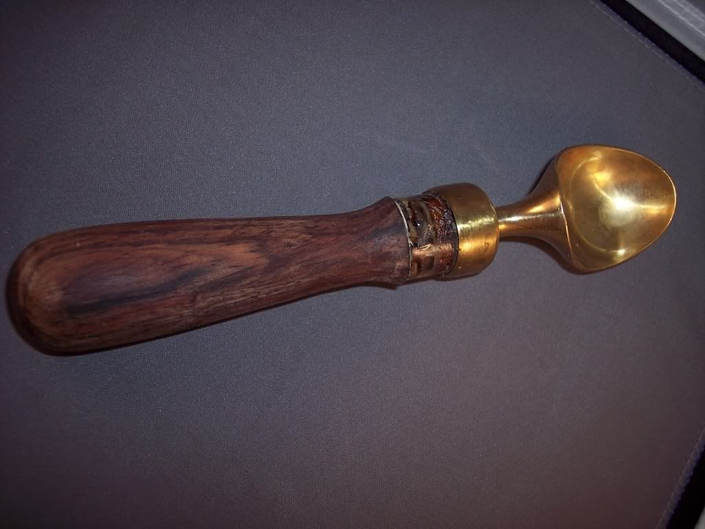

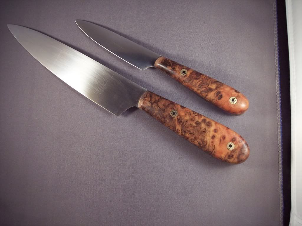

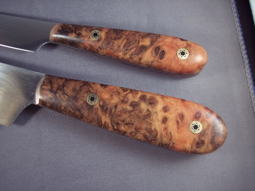

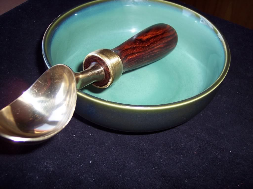

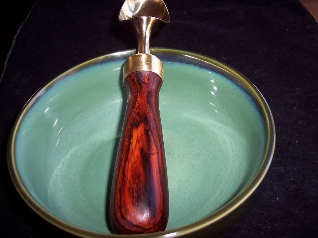

I had given a couple blades and a scoop to some relatives and they put them thru the dishwasher. Needless to say the dishwasher was like a sandblaster and they looked horrible afterward and there were gaps between the scales and the tang on the bigger blade. The scoop was cocobolo but looked really bad after the dishwasher. It was like all the natural oils had been stripped out of the wood and it was bleached a lighter color.
Anyways, I am mailing them back now with new handles and a new scoop.

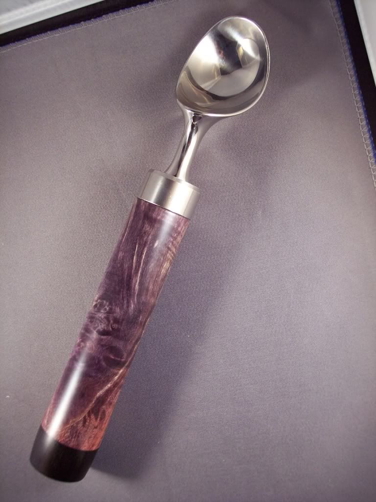

Red Mallee burl and Box Elder burl on the scoop.
Heres some pics.... Larry
No before pics of the blades but heres one of the old scoop. I just bought a new kit for the scoop thru rockler, since that was easier than trying to dismantle the thing any further. The other reason is the old one was brass and the now they have stainless, which seems a little nicer. Anyways you see can a pic below of the cocobolo scoop and how the collar came off. That was put on with long set epoxy, same with the handles on the blades.
BEFORE------->
AFTER ------------->
