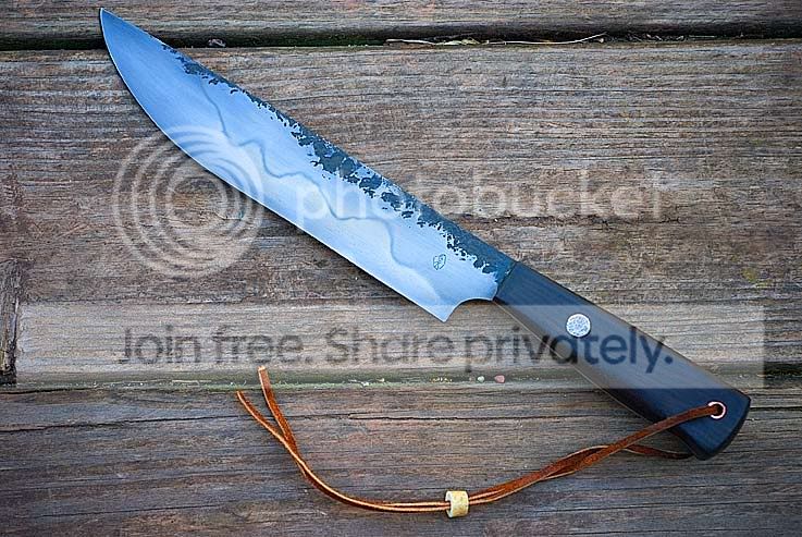

So this is the first blade I've clayed in my new vertical blown air forge AND the first one I've done since getting my Houghton quench K. It is forged from Aldo's 1084, a steel in which I usually get excellent patterns....although all the previous blades were quenched in Canola and heat treated with my venturi forge... a forge that I can use to concentrate my heats more in the blade area. This vertical forge definitely soaks the entire blade more thoroughly! But this thing has no pattern AT ALL! I figured I would get a different pattern... or a weaker pattern.. but none? It hardened just fine. I know these things are complex and that is why I'm blaming it on Aldo (I know he is somehow behind it).
Anyway... this knife is a directly inspired by Jason Knight's (maybe he is the cause?) Sooke Mountain Chopper. I don't usually do direct copies of people's profiles, but that knife haunts me. This thing is 13" total with sheephorn, red spacers, copper and rawhide. A full 1/4" spine with some distal taper.
So have other folks experienced no pattern whatsoever when doing this?

Aldo's 1084 is a deep hardening steel, when properly heat treated you will get no hamon at all.If you want a hamon use 1095 or W2 which are shallow hardening steels

I understand that completely. Although not everyone would agree that 1084 is true deep hardening steel. Borderline shallow it has been called as well. But really? no hardening line at all? when you say properly...do you just mean evenly up to temperature across the whole blade?

Most 1084 is sort of a medium hardening steel....Aldo's 1084FG has grain refiners and extra alloy ingredients to make it forge better and harden deeper. It produces little or no hamon if fully heat soaked and quenched in fast oil. It will get good and hard, though.
Here are a few possibilities. If you clay back these the veturi concentration was bringing the edge up before the material under the clay came up to temp. Thus you got a quench line rather than a hamon. When you went to the blown forge the even soak brought all the blade up to temp and thus a full quench.The type K might be a much faster oil than canola. The faster quench transformed all of the blade rather than the desired edge portion. Did you make this from a new bar of steel or was it one that you have used for previous blades you were able to get a good "Hamon " on? If it was a new bar it may have been mixed up with another type of steel. Have you done any testing on this blade?? There are sooo many variables in getting a good and true hamon that one minor change will prove disastrous. Either a partial or no hamon at all.

Aldo's 1084 is a deep hardening steel. It has Manganese and vanadium to sweeten it. By properly I do indeed mean bringing it all up to austentizing temperatures and using a real quench oil

I see a shadow along the edge of your picture. Is that really there or is it a photo anomaly. If it is there it might be a very shallow hard area. Have you checked the hardness of the back? If it is hard then the shadow is probably just that a shadow. If it is soft you may have not brought the blade up to full temp. Just a possibility.
I think the Manganese content of Aldo's 1084 is a little high to try and get a decent looking "hamon" IF you manage to get the most from your heat treat process.
I can get a fairly decent hamon with 1084 by slightly lowering the austenizing temps and not soaking at temps quite as long, but I somehow feel that I have cheated myself by not getting all that is available with 1084 steel.
My "Old Man" advice would be to get the most from your steel by using proper heat treat methods. There is a fine line between "looking pretty" and "performing great". If you want a pretty hamon, use steels that favor the development of the "elusive" hamon.

thanks for all of this fellas. I'm still relatively new at this... so if I was getting my hamon, or quenching pattern, or however you want to call it... with Aldo's steel with my previous process which was using my venturi forge, getting the edge (to the middle of the blade) up to temperature and quenching in Canola... why would I not be getting the most out of the steel? I'm not trying to argue... I just want to understand. Are you saying that if the whole blade doesn't soak at the proper temperature, the edge isn't going to get as hard (or perform as well) as it possibly can?
