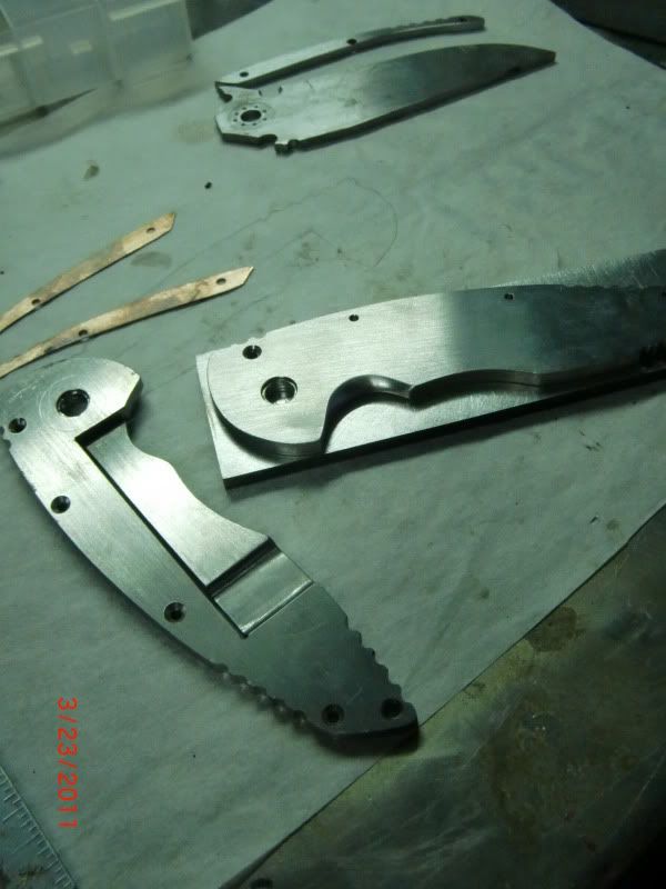

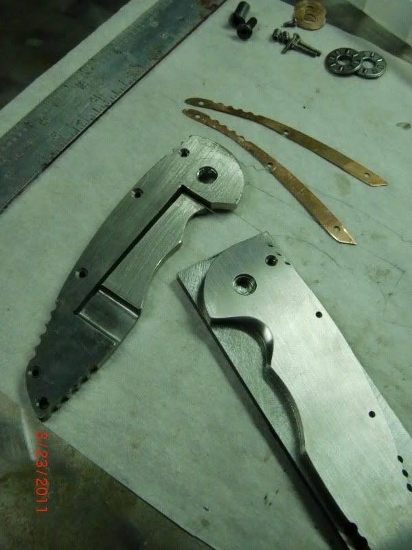

Well I guess I teased enough. I got this done last week and have been carrying it around so mind the dirty bits. I had a couple little issues to work out with the last one, I think this one works very well. The next one will have a little bit different location for the stop pin and the detent ball. But all in all, good strong lockup, no sticky lock, passed a light spine whack, and it flips smooth. I have some better stainless black coated screws coming for it.
This will more than likely be a bit of a flagship model that I will be producing in house. More designs will be following. I will have a few for sale in the next couple months and will be taking orders for them.
Specs:
Blade; .130 thick CPM154CM, heat treated in house 60rc, acid washed for a dark matte finish
Frame; .200 thick 6AL titanium, heat anodized, all internal surfaces jewled
Pivot; .250 heat treated stainless
Standoff; jade green G11
Screws; 2-56 stainless torx
