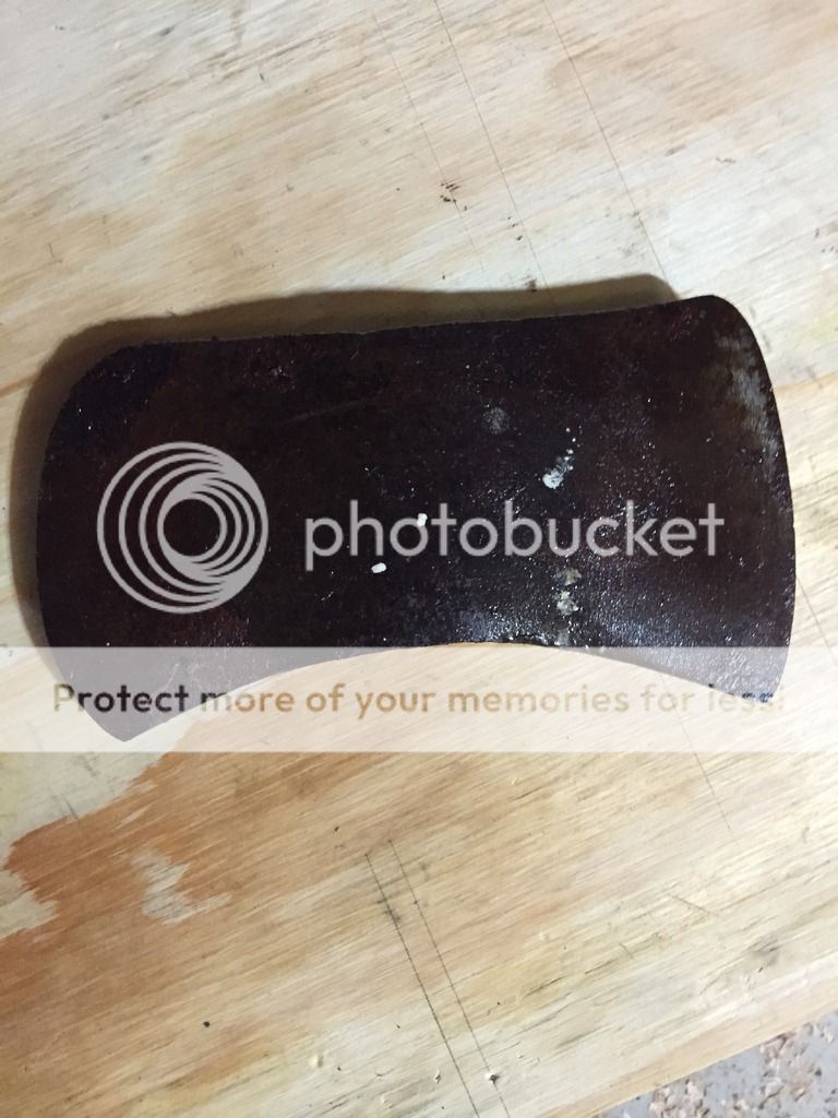

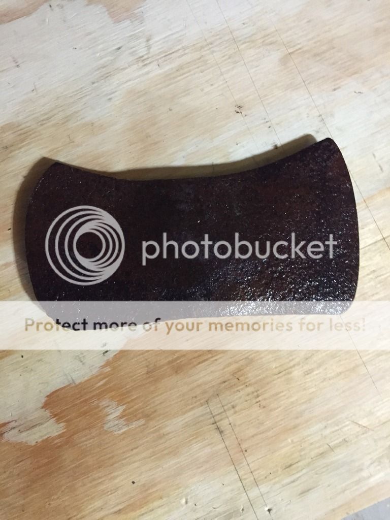

Rummaging in my dad's shed I found a dirty rusty double bit. I haven't weighed it yet but I'm guessing around 2.5 pounds. The handle was not salvageable. I WD-40'd it really good to get the grime and loose rust off. I'll be getting some vinegar tomorrow to give the a bath. As of now I don't see a logo but there could be one in there somewhere. It's very asymmetrical but I don't know if it's been ground or not.
One end got a lot more use than the other, and for a long time. Pray that former owner was not in charge of rotating my tires from summer to winter and from side to side.
It may not even be worth hanging, but hey it was free! I'll clean it up and decide if it's worth putting on a handle. I have no idea where my dad got it. I remember when he built the shed ~20 years ago and assume the axe has been there since. Who knows where it was before that...
I was led to believe, years ago, that double bits featured a thin blade and a thick blade but none I have ever looked at since factory-differed from end to end. Now it could be the user had the option to sharpen one side to a thin delicate edge and leave the other end with a coarse edge for 'dirty' work. Certainly the head you've got seems to support this theory.
Yea I have always heard that double bits are "supposed" to be asymmetrical. I've seen pictures of both ways. The more rounded side of this one IS shorter and a little bit thicker at the edge. However I do not know if this was done by the factory. I hit hit with some steel wool and it's starting to look like there are grind marks on both sides from the eye to the edge. Still a lot of rust and patina on there so I'll know more after the vinegar soak tonight.
Mr Cody Wranglerstar posted a video on youtube about his Sager Chemical, he claims it is asymmetrical from factory. I feel like he is full of shit about that. Seems like someone just ground that side a little too long compared to the other.

I've seen that video. His does look asymmetrical before he grinds it. However I have no idea if that's how they came from the factory.

After a few hours in the vinegar there isn't looking like a logo is going to appear. One side is still a little worse than the other. What I am starting to see is Not a good sign... Grinder marks on BOTH bits from the eye to the edge but not in the middle of the axe. The marks are vertical and not uniform but also not too deep. Like maybe someone tried to thin the cheeks. I've decided to take it out of the vinegar and just sand it down. Make it look nice and hang it on the wall in my basement.

The only asymmetrical DBs I've ever seen were as a result of excessive grinding or damage. I've got a nice NOS Walters that will demonstrate two things: DB heads are symmetrical from the factory (or were) and modern axe handles are thick as baseball bats. In new production I've only seen Garant's Chinese heads, GB and one run-of-the-mill Council DB and all of them were symmetrical. Not that we need much support for that observation, but just making sure. :)
