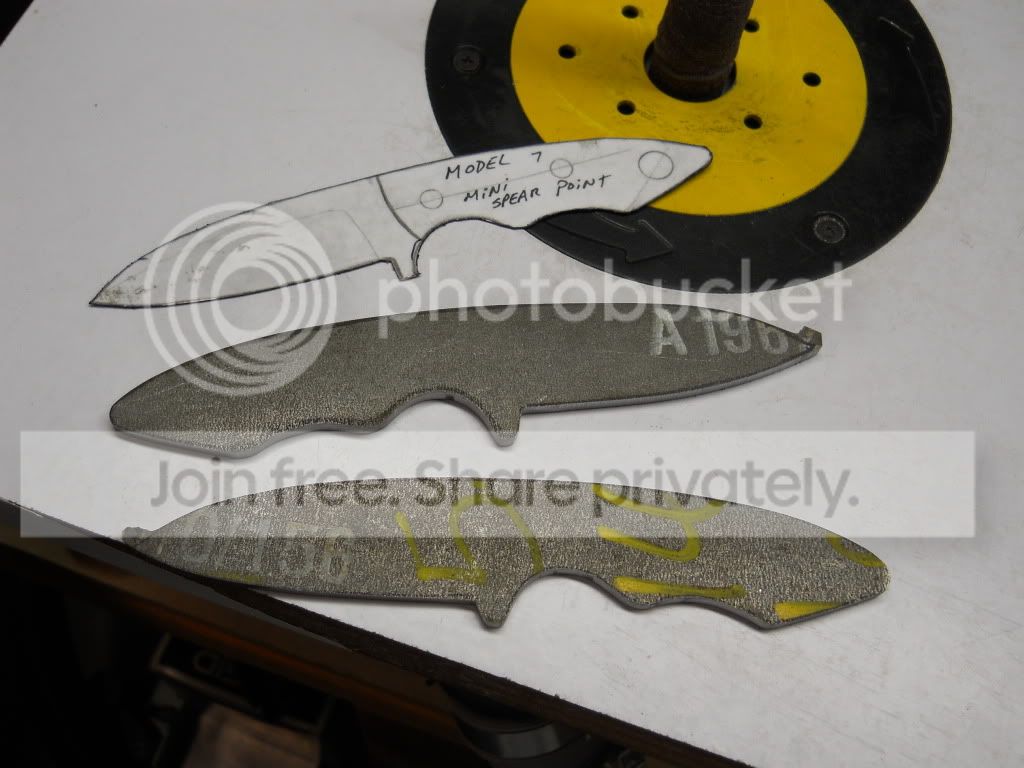

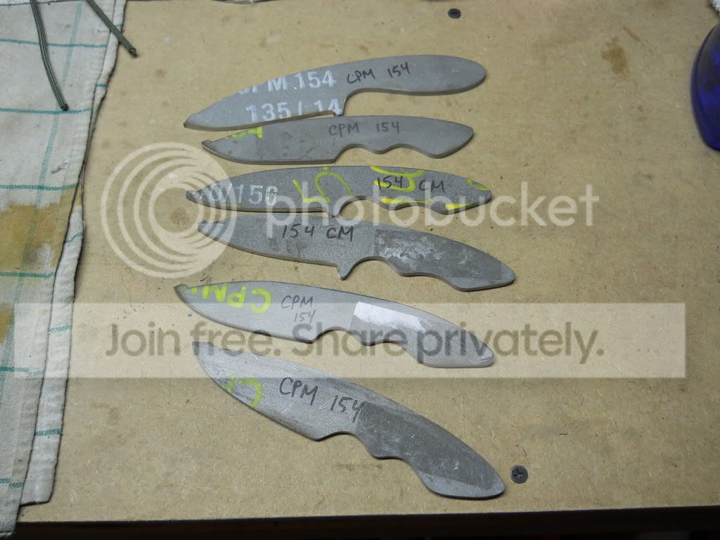

Well, I just shipped out some blades to Bastid yesterday morning after finishing up the last of the knives that I'm taking to Blade to show to some other makers and deliver to a couple buddies. I actually took yesterday off from the shop and didn't even go in there and turn on the light last night, but that break was short lived. Got home from work tonight and couldn't resist any longer. Got a couple blades profiled out for the next batch in 154CM. Two Mini Spear Points coming in at just under 7" overall. The proto seemed to get good reviews so I'm makin' more. Maybe after I get the kids to bed I'll get a few more done.....
I'm addicted to grinding.........and I don't even want to seek treatment:D

Here is a picture of the proto that I did a while back

Johhny... i have a question. I notice on your profiles you seem to leave one area by the tip ungrounded to your profile line. Is that to prevent any damage to the tip while actually doing the grind? Or do you use it as a guide to where you want your final grind(height) to stop? And you clean it up before HT? Thanks as always taking the time to answer my questions.
Hey J,
Thanks for the feedback. Glad you like watching my WIP stuff. I learned a lot from watching others post theirs and always enjoyed seeing it as well.
The extra meat at the tip is something I learned from other makers here on BF. When I first started grinding blades, I was having trouble with my tips going thinner than the rest of the blade edge and as a result when I got my edge down to the .020" thickness zone my tips were being ground away a little bit, essentially changing the profile of my original design. Somebody mentioned that your natural tendency when making a pass on the grinder is to pull away at the end of pass, which can cause you to put a bit of extra pressure on the tip just before the blade leaves the belt causing your tip to be ground thinner. Somebody suggested leaving that extra bit at the end. Now in the event that you pull away and put a bit to much pressure at the tip, the extra bit of steel takes the brunt of that pressure leaving the edge in tact. Once I'm done with the bevels, I carefully grind the bump off on the flat platen, finish it to match the rest of the profile and it's off to heat treat.
Ultimately I think the goal should be to learn to make even, clean passes on the grinder, but having that extra bit is a good safeguard against a small mistake that can change the quality of the finished knife.
