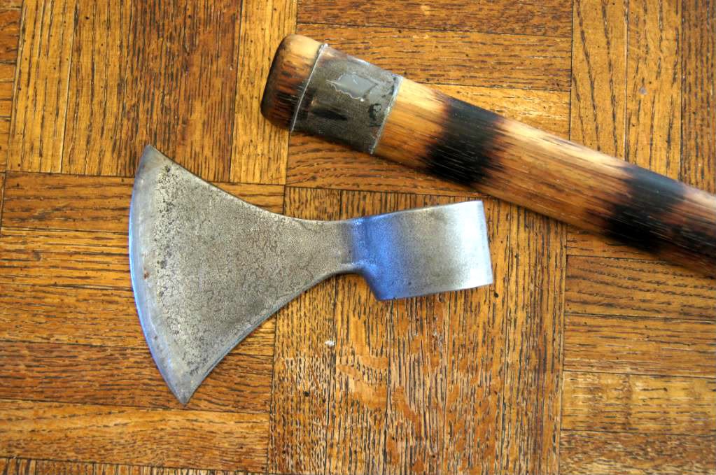

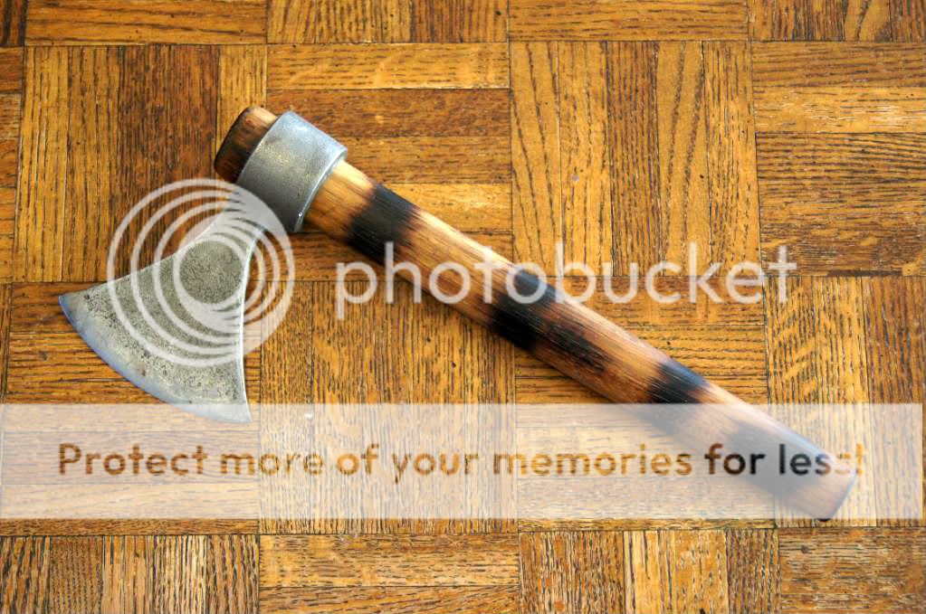

A while back I asked for advise on using epoxy or JB weld to secure a tomahawk handle. I gave it a try for a small tomahawk that I was working on for a camp or hiking hawk. Below is a picture of the result. I really haven't even chopped with it much at all and below is the result. I picked it up the other day and noticed that the head was wiggly. I thought the epoxy would secure for life. I'm sure that it was something I did wrong but it wasn't a sure fix.
Looks pretty good here.
End result.

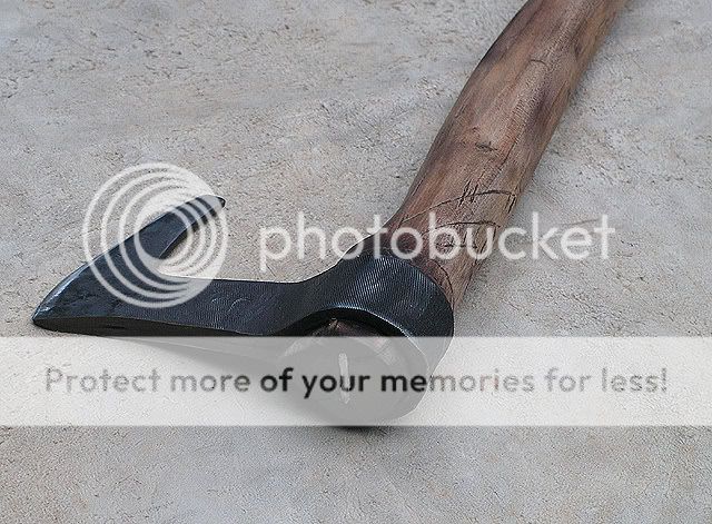

I put an axe wedge in mine. And speaking of leather 'tween the haft and head,
it traditionally was used not only as a head tightener but as a seal for pipe 'hawks....

Product that swells wood fibers. For hanging axes, I use it on the wood wedge and in the kerf before setting the wood wedge.

Wedge won't work on that handle construction. It is a slip fit. Epoxy likely won't work for long either. The fit of the head to handle is what is important.
You can file the head to make it fit, or shape the handle to get a better fit.

If your hawk head has a front to back wiggle, it won't stay on permanently no matter how tight you get the head on.
You guys are fitting the handle to the head first, right? If you don't, no amount of wedges, glue, swell lock or whatever has much of a chance to make a lasting, secure fit. If you do, you won't need any of that stuff anyway. Almost never is there a good fit between the two out of the box. This holds for traditional axes too BTW.
