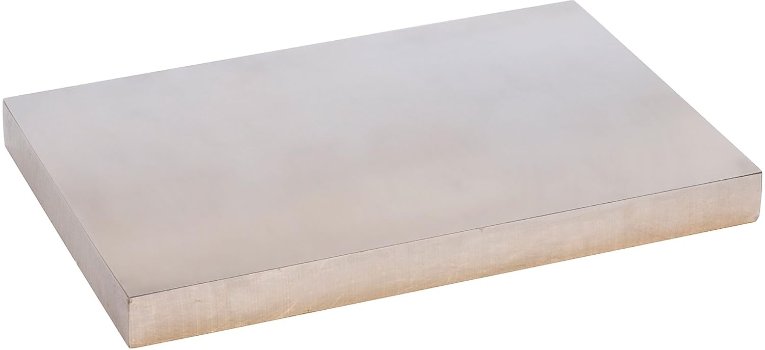

12" x 12" quartz slab
http://www.tandyleather.com/en-usd/search/searchresults/32228-00.aspx
quartz-slab-32228-00.jpg-250x

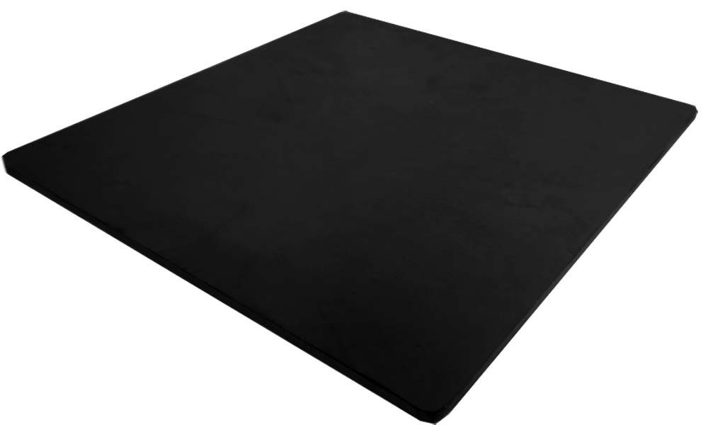

12' x 12' poundo pad
http://www.tandyleather.com/en-usd/search/searchresults/3461-01.aspx
poundo-board-3461-01.jpg-250x

I think both of those are overpriced. They don't list how thick the granite is, but anyone should be able to score a bigger slab for less with a little effort.
Anyone know what a "poundo" is made from? The roll I saw at Tandy just looked like dense rubber. I might be willing to buy a roll of the material and ship out pieces if someone can tell me what it is. It's like garolite or natural g10 (ghost jade) for knife makers. Buy it as industrial material instead of knife scale material and save a bunch of money.
I'm sure they are [overpriced], I just wanted him to have links to see them.
Most vibration dampening rubber sheets are made from Urethane...a form of closed cell rubber foam sheeting:

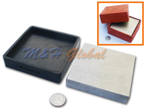

Another option might be a Jeweler's Bench Block...$19.50 and free shipping.:
http://www.amazon.com/ToolUSA-Steel...2-catcorr&keywords=Steel+&+Rubber+Bench+Block
Others are more expensive....6" X 4" X 1/2"....$27 without the rubber pad:
http://www.amazon.com/BRACELET-BENC...=1428190196&sr=8-1&keywords=large+bench+block
and the flat rubber pad is an additional $20...
http://www.amazon.com/Flat-Rubber-B...1428190421&sr=8-5&keywords=rubber+bench+block
