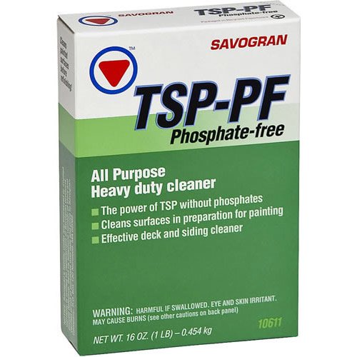

Try a dedicated professional paint store
AMazon carries that if you can get it though customs.
That's the stuff Reactive studios has in the catalog - phosphate free

That's the stuff I was looking for but trying to import chemicals is a real bad idea unless you have a chemical supply business. Not as bad of an idea as trying to use hydroflouric acid for ANYTHING outside a lab setting with major safety gear YIKES!!! but still bad.
I was hoping maybe somebody in the EU knows if that phosphate free cleaner is on the market here and works for a Ti anodising bad.

It's soap.
I'd try ordering one, it's pretty cheap if it gets blocked
I suspect that you can't get that brand, it will probably have Germany compliant labeling.
Have you tried searching in real stores including pro paint stores ?
I can get that stuff in any hardware or grocery store here.
It may be soap to you but I don't have a half a workday to spend at German Customs dicking around with what they call it.
There are tons of soaps and cleaners on the market here, I was hoping to avoid spending too much time buying and testing them all. But I reckon I may have to.
