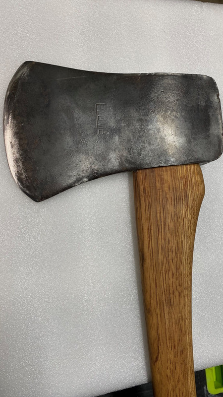

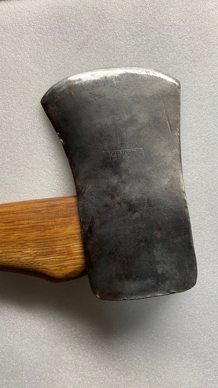

Parker
Here's an example, $6 at an estate sale. Cleaned, sharpened and a new handle. I didn't even see the Plumb name on it when I grabbed it because of all the rust.
