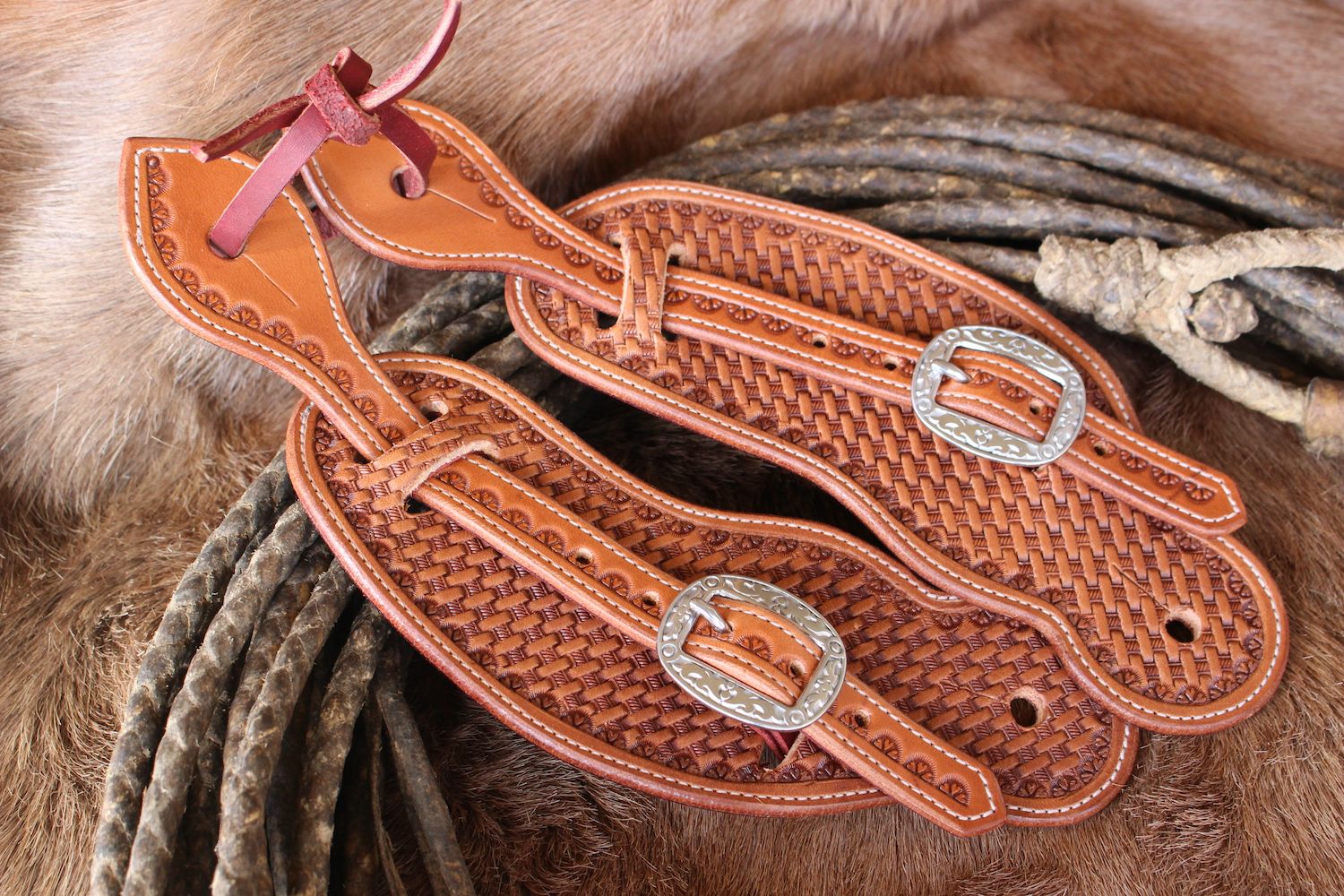

wareagle I just rub the edges I don't dye them. Burnishing the edges will darken them up some but not as dark as dyeing. here's a pair of spurstraps finished off yesterday. This pic kinda illustrates the edges.
Mostly a cultural thing but dyed edges aren't seen much in my world. Mostly I think that is backlash against products like EdgeKote where the darker edge equates less quality. Its not an abosolute thing but call it a buckaroo bias.
Well it's hard to argue with those results! I tend to gravitate toward the darker dyes and even though burnishing darkens the edges it just did not look right to me. I think the problem is more in my edge work and not the color, to be honest.
