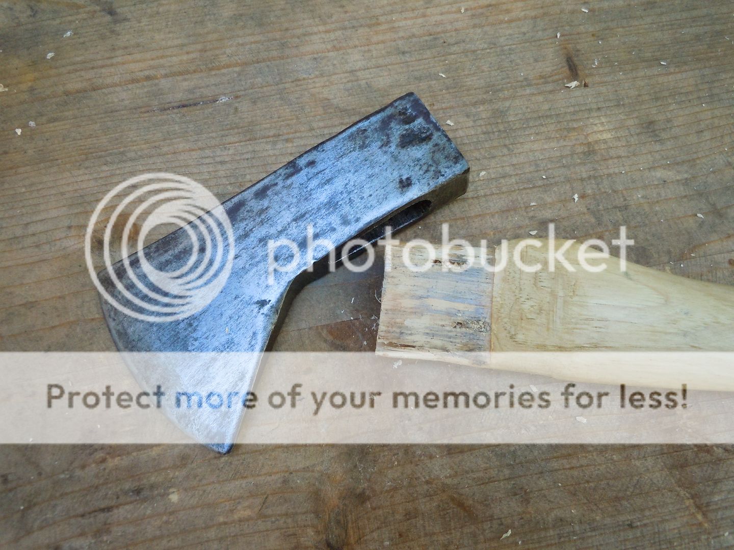

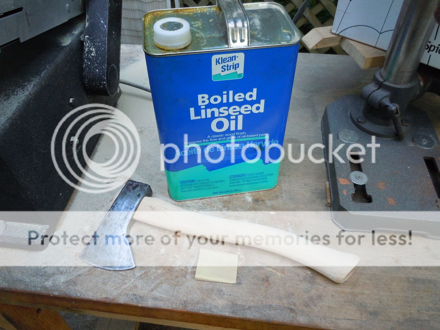

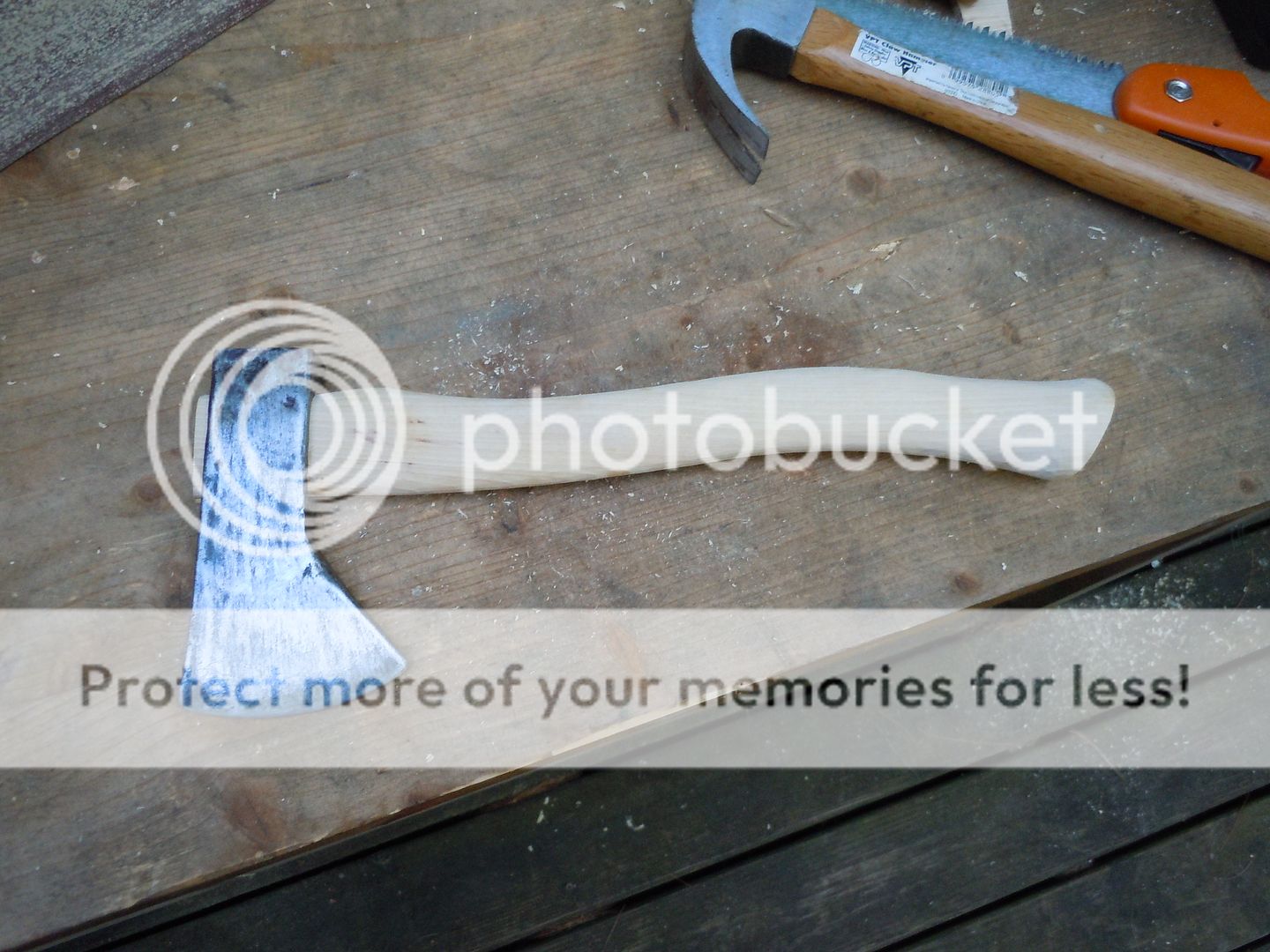

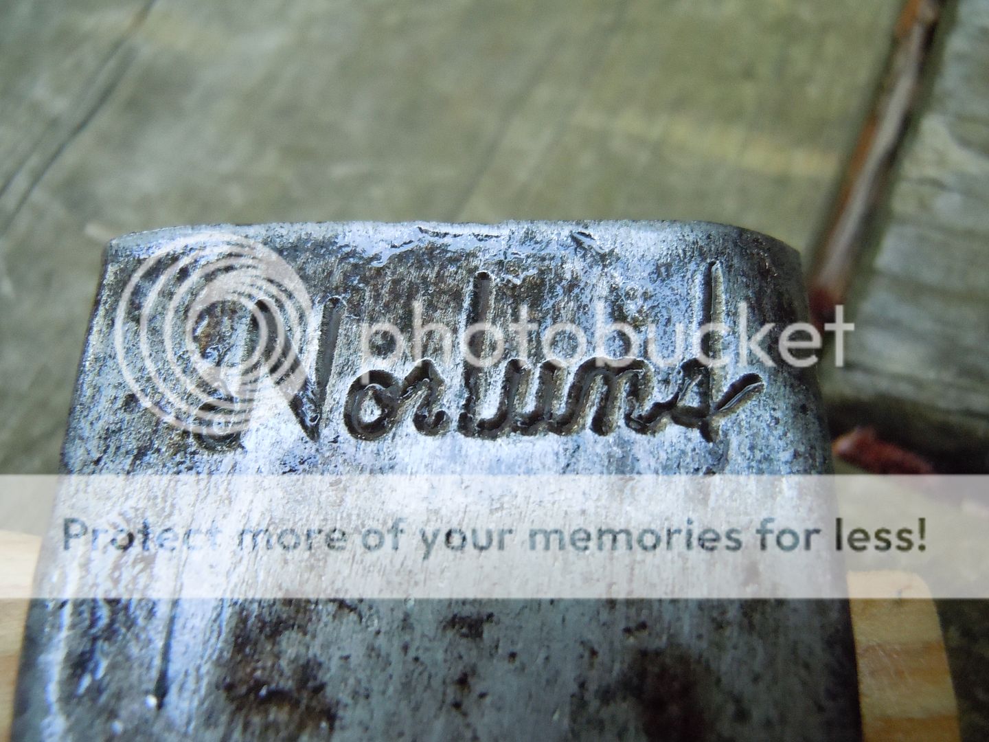

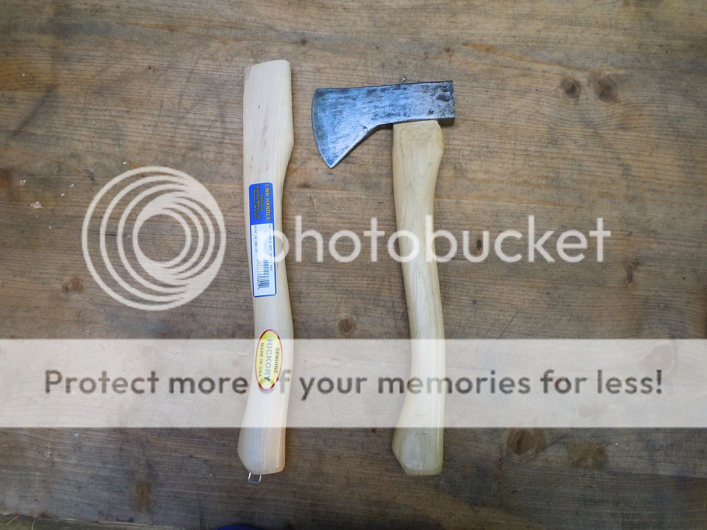

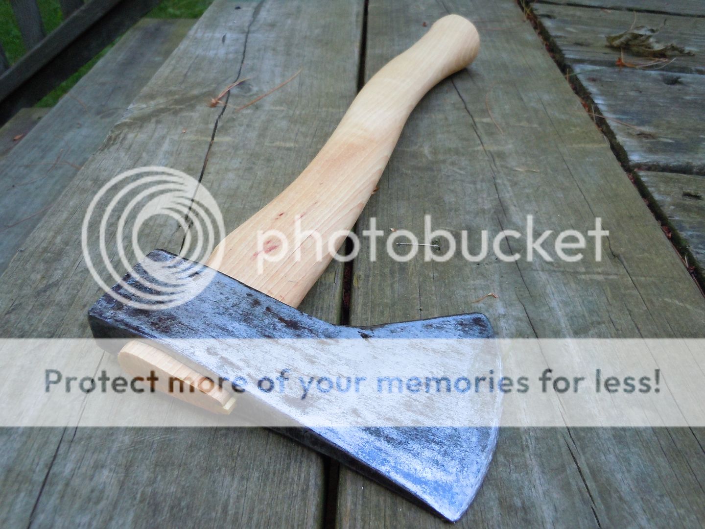

Got this in trade several months ago. Handle was good but the alignment was a little off. Happened in the hardware store the other day, found a nice handle for a hatchet. So I grabbed it too. Decided I wanted to re-handle the Norlund.

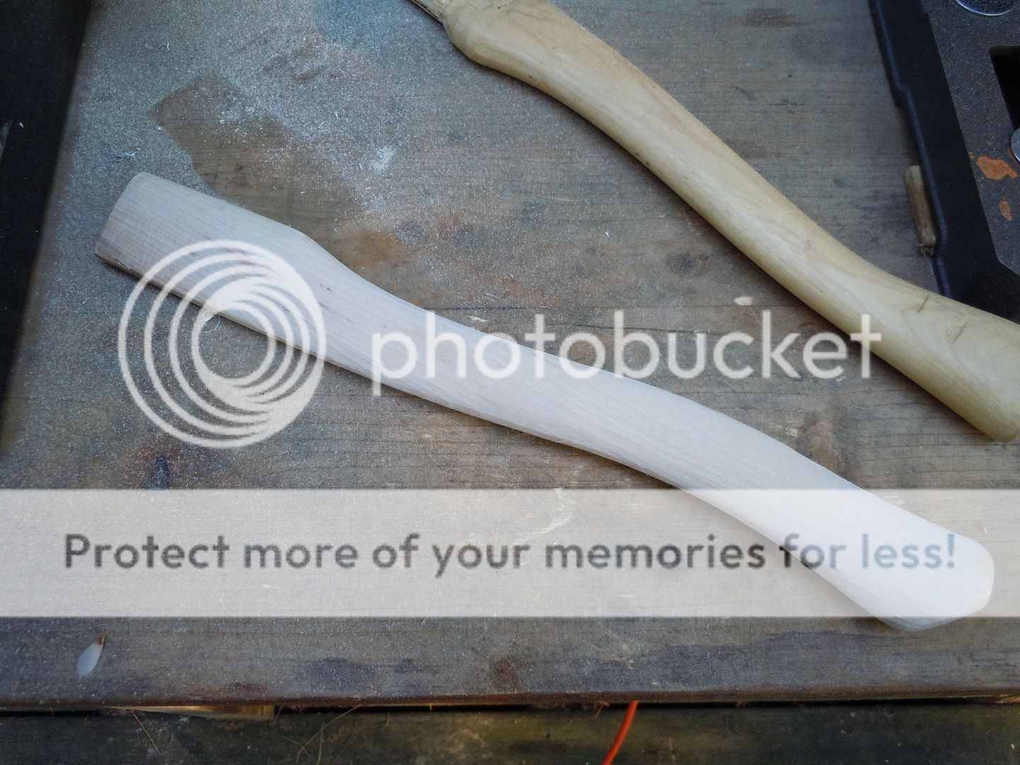

Here is the new handle

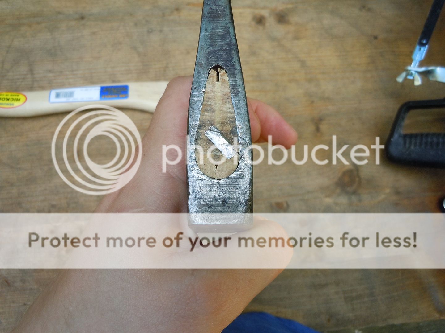

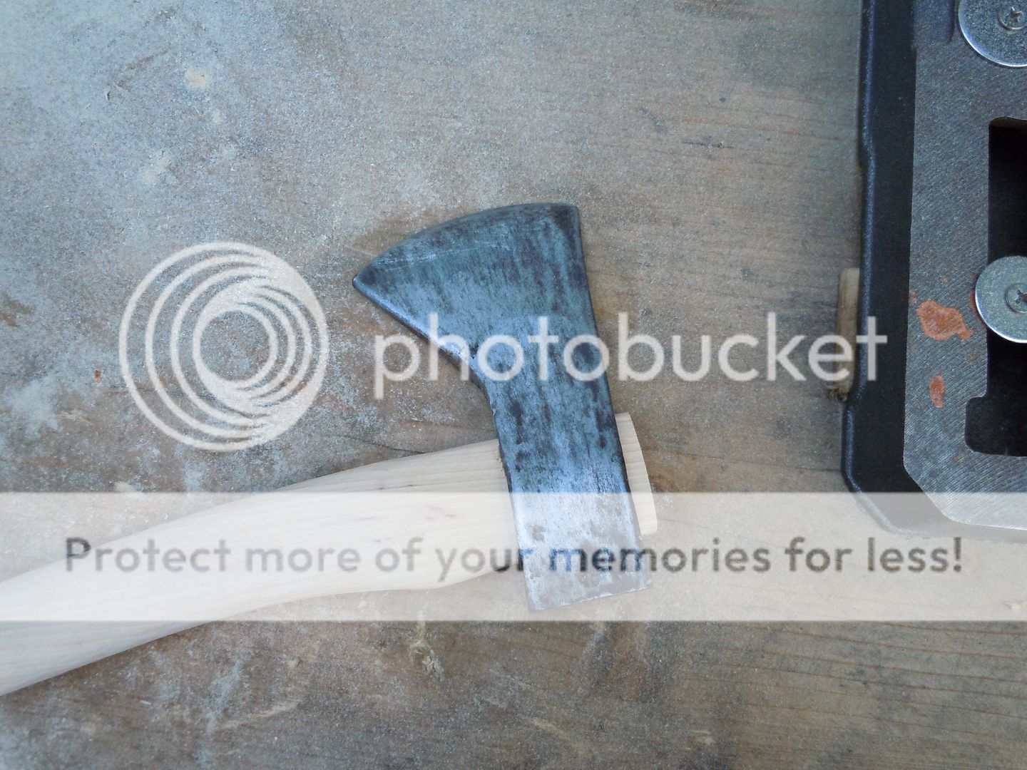

Here is the old alignment

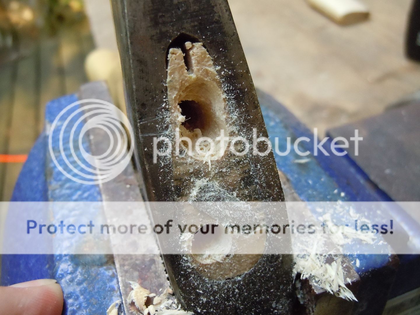

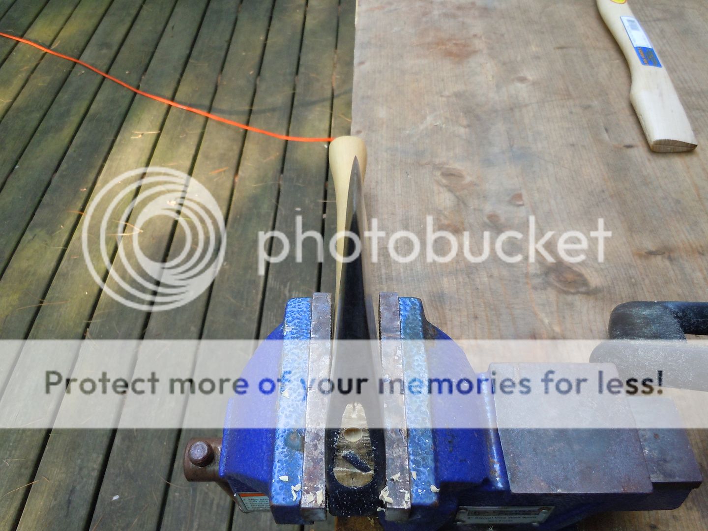

Setting to work, driving out the old handle
After a few holes it came off without issue
Took the new handle to the sander, took off all the hard varnish and shaped it a little better
After some working, the head went on without much trouble

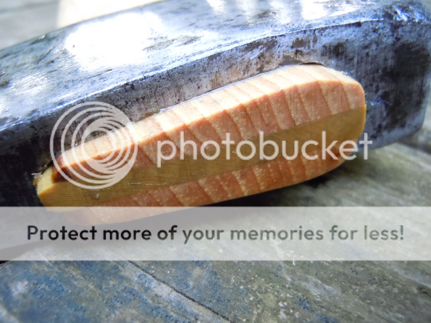

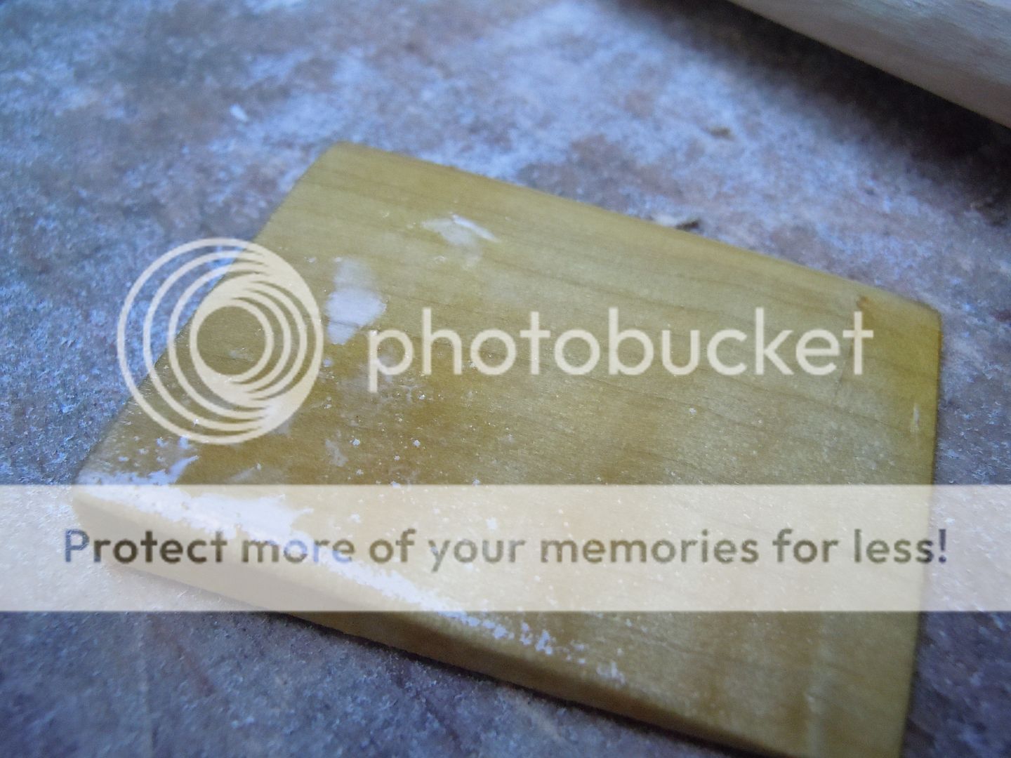

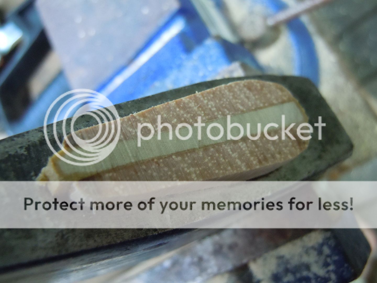

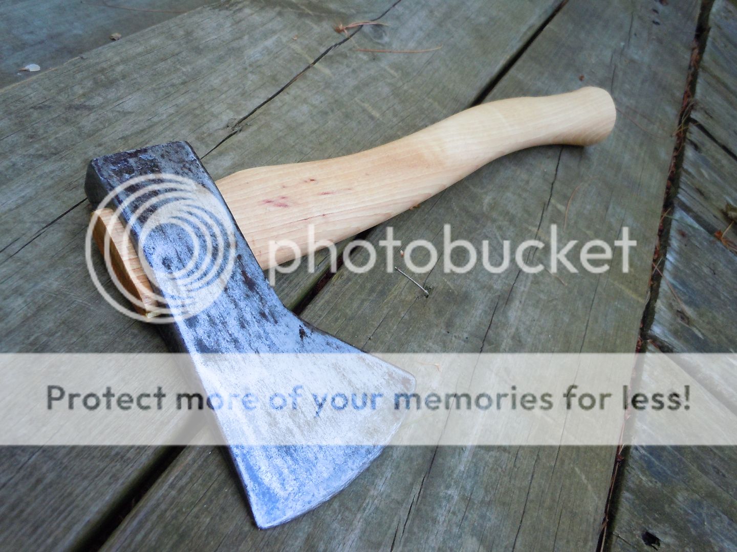

I now use linseed oil on the wedges. It helps drive it, softens the wedge, and hardens and locks up the bond as well after it dries.
Wedge drove home without any issue, nice and tight

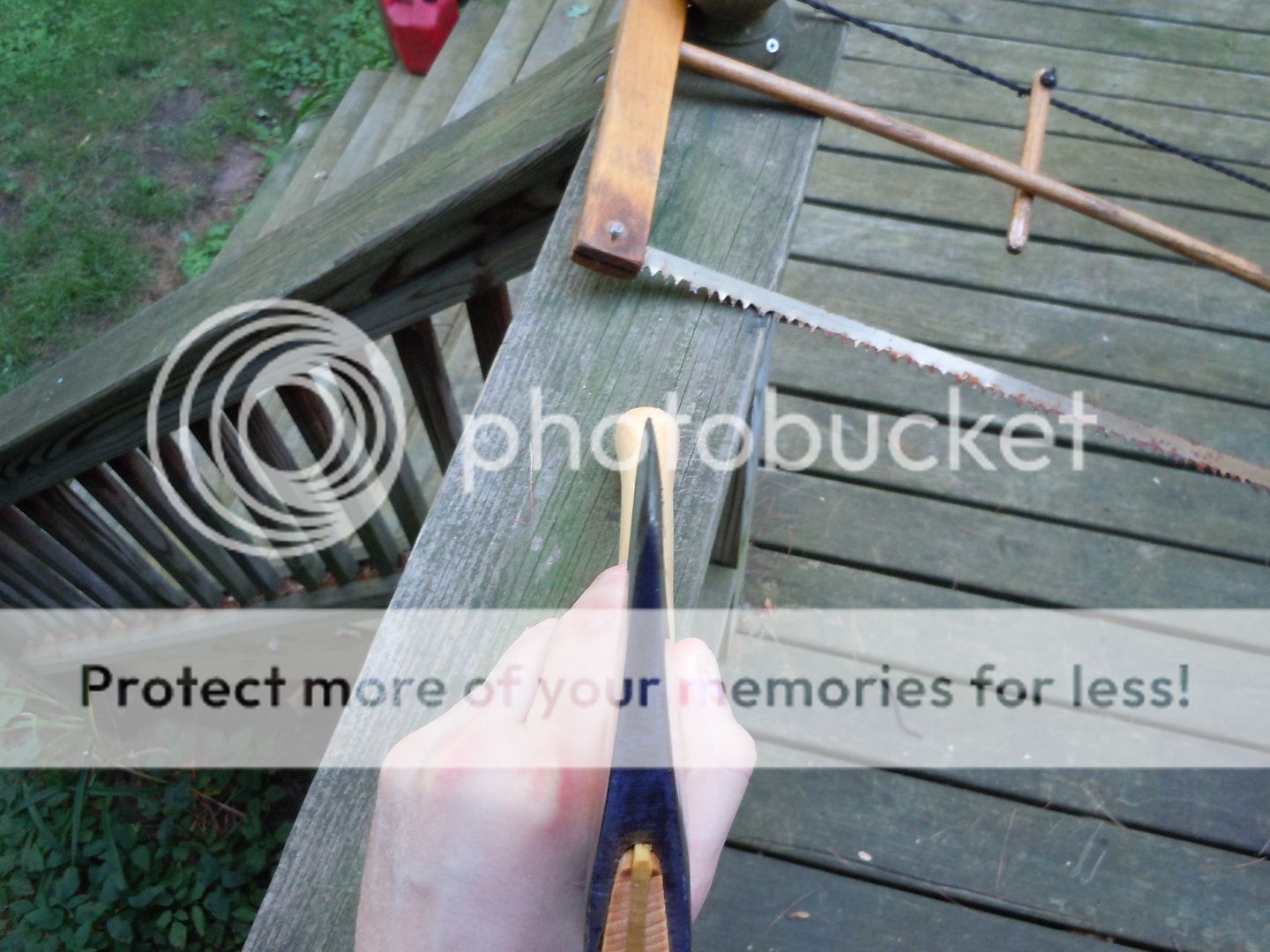

Trimmed it up
Went with a 100 grit sanding finish, this seems to be the butter zone for grip for me.
Now for some oil on the handle and head
My favorite part is oiling the wedge, it sucks in the oil right off the bat

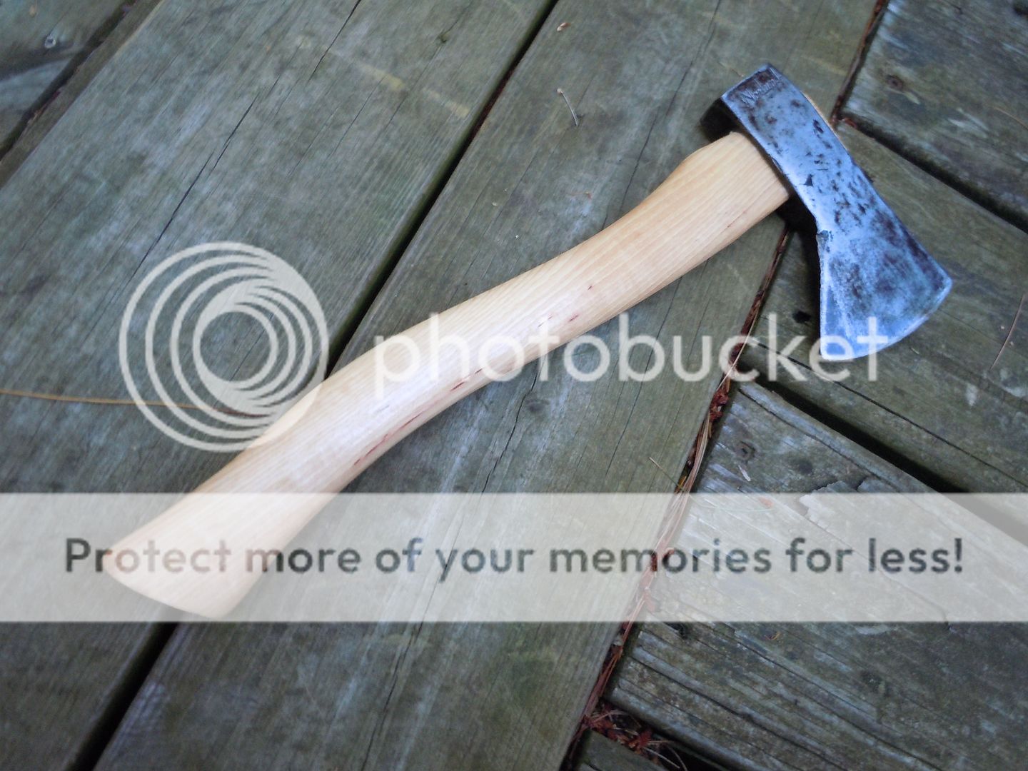

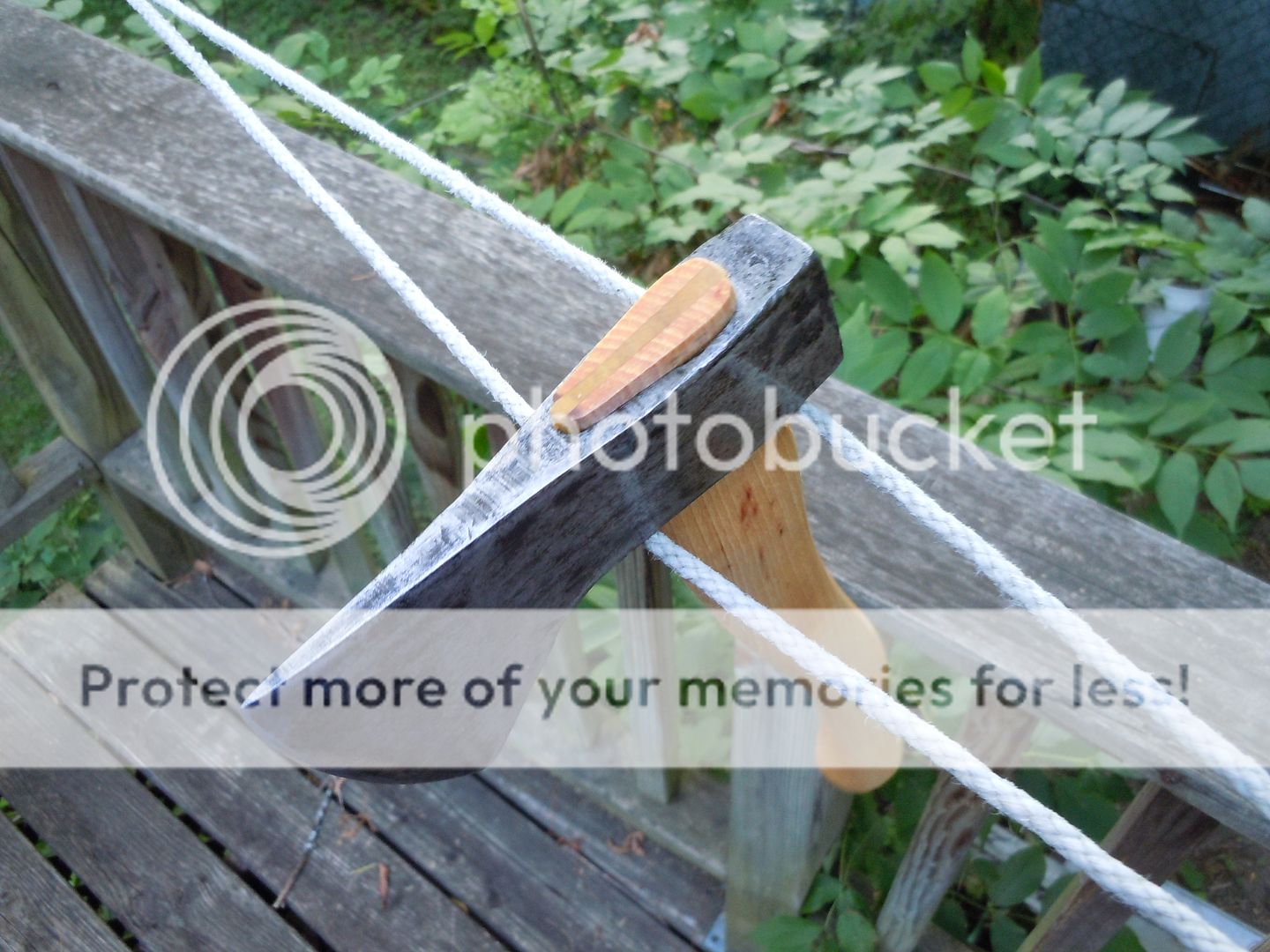

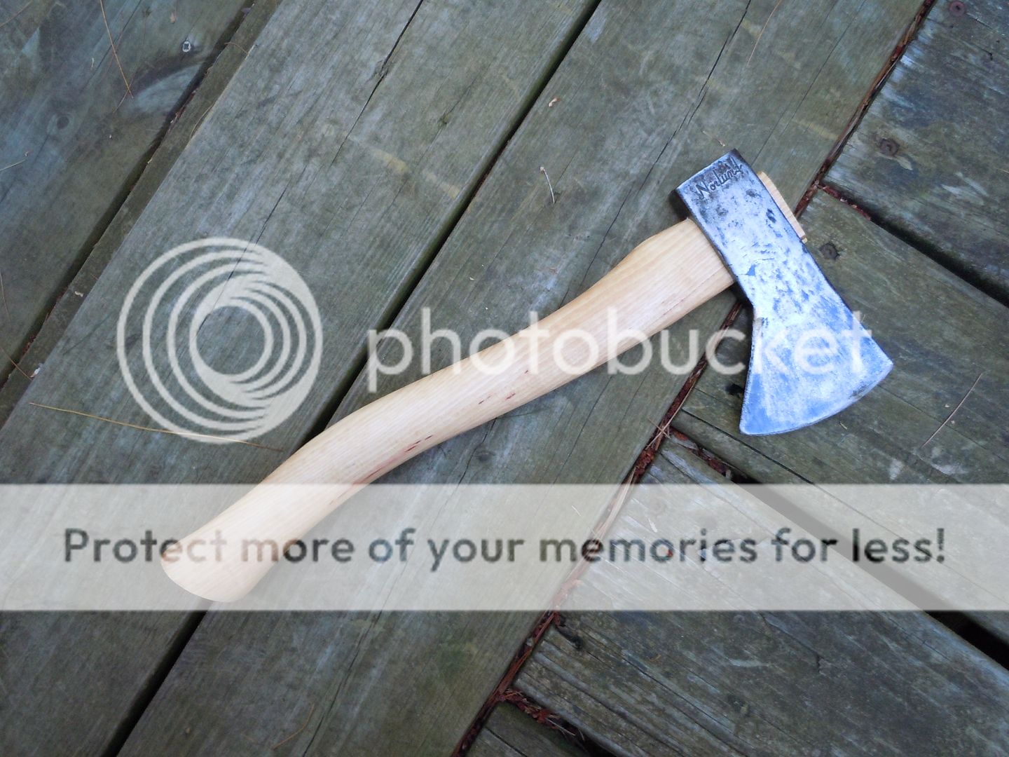

The new alignment
Hung out to dry
Nice work. The alignment looks perfect. Do you put metal wedges in or is it unnecessary?
If you haft an axe correctly, metal wedges are not needed. Makes no sense to haft an axe, then drive a steel wedge splitting the grain.

Nice work. I've been wanting to find a Norlund hatchet head like this one but have had no luck so far. That handle is made by link and Ace Hardware sells them in their stores but not on their website. I have used two of them and they have been very good. No issues.

the original genuine Norlund handle is smaller with a pronounced pommel, is this correct?.

maybe its just me because im new to this craft,but shouldnt the grain run from blade to poll instead of cheek to cheek? someone please let me know:D
The whole grain splitting issue with a metal wedge is more prevalent in the hatchets or smaller axes, obviously due to the shortened amount of wood from top of the eye down into the shoulder. Doesnt take much. Remember, wood is wood, not steel.
I myself dispise of metal wedges. I hate taking them out of my refurbs. I hate putting them in, then the haft splits.
I believe it was Skog that said it on here and the guy from an Ax to Grind also said it - if you hang it right, there is no need for a metal wedge.
That doesnt mean that they cant work as intended - i have a couple axes that have them and are ok. Is it for everyone and every axe? I dont think so. But again, I am one man.
