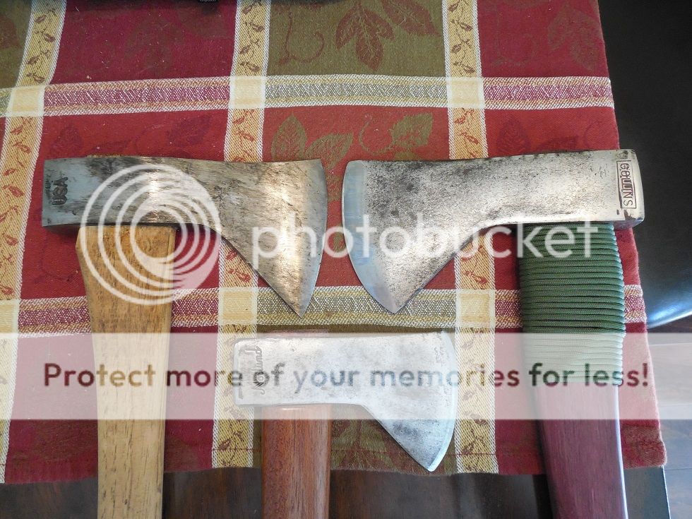

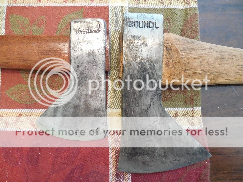

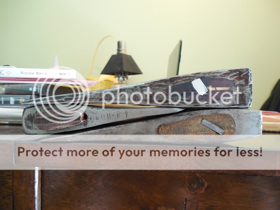

Here's some comparison pictures. The Collins and Norlund are on my handles and the Council is on it's original. (BTW I'm gonna make a new handle for the Norlund so if anybody has a nice pic of one on it's original profile haft post it up!) Council took some pains with the eye to give a a strong mechanical bond, including a ribbed eye that is a bit larger than other HB patterns I've seen. Mine has not shown any sign of loosening after some solid use.

@Alocksly, good to know about the precautions that Council took with the eye. l notice that the council HB has less of a curved edge. This seems more practical--as more metal meets wood. So far I think I'm gonna bail on the idea of a Collins or a Norlund. I saw a really cool large hudson bay Collins Legitimus on the auction site yesterday, but I think I'm gonna forget about it, I don't have the money to get a bunch of different axes that are same models so I'm just trying to acquire a model from of every kind. You got a very cool collection!

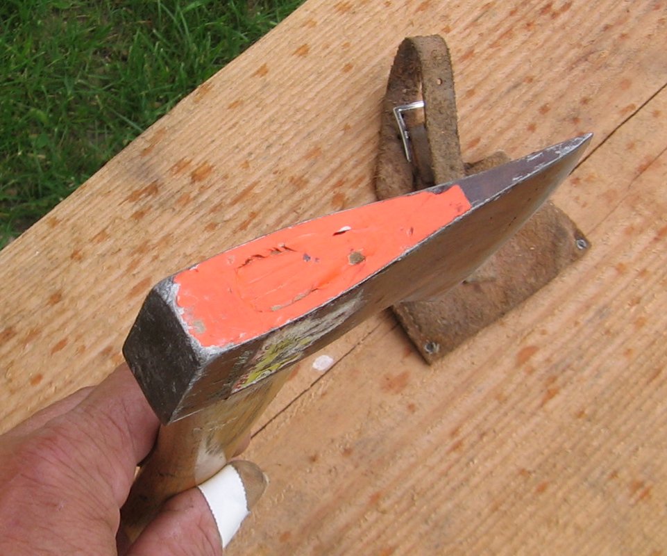

Here you go, Russ. This is a shorty.
And the lovely orange paint on the top of the eye is also factory - in case you really want it to look original.
