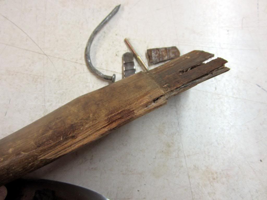

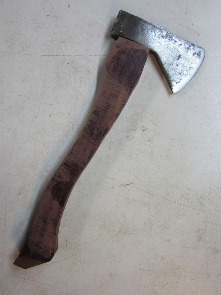

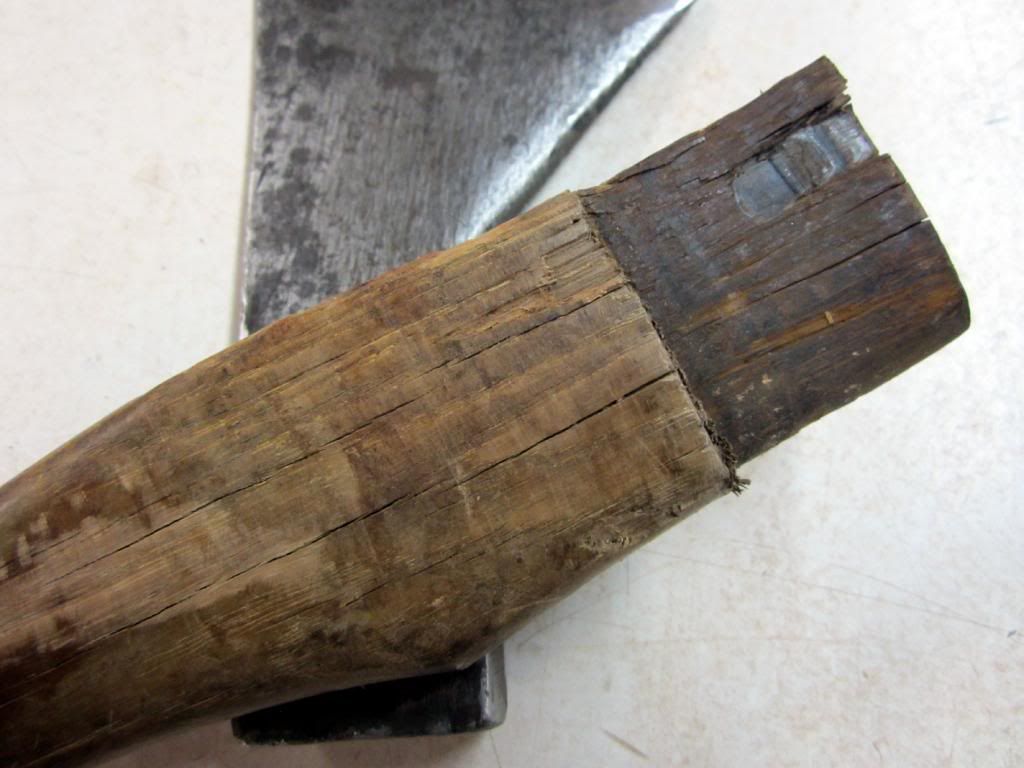

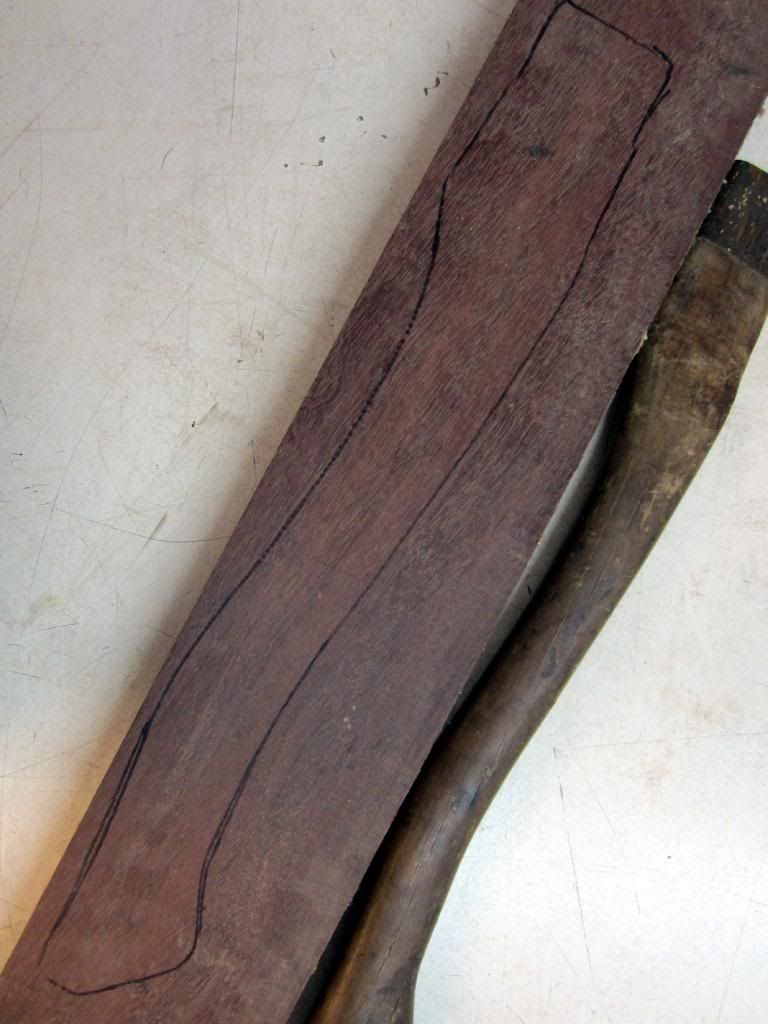

Bringing this Norlund from the "It followed me home" thread.

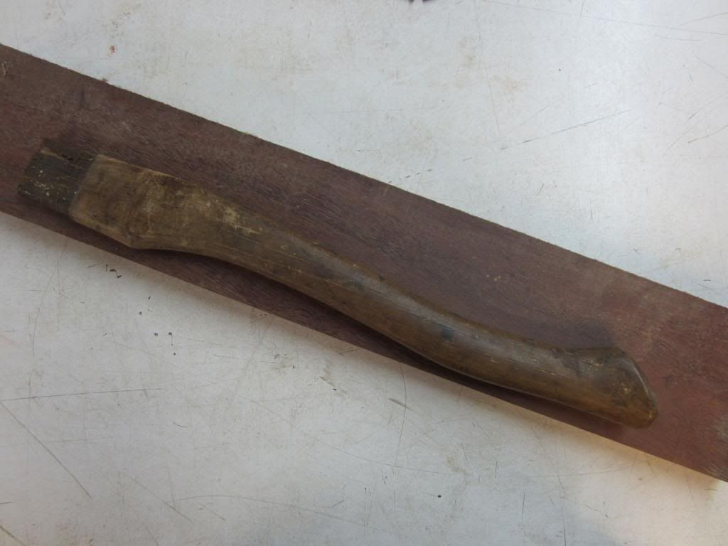

I removed the haft. I didn't like what I found. I am pretty sure its not the original haft anyway.
I located a hunk of nice looking purpleheart that looked like it would work nicely for a haft.
Why purple heart you might ask? Well, because I have it and I think it will look cool with this pattern.
Besides, if I don't like it when its done I can make a new one out of something else.
Anyway, I cut it out with the bandsaw and belt sander and rough fit the haft blank to the head.
Until next time...

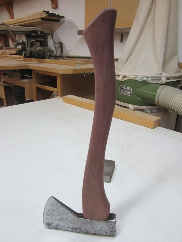

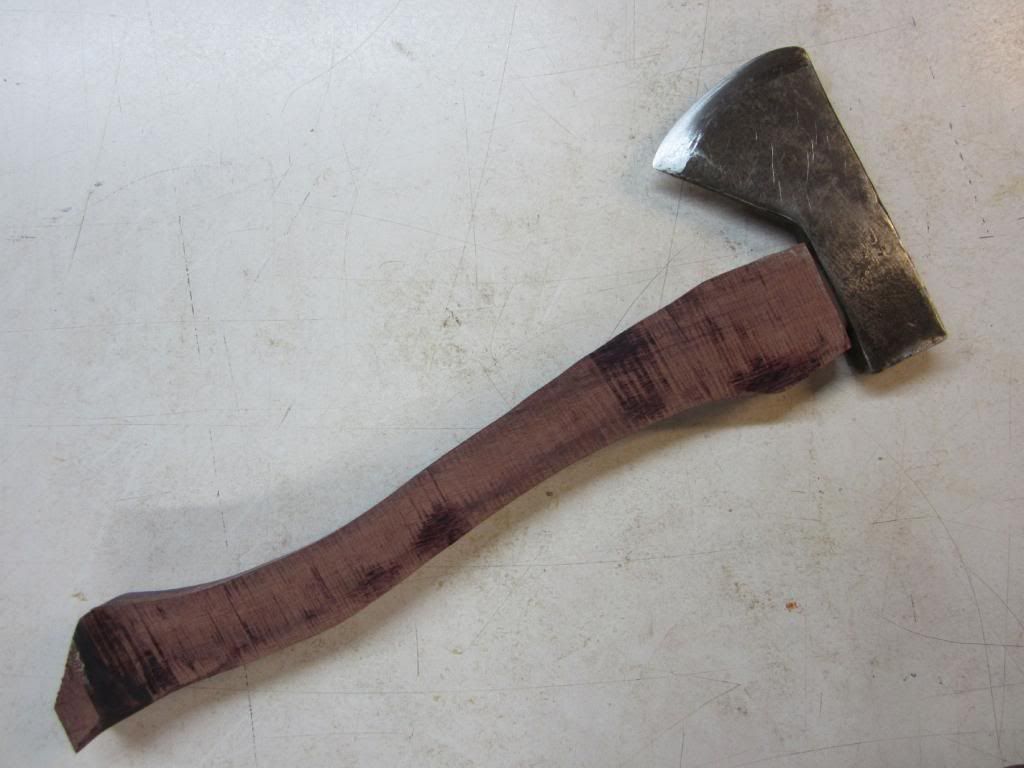

Figured I should get going on this one.
My woman snuck up on me and got this action photo of me shaping this haft. Here I am putting the final touches on it with the cabinet scraper before sanding.
I have a feeling a vise would make life so much easier.

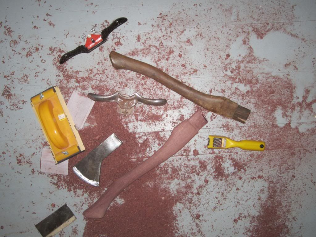

Implements of destruction and the finished haft. Well, mostly finished anyway. Still need to fit it properly and then I can hang it.
Don't worry Pegs I have plans for the old haft. It will get used.
it's looking great, but you need a vise and a workbench in the worst way!

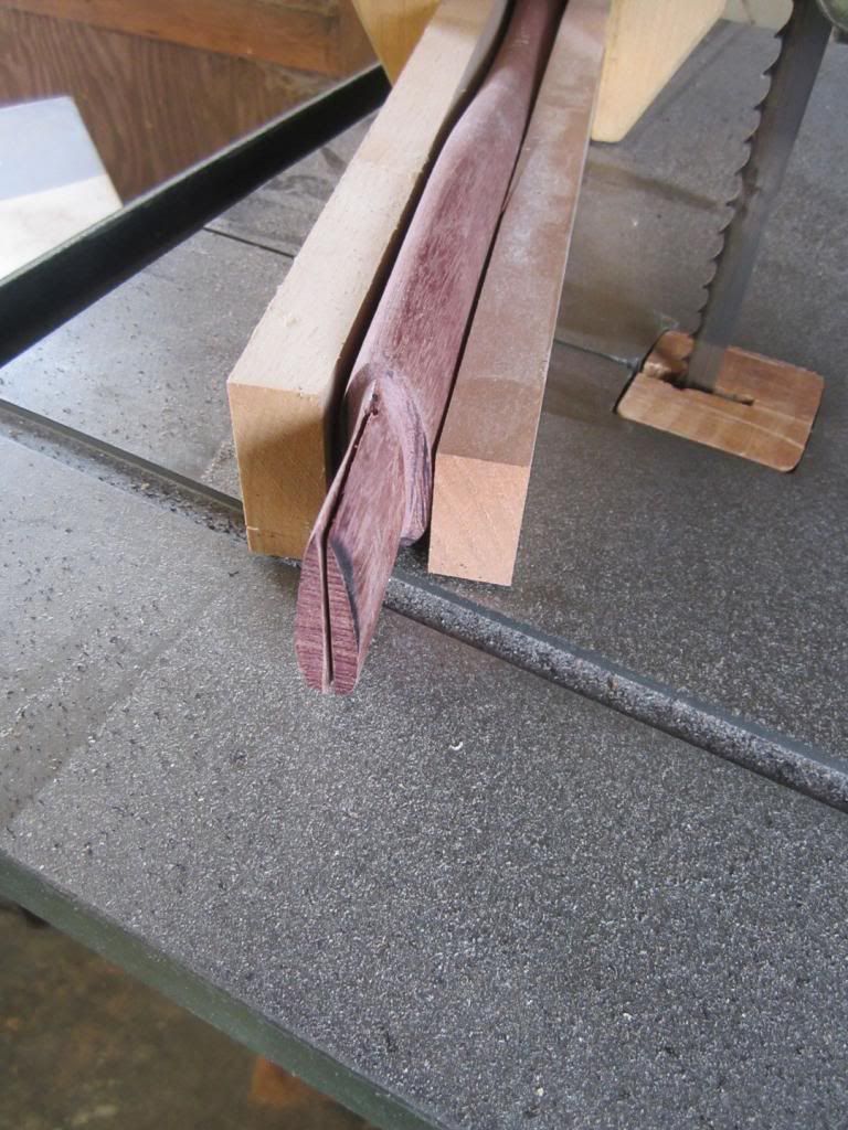

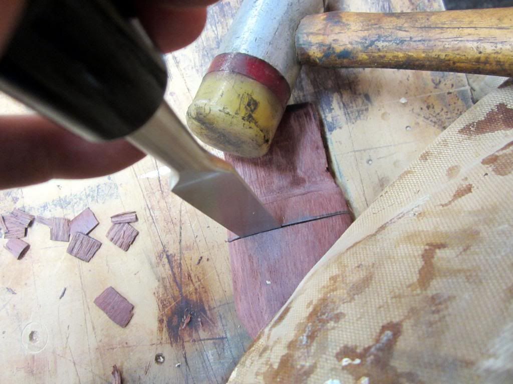

I clamped a couple boards to the haft to hold it stable and square to the table. Used the drill press to drill a hole where I wanted the kerf to end. Then I cut the kerf with the bandsaw. This really made the kerf work much easier than trying to hold the haft by hand.

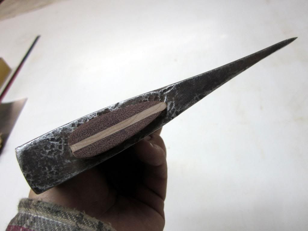

Next I needed to fine tune the fit of the haft to the eye. Pretty straight forward.

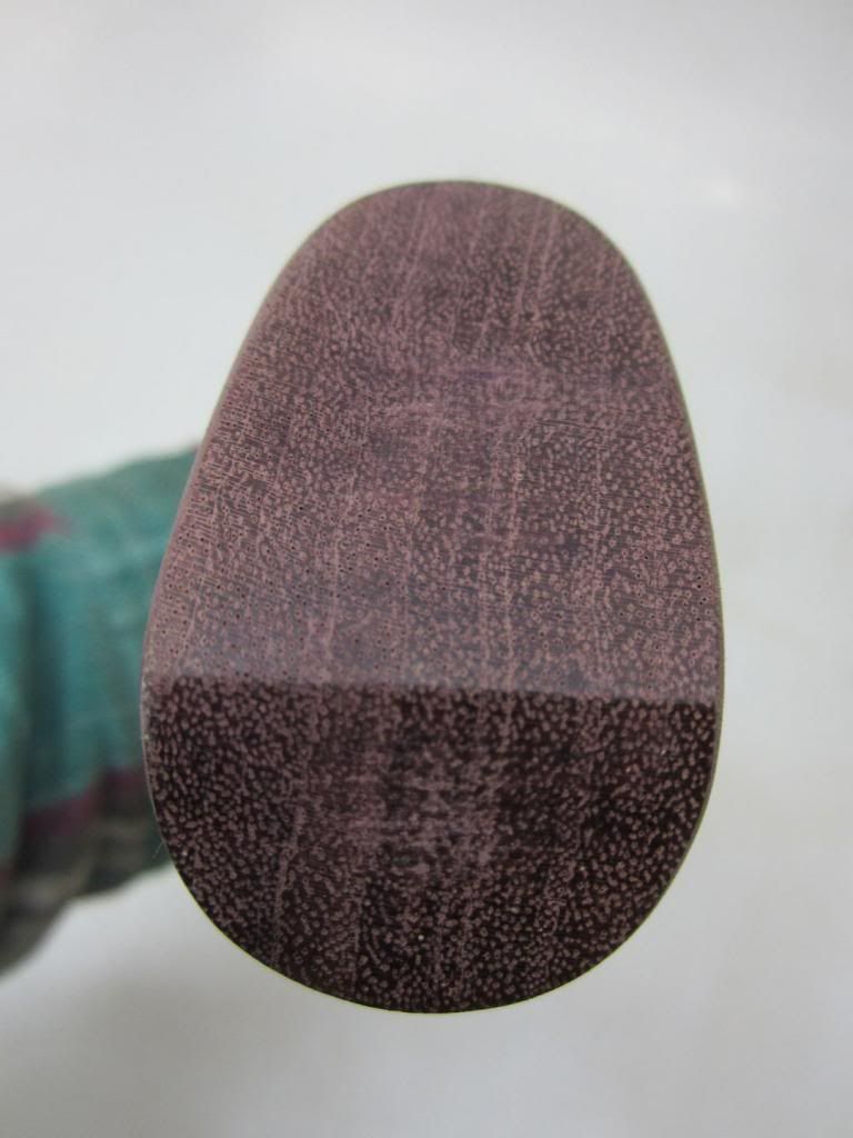

Wedged it with hard rock maple.
I like being able to choose the grain orientation

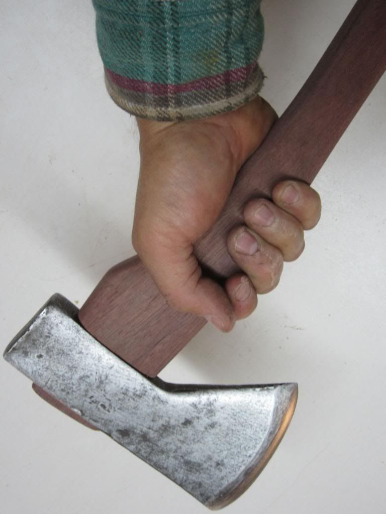

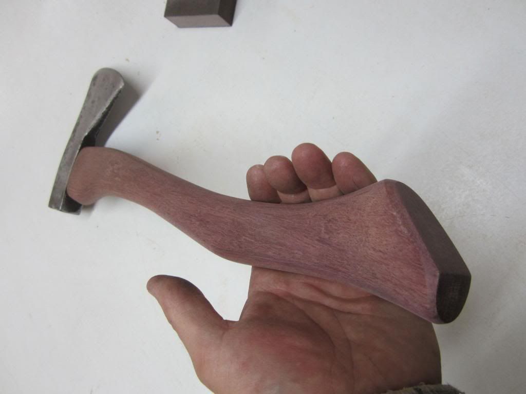

Looks accetable.
Feels good.

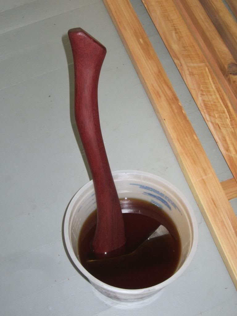

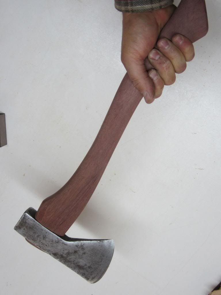

She is done.
And ready for a bath.
Not sure what I will use her for. Took a few swings after I hung it and she chops quite nice, clean deep cuts.
I am pleased with her so far. Will post up more pics when her finish is done.

Do you find the purple heart to be noticeably heavier than a traditional hickory handle?
I thought it would be heavier since the chunks of purpleheart seemed to be noticeably heavier than the hard rock maple of similar size. Once I got all the fat shaved off though it didn't seem akwardly heavy or anything. In fact, I completely forgot that weight had been one of my concerns. I didn't really compare the weights of the finished haft with the old hikory one but since I always had the hickory one around while shaping the new one I am thinking they weigh pretty similar.
It feels good and the balance point is about in line with the heel of the bit.
