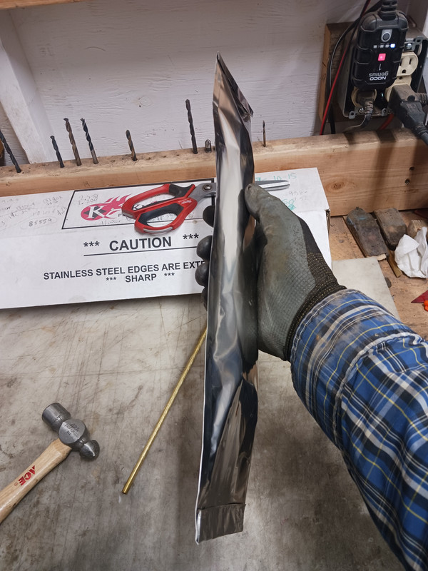

I have a forged out blade that I am going to normalize in my kiln (15n20+1084 billet), usually when normalizing I’ll either just leave it thick and grind through the decarb or use some of the anti-scale clay. I’m wondering if I could use my heat treat foil instead of the clay for my normalizing cycles, as I’m not the biggest fan of the clay.
Obviously it’s “overkill” to use a foil packet here, but I have plenty of foil and a lot of hate for decarb and scale… so is this an option?
Or would there be an issue with the cooling rate having the packet acting as an insulator?
Apologies if this has been asked before, but I couldn’t find anything on it.
No issues....I leave my blades wrapped in the foil through austentize and temper. I'm sure your steel will not be affected by using the foil for temper...except maybe a bit cleaner :)

I did a 52100 batch last month with a normalizing and DET anneal. 12 blanks all wrapped in one big foil packet.
Just to reiterate what Stacy said, decarb and scale are not the same thing. Scale will come off with a vinegar soak, but decarb is actually a surface layer of carbon robbed steel. The only way to get rid of decarb is to either stop it in the first place (SS foil works excellent for this, and coatings like ATP-641) or grind it off afterwards. When removing decarb by grinding, the most important part of the knife that needs attention is the actual edge. The sides/bevels/flats/spine should all be ground a bit if decarb was a problem during heat treat, but the edge is the most important part.

I use 321 foil packets for normalizing/annealing/DET annealing carbon blades. I make a pouch, put all the blades in it, seal it and leave them in throughout those processes. When I am ready to austentize, I use ATP641 on the blades. I found out the hard way that 80CRV2 decarbs a LOT during a normalizing/thermocycling and DET anneal. Went from .135" thick to .090" to get the decarb removed fully! My kiln was super slow to rebound, so they were in a lot longer. The new HT oven should be better!
I have tried the graphite spray stuff and it helps if just doing austentizing and no other cycling, but I started cycling my steel regardless of forging/stock removal to get consistent results.
