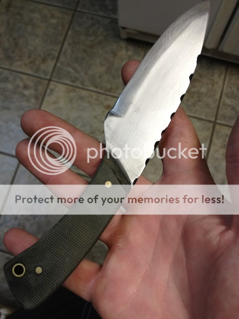

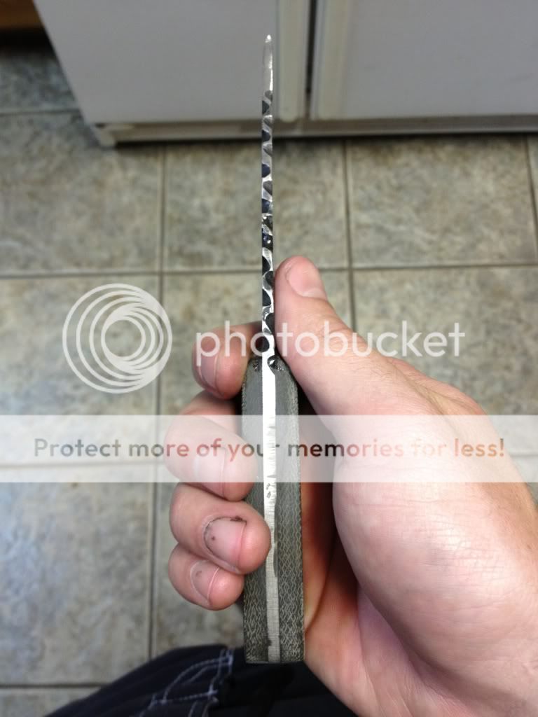

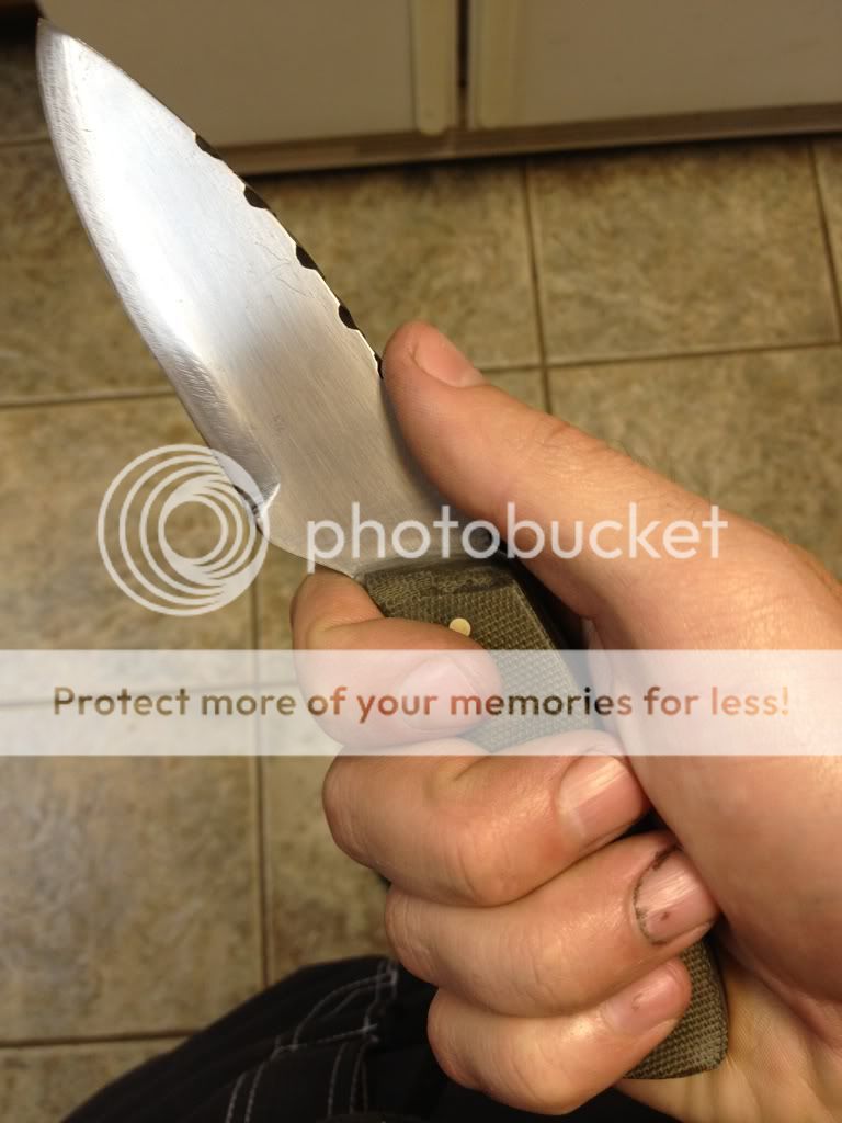

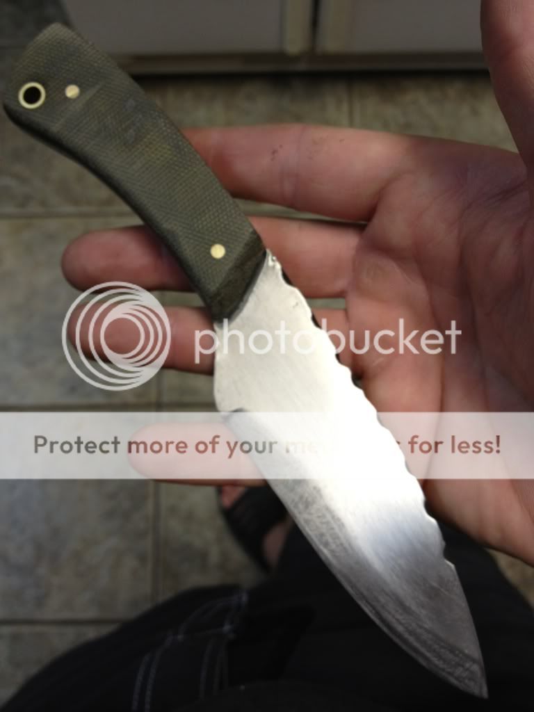

I keep reading about these guys that are normalizing 3 times and such and getting completely lost. Hope this is clear and sorry for the rambling. Just finished my first knife. It's 1/8" O1 with olive drab canvas based Micarta. I HT and tempered myself (most probably wrong)
Ray Rogers over at Knifenetwork gave me some great advice already and advised me not to use O1 until i become more experienced. It's not the greatest work of art but I guess it could kill a tree branch.
the only reason I did file work was to give my thumb some grip.

Third, nice first attempt. Be sure to clean up the epoxy at the front of the scales with an acetone soaked q-tip while setting and be sure to get all of those scratches out before you go to the next grit and def before you HT. They are very hard to get out after the blade is hardened.

Thanks Wloch. I appreciate the info. Yea the only grit paper I had on hand was up to 600 so I could only go so far as I had put a whole lot of scratches stupidly trying to draw file. And I see what you mean about the epoxy. It dried before I saw it.
As for HT. I have a very crudely built kiln/forge. Bricks and pipe with a burner from a crawfish pot essentially(I'm from Louisiana). I heated the steel until it became non magnetic and let it sit a few seconds longer. I then quenched in oil. After cleaning it up I tempered twice at 400 degrees for an hour each.
