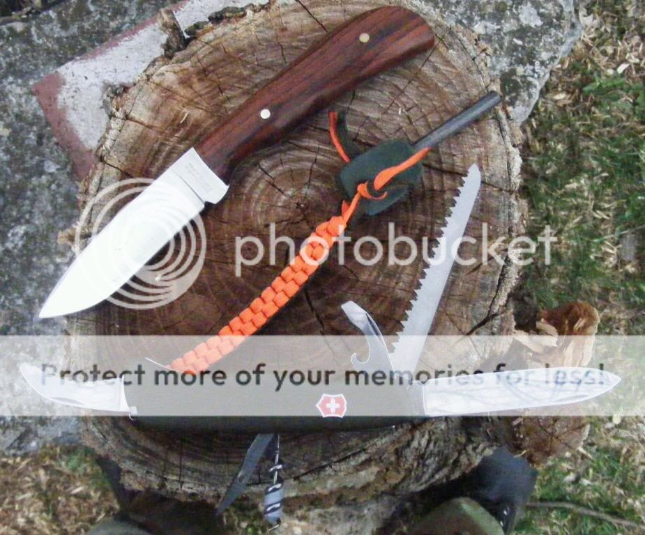

The Gladstone is the last knife in this photo...
And here it is with a Victorinox Hunter...
