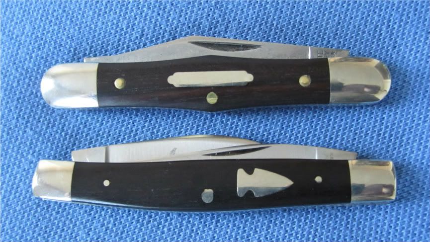

The mail lady dropped off a package today with the Northwoods Mini Moose I recently ordered. This one has nice black Ebony scales. Its 3 1/4" closed with a 2 1/4" clip and 2 1/8" wharncliffe blade. The blades are ATS-34 and share a single backspring. The pull is about a 3-4 on the clip and a 4 on the wharncliffe. Nice walk and talk on both blades, no half stops. Both blades are a little shy closed but flush open. They were convexed by Bark River and came extremely sharp.

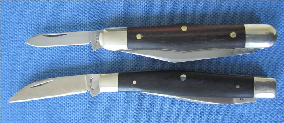

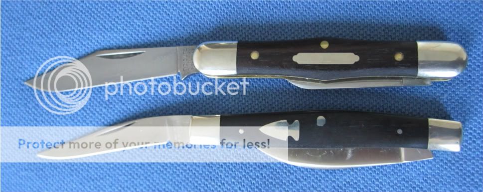

2 small things I've noticed. I feel the wharncliffe rides a little high... There is plenty of room to lower it as the tip rides just below the liner. Actually, both tips sit just below the liner which is part of the second thing. When opening one of the blades, it raises the other blade a bit exposing the tip. I haven't caught myself yet and it probably won't be an issue.
I plan to carry this one exclusively for the next few weeks and give it a thorough tryout. Right now I see it completing most against my Queen small stockman. I'm not sure if Queen made this one but it looks close to me.

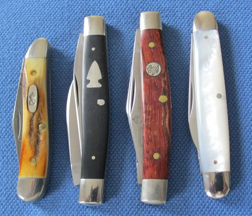

A couple comparison pics with Case Peanut, Northwoods Mini Moose, Queen Small Stockman, Queen Senator.
