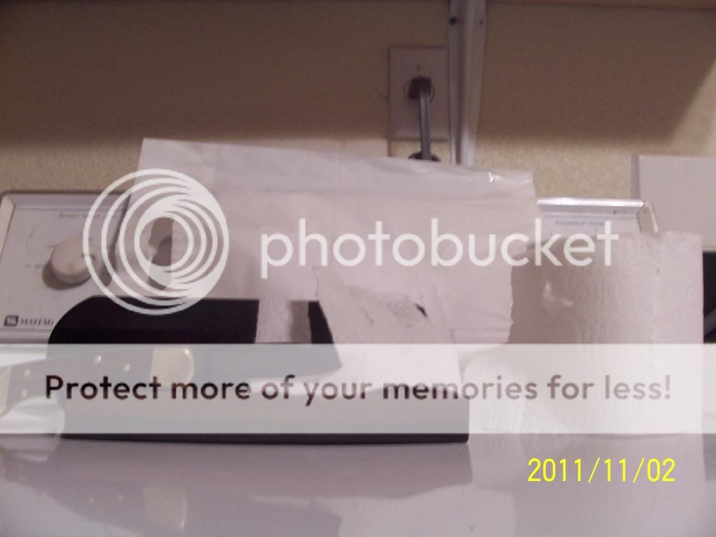

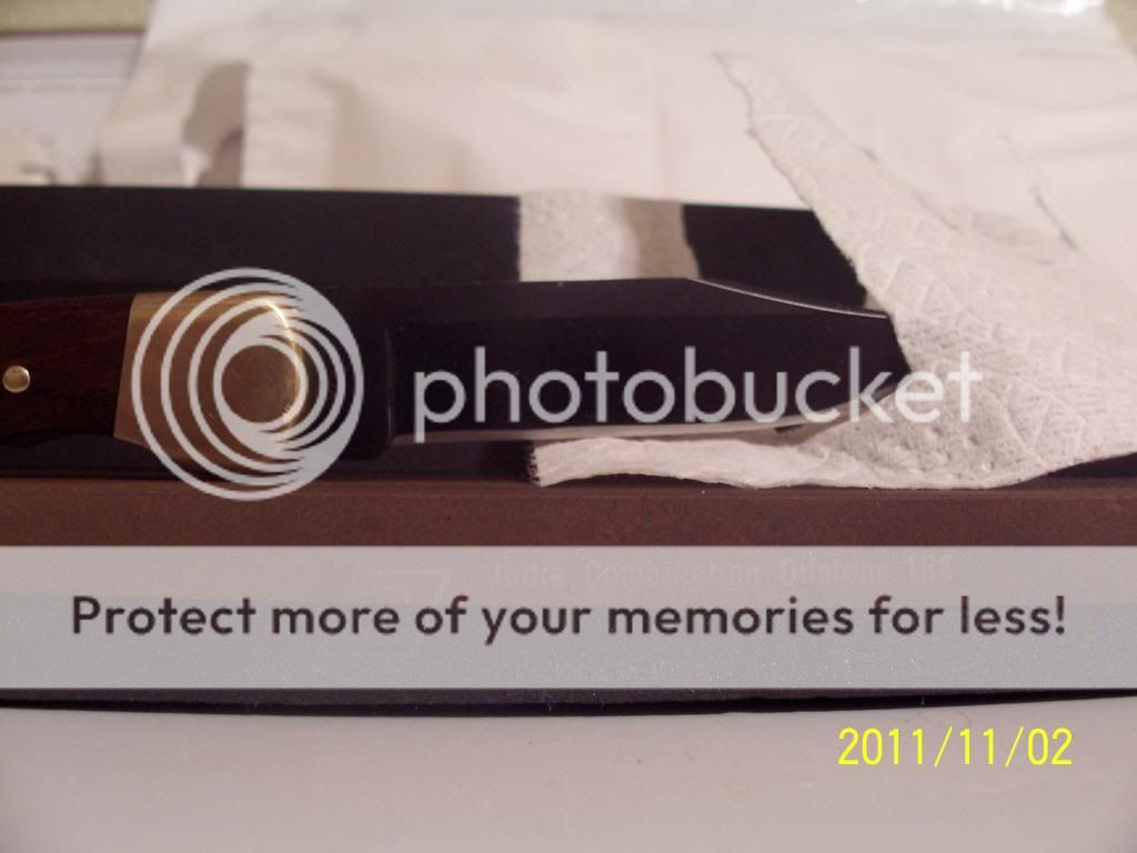

Whoa, thats very good, push cutting bathroom tissue coming off a 280 grit SiC stone. Did he strop it much before the test? Yes, the India stones do get finer with use, perhaps to 350 then with some stropping and your at 400 on the edge. Which will push cut newspaper in any direction, over come wrinkles and shave every arm hair it touches all with very few burrs left. DM
HH, inspired me with his post above about push cutting bathroom tissue with a blade coming off a 280 grit SiC. Well,this is a photo of a blade push cutting bathroom tissue coming off Norton's IB8 India stone. DM
Just a larger photo showing more area. So, a great edge can be obtained from these stones. DM
