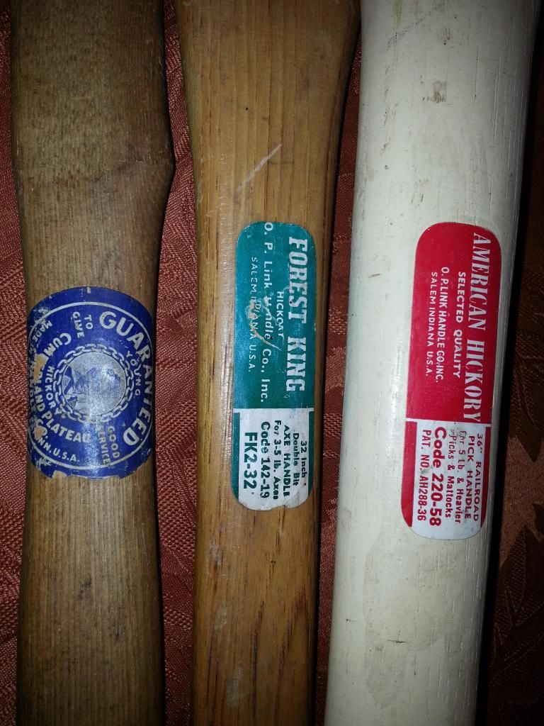

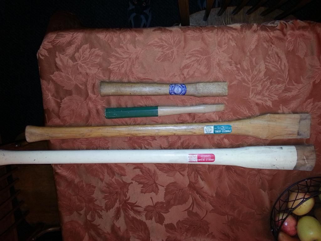

I have many NOS handles, mostly nondescript hardware store stuff but usefull just the same. Nice but not noteworthy. These four are the nicer ones either due to quality of design or condition. The hatchet handle has a rare label but other than that is just a nice handle, the pained hammer handle is cool because it is octagonal, and the mattock handle due to it;s nice original condition. However, the double bit handle is the real winner. It is 32 inches long, the grip is 3/4x1 5/16 inches and the whole thing weighs 18 ounces. Pretty cool. Another design to add to the new custom catalog? ;)
