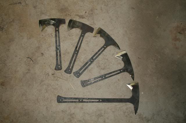

I've finally got the ball rolling on everything and am working on the first batch of tomahawks since getting my new heat treatment furnace set up. I'm first working on taking care of military orders, then will work on the rest in order.
Here's the first batch of five. I plan on working on six at a time in the future, but I wanted to get these finished and to the customers ASAP.
All of them have sharpened inner beards except the second hammer poll from the left. I know some of them are hard to see in the pic. It was taken under fluorescent lights at night in my shop.

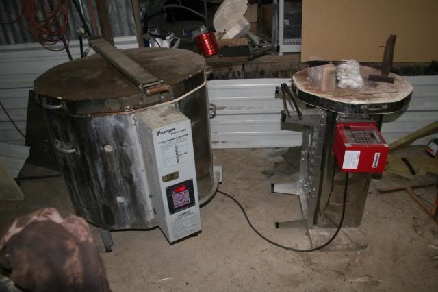

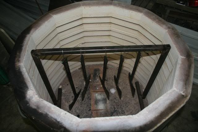

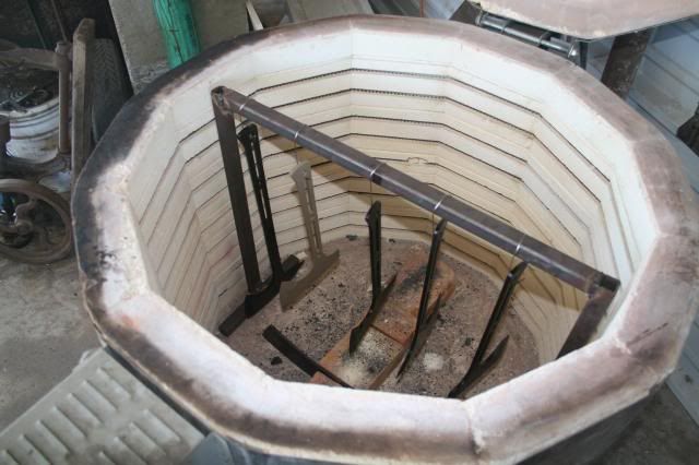

Here they are on the combination tempering/coating baking rack in the big 3 phase kiln that I use for such operations. At this point, they've been normalized, ground, and hardened.
And the two heat treatment devices side-by-side. The new furnace, dedicated to the hardening phase, is on the right. The 3 phase kiln, dedicated to tempering and baking on the finish, is on the left. The first tempering cycle is just starting and the kiln isn't up to temp yet.
The rack I use for normalizing is to the right of the furnace, with only one foot visible. The quench tank is just out of the shot on the right and forward.

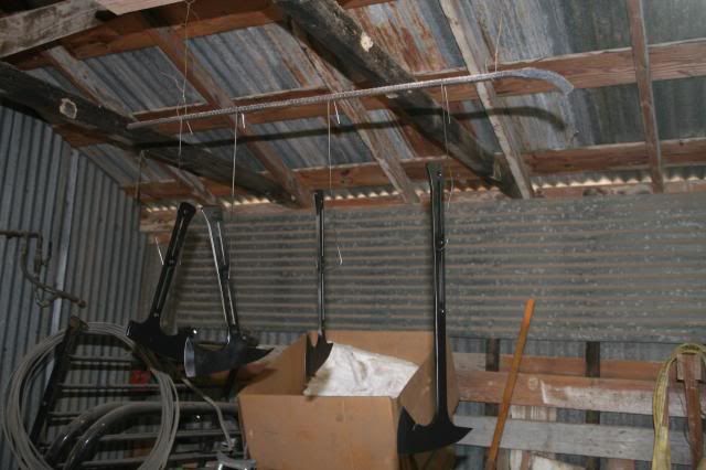

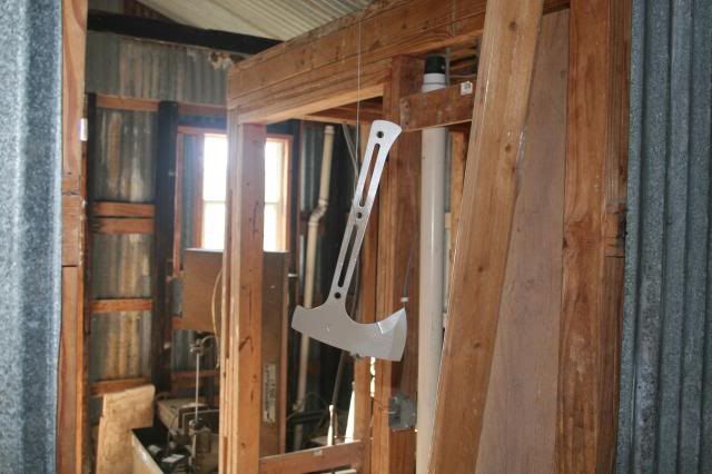

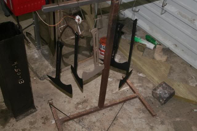

Got this batch Durabaked today.
I need to build a better spraying setup, but I rigged this up as a temporary solution and it did all right.

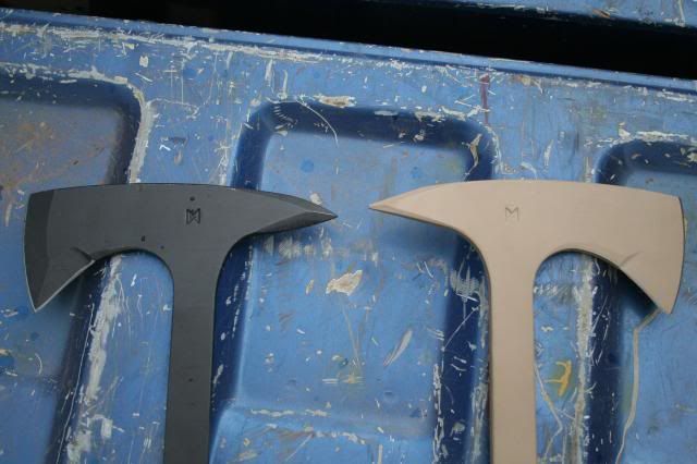

Everyone in this batch wanted black, except one.
About to bake in the kiln.
Cooling off afterwards on the normalizing rack.

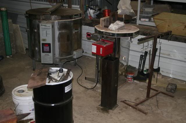

And the whole heat treatment setup. Three phase kiln on the left used for tempering and baking on the finish, Evenheat used for hardening to the right of that, normalizing rack to the right of that, tomahawk quench oil in the black barrel, and canola oil for quenching bush swords in the square tube quench tank.
