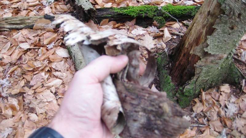

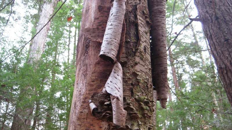

Dead Birch tree. Bark is easily removed and excellent as a 2ndary tinder. You can scrape it up and get it to take a spark as well.
Paper Birch tree

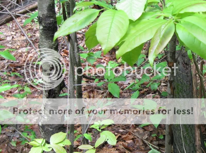

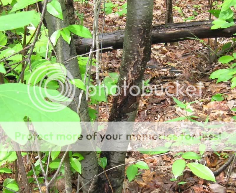

Thanks Tony. Hmmmm..., now this has me thinking a bit. There are a lot of Cherry trees up in the mountains here. A while back I hiked through an area where there were several Cherry trees with some major bark issues. This makes me wonder how that separating bark would work as tinder. I didn't think about it at the time because everything was soaking wet from days of rain. Now after reading this, and hearing that tinder fungus has been found on Cherry trees before, I want to go back and check it out. Maybe their barks have a similar chemical make up.
