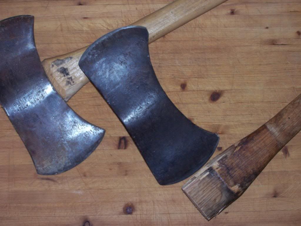

I went to a Habitat for Humanity Restart store and picked up a no name double bit...nearly the same pattern as a True Temper/Kelly Works Flint Edge 3.5 lb'er...pulled the handle because it was loose and it came out in pieces...no good for this axe but have plans for the handle on other projects :)...so if I can ask a couple of fightin' questions with out startin' the fight here goes...( i apologize in advance if they have been asked before in this forum)
1) I know hickory is the preferred stock for a new handle, but what else can be used...this axe will not get the use that say an 1880's logger would put it through..I have some teak, rock maple, oak, walnut and cherry in stock I can use...
2) Wedges...this axe came with both a wooden wedge and this steel wedge...should i plan on using the steel wedge also...or just a wooden wedge...and what material would you make the wood wedge out of...see the above listed woods...(the steel wedge is flat on one side and stepped on the other)
3) A general question...I noticed that when sharpening the axe the steel appeared to be very grainy...with lots of SHARP!!! spurs coming off when using 80 grit belt sander and a very pronounced burr, and filing very quickly with a bastard file...but smoothing quite well when a stone was put to it...is this a steel that has any quality or just a wall hanger?
Tar
From the photos, the steel looks ok. It's hard to tell if you have a hardened bit. Hard spots in the bit can indicate work hardening from impacts with rock or other hard surfaces. You should be able to tell if you have a hardened bit by filing near the eye and comparing the hardness to the bit steel.

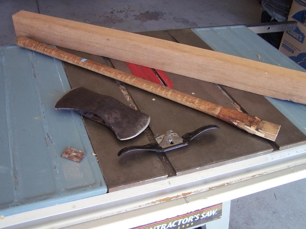

So I got up this morning had a cup of coffee and started to make a handle for the no name double bit...started with a 30 year old piece of South American Teak that was sitting around a buddy's shop for 20 years before I got it 10 years ago...I've been waiting for a suitable project for this piece of lumber....it started out 2 1/8" x 3" x 46" with some checking evident, but nothing looked too hazardous...considering it's illegal to chop old growth redwoods in my area :) this won't see any hard use...

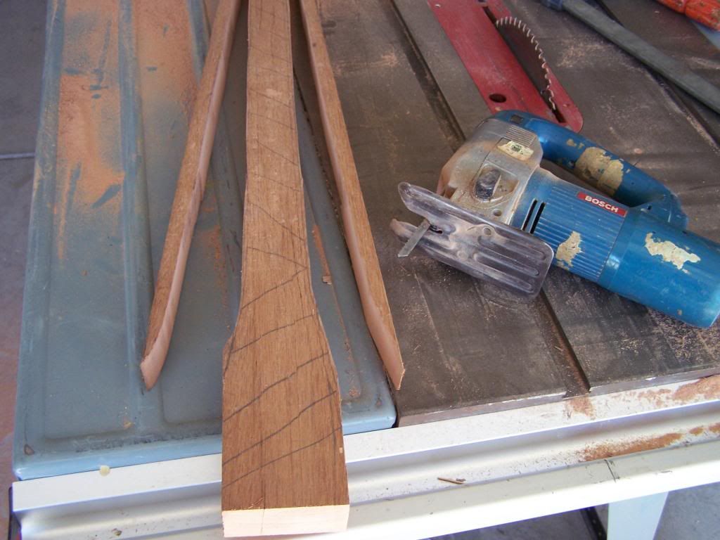

Cut it down to size using a table saw and jig saw...don't mind old school...but I'm too old for hewing ALL of it by hand...

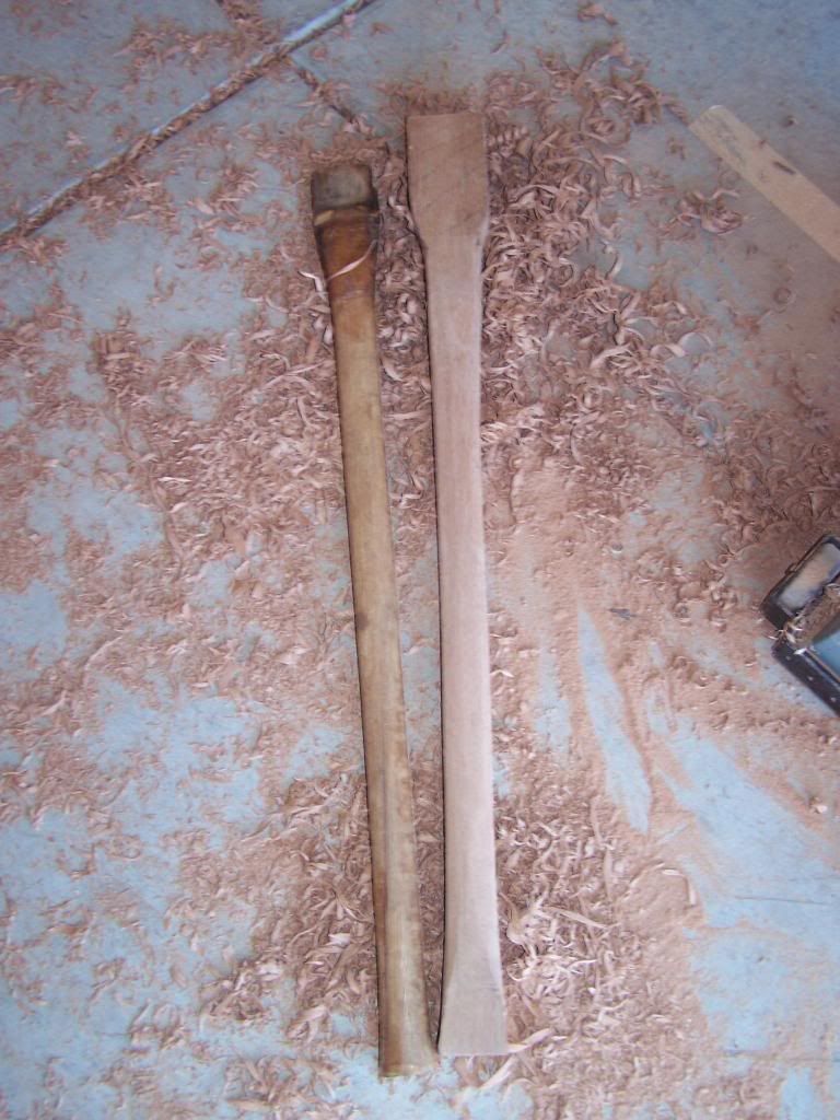

Got out the spokeshave and block plane to rough it out... 1 1/2 hours later...half way there...I was truely amazed at how easily the old wood cut and shaped...love the smell of teak sawdust...:D

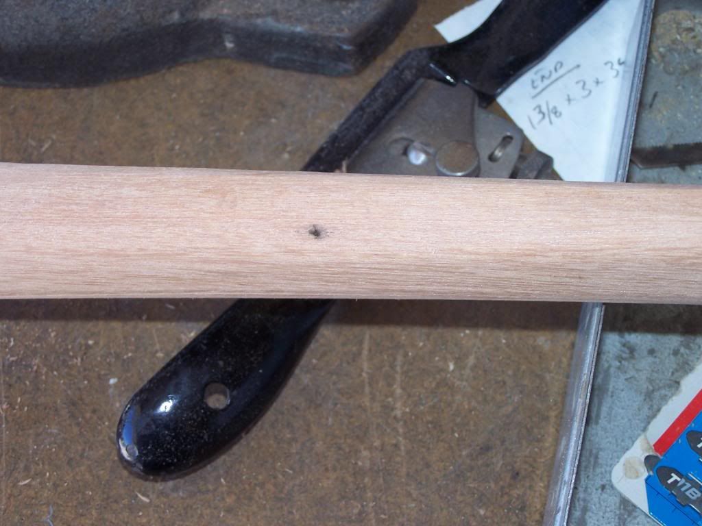

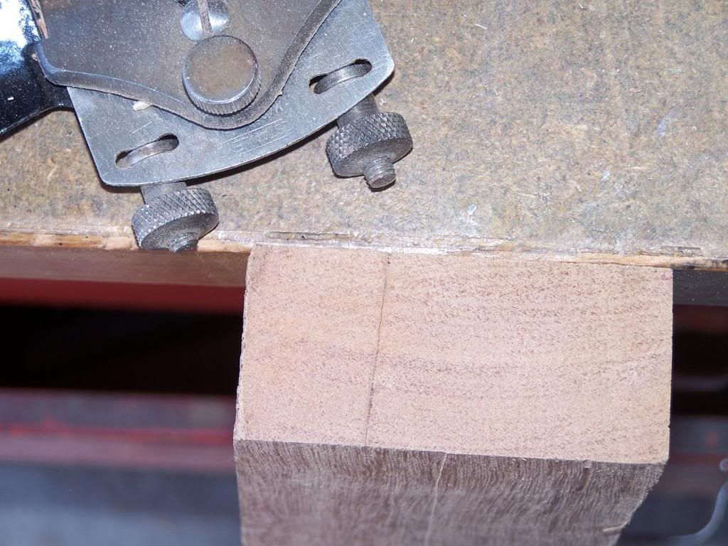

But as the handle is starting to take shape two flaws became readily apparent...one nail hole in the middle of the handle and a deep check in what will be the tenon (?) of the handle...the end that goes into the eye of the head...but as I said in the beginning this won't be a heavily used axe...more of a beginning lesson in handle making...
have a football game to go to so will take it back up tomorrow....
I don't think that the nail hole or the little check will make any difference. Great project. Keep us updated.
