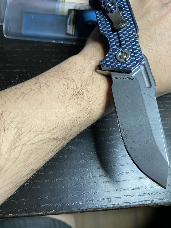

I used to mirror finish all my edges and wouldn't go out unless I had at least one knife on me that was hair whittling. Done with that now.
Now to answer the question of whether it's easier or harder to get it back sharp. When I rebeveled for mirror finish, I usually thinned out the edge to at most a 15 dps angle and sometimes thinner. It's much easier to touch it back up with a micro bevel but with a caveat. It depends on the skill of the person touching up. I've seen a people who could get a knife back to hair whittling within a few minutes and people who spent over an hour and just dulled a knife. Of course if it's pretty dull, the skill of the sharpener becomes even more crucial.

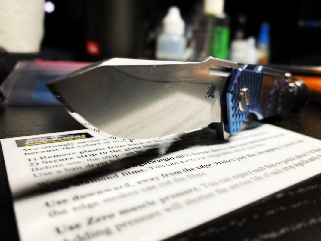

I would say yes. I mirror edge my knives with diamond lapping films down to 0.5 microns. That puts a really fine edge without any toothiness. Once you touch up said edge on a Sharpmaker, you reintroduced toothiness on the edge again unless you stropped with CBN emulsions.
