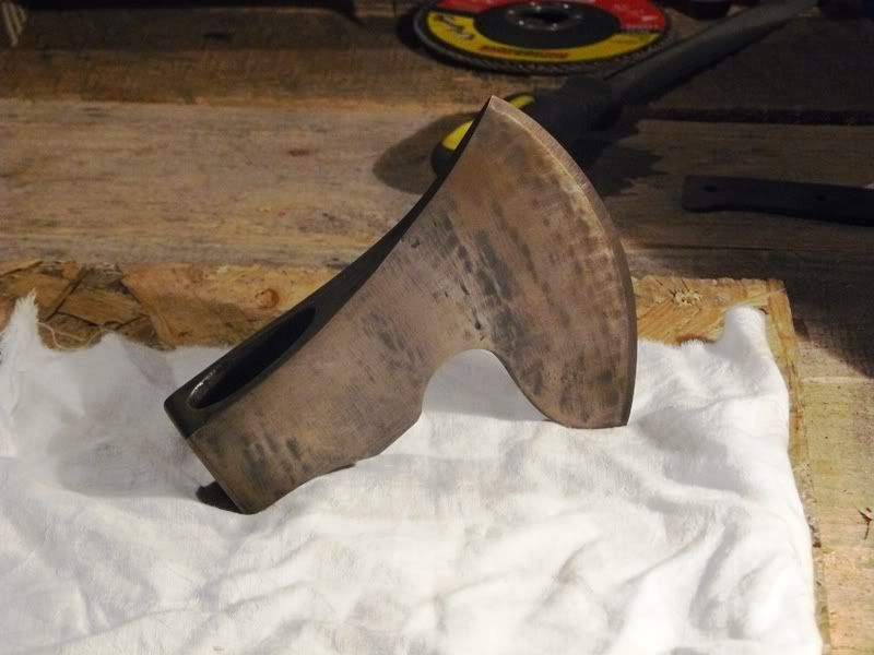

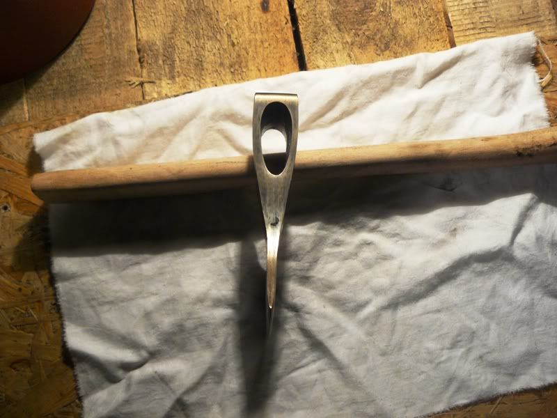

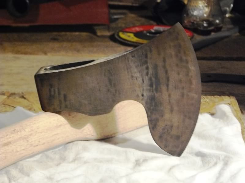

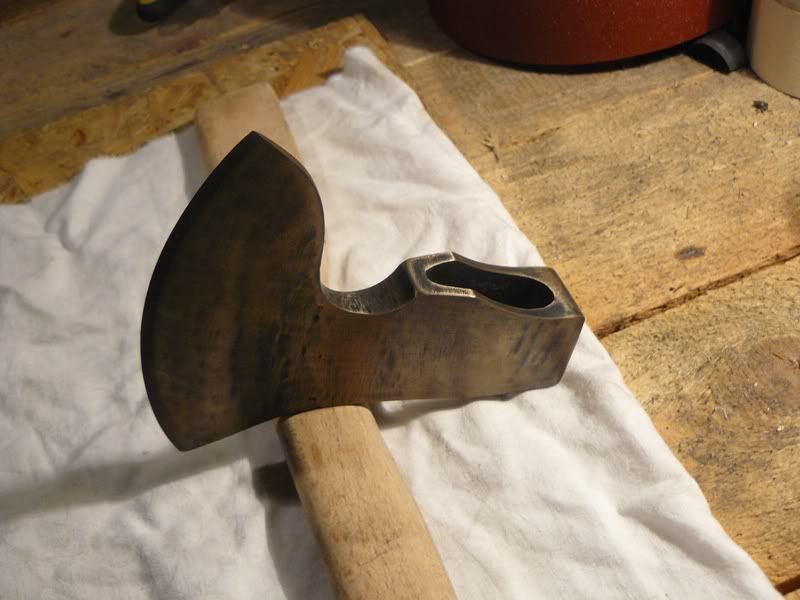

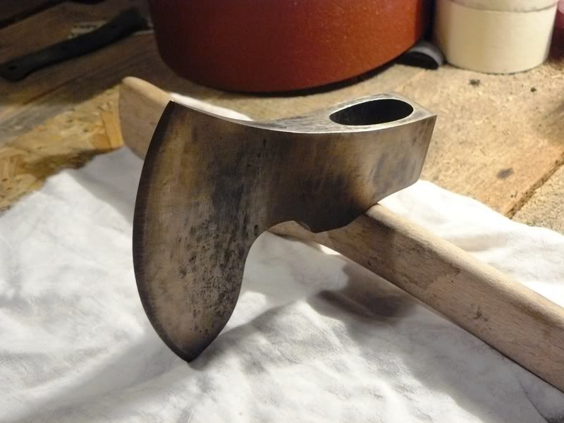

My new project
Well, just the head for now!
For the handle I will use ash wood!
More pictures soon.
Thanks for watching!
That is a very nice looking head....Looking forward to seeing more pic's
That's absolutely beautiful. What are the dimensions and weight? Will it have specific use or is it a general purpose axe?
Is a bit of scandinavian, romanian etc. and is the first of two medium outdoor/all around axes for two brothers!
Cutting edge around 6 inch and the weight is around 1.3 pounds.
I love that axe Leaon, very very nice. Can't wait to see it finished.

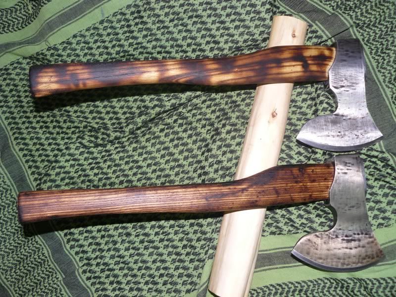

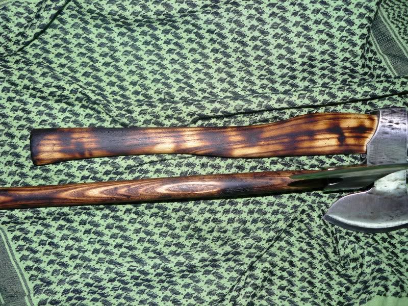

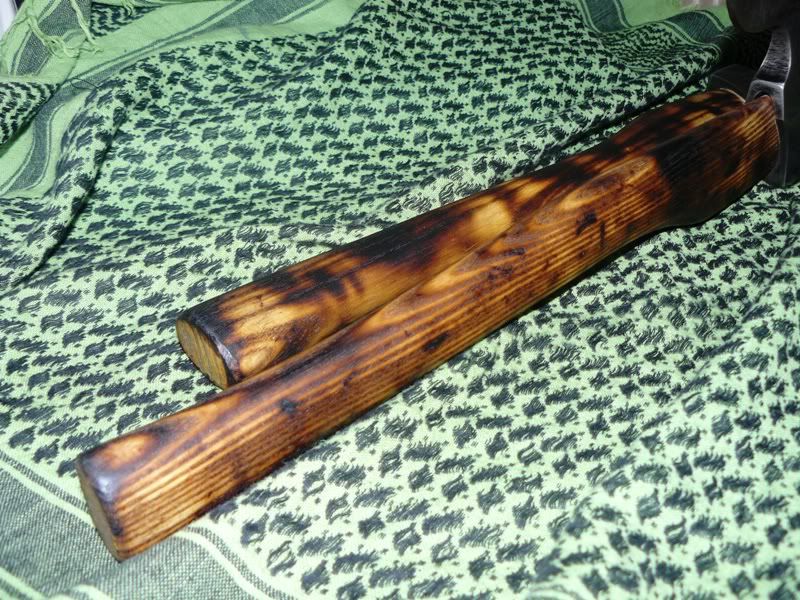

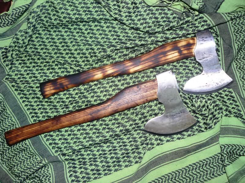

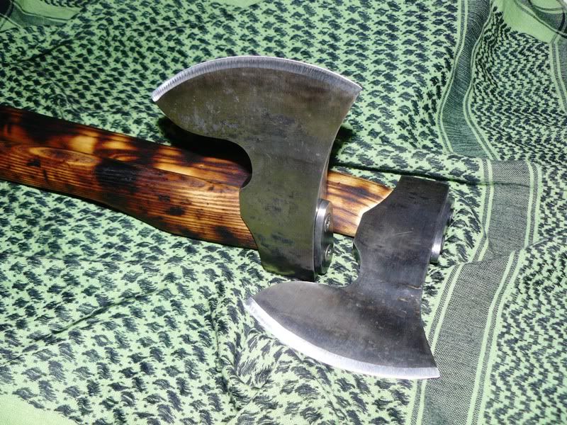

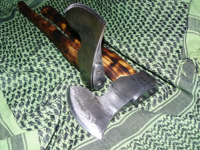

That`s all folks, two almoust identical bearded axes, handle burned in forge, linseed oil treatement and pictures (as I promised)
Thanks for watching!:)
Awesome Leon! Thanks for the pics, that's some good axe porn right there. Show us your future projects if you've got time.
Those are so nice, wish you lived closer. Thanks for the pictures Leon.
Best regards
Robin
Thank you all for your kind words and appreciation.
It seems that the owner appreciates them and wants another two, so I come back soon with news!
Have a nice Sunday!:)
Thanks, the eyes are taken from droped forged low carbon axes. The blades are 1095 carbon steel forged by me and electric welded on those eyes. After this I grind the weld and finish the general design of the axe and temper only the blade. In the end I normalize the head for 1 1/2 - 2 hours at 482 F (250 C). I must obtain a dark brown color (so the blade will not chip, but will keep a good edge).
Next time I will try to make a WIP on this procedure.
