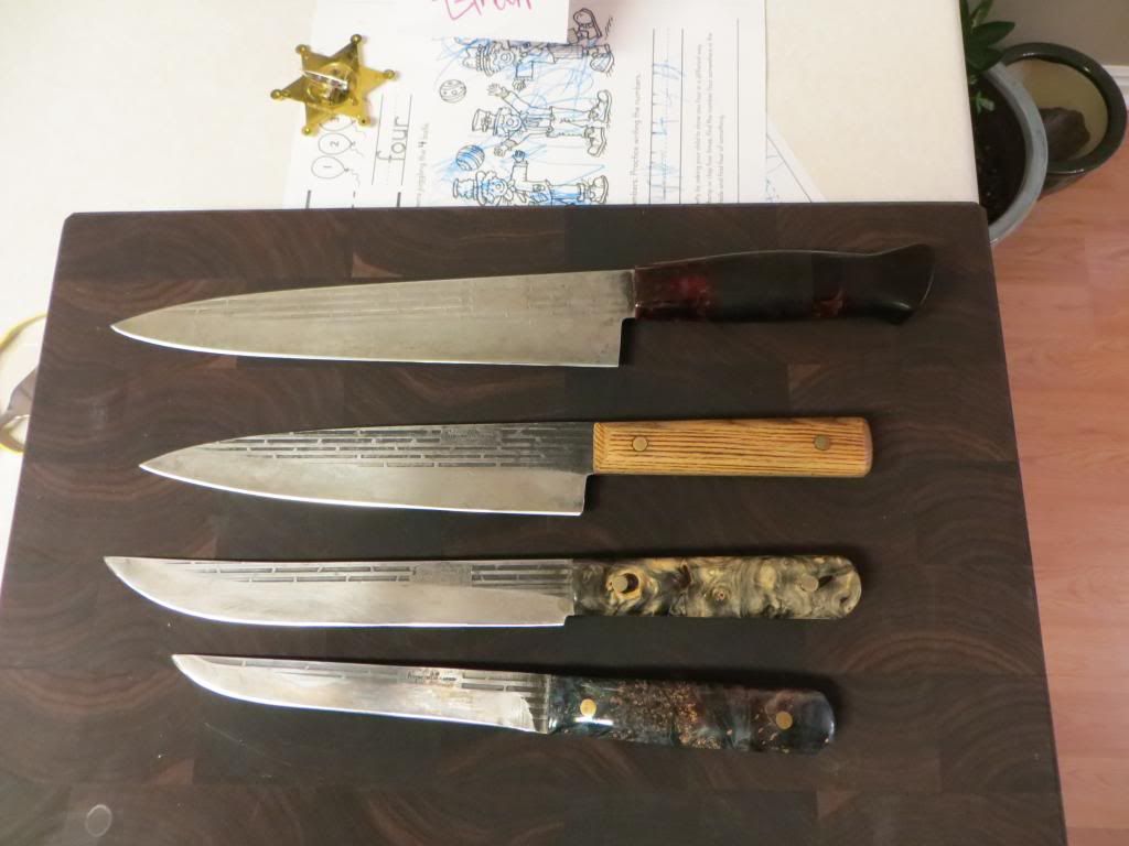

Here is a pic of my daily use Forgecrafts (sorry about the low light cell pic):
75+years of work and still going strong!

Wow, Kalaeb - those are cool!
What are those handles made of?
And are those striations I'm seeing on the blade or reflection?
The striations are actually as a result of the manufacturing process.
Handles are made of a bunch of materials, the second from the top is natural.
African blackwood, oak, buckeye burl and dyed maple.
More often than not you can "re-hydrate" old handles by soaking them in some mineral oil over night, most handles don't NEED to be replace...I only do it because I get bored and into trouble if I don't do something with my hands, lol.
