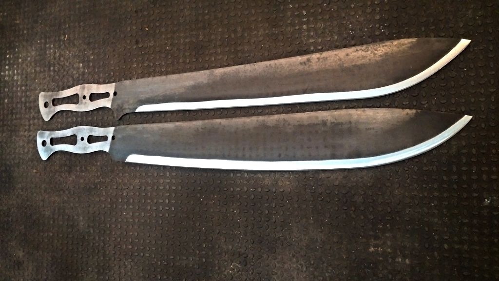

Comparison between Classic and Bolo Model

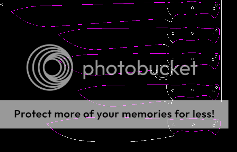

Here's a quick mockup of some possible options. The next run will have CNC scales, so as long as the handle is the same I can pretty much do anything people want in terms of blade shape and length.
Top to bottom we have
1. Regular 17.5in model
2. 12in
3. 12in Ring Choil
4. 10in
5. Small Bolo 13.5 in
I really like the way the 10 inch looks. I think it will be more than enough for what I need.
I like the 12", no ring. With terotuff!
Looking forward to seeing this happen!
I bought one of your scale-less blades a few months back. So far I have not had a chance to put scales on, but it works great with thick leather "scales" wrapped in hockey tape. The tape is not very durable but it was fast and easy.
Awesome Ill cut a couple of these for the spring run. I'd love to hear your feedback on how they perform as I won't be able to directly test all the variations myself.
Glad you are liking your blade! Just wait until you get some good scales on it and can really take a full power swing into some hardwood:thumbup:
Ill cut some 12in no ring models for the new run. I think the ring takes up too much edge on the smaller versions.
