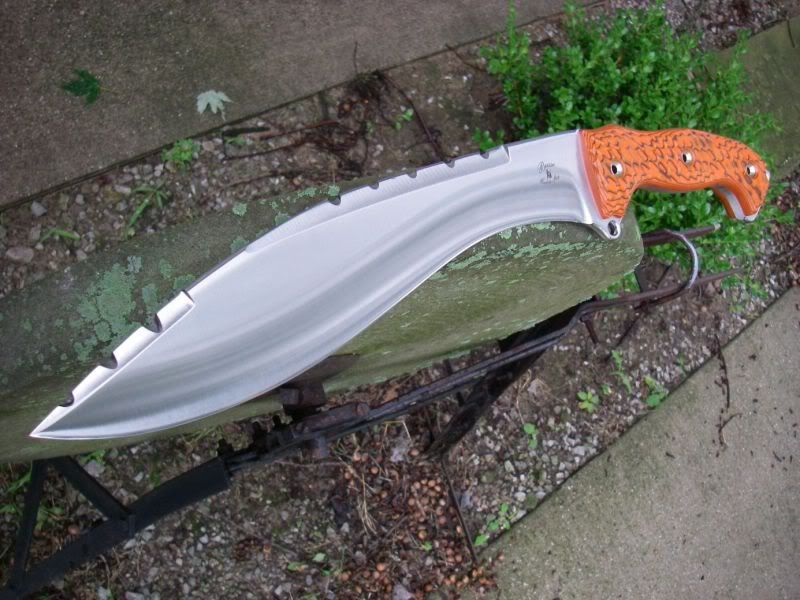

They weren't cheap, but they were sitting on the table ready to go at the 2010 AG Russell show so turnaround was not an issue. ;) As a custom order I have no clue how long they take, but Garth said there is over 20 man hours of work into sharpening each one of those nuclear Zillas which is why they were so expensive. They are in the Argonne Assault or satin Gladius price range for a reason.

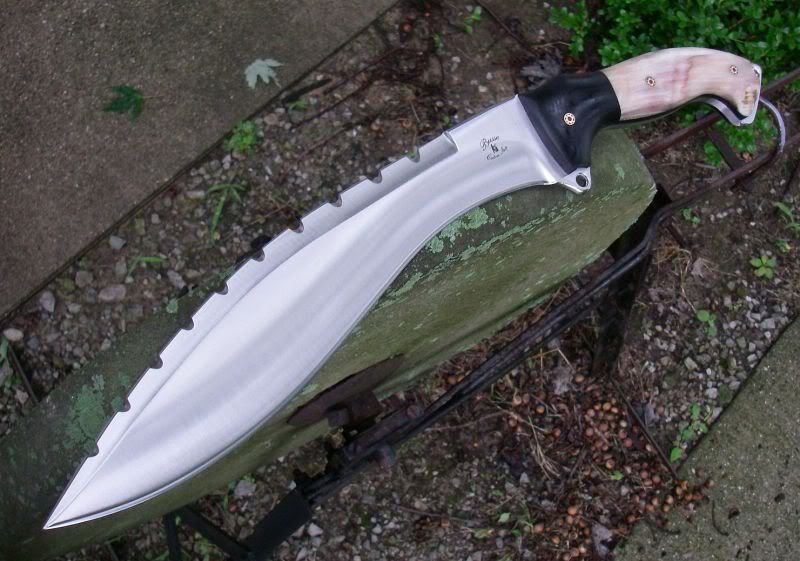

Some of Jerry's preview pics of what was headed to that show.
Here are just a few of the hundreds that are on their way!!!!!
Jerry :D
My personal favorite. :D
For sure, the serrations are not "saw" type. They are cutting, slashing type. Just think of it as a fully sharpened edge, with the added bite of the serrations.
You would not make much progress trying to saw a tough material like wood. They might provide better bite on materials like webbing, rope etc with a sawing motion.

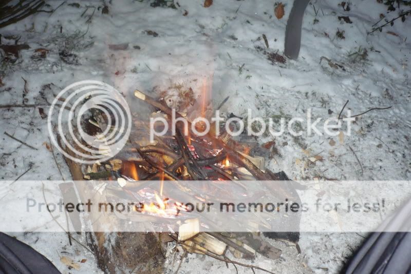

And the serrations are also handy for fire preperation if you just want to dig out a few wood chips onto a tarp to use as dry kindling ....
Gets a fire going nicely and with a Zilla you can keep the wood pile nicely stocked no problem ....
