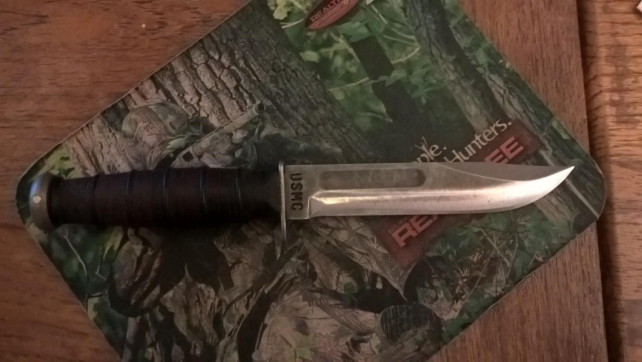

Hey y'all...
If ya haven't tried this, ...Plumbin' Fixture O-Rings, from the Hardware store/Depot, ...Really add a lot of non-slip grip (and a l'il needed diameter to the Short KA-BAR).
The (#x) is the O-Ring washer size.
They lock-in tight and will not "roll out". Ya bout have ta cut'em out ta get'em off.
I have yet to replace any of mine after several seasons of field use. (and the O-Rings come on packs, so you'll have extra in case ya cut one by accident)
Just costs a coupla bucks and a few minutes ta install.
Enjoy.
O-Rings for KA-BARs
(Five groves from Guard to Pommel)
- Drag the grooves w/ a loop of string to clean/clear them.
- Work from Pommel to Guard.
Full Size Fighting/Utility Knife (1217) Leather Handle:
- 5X #15
Short Fighting/Utility Knife (1250) Leather Handle:
Guard
- #12
- #13
- #13
- #12
- #10
Pommel
This is a Short KA-BAR...

Someone else posted in another thread about adding O-Rings to their Ka-Bar. I couldn't find that specific thread but they said they read it in another thread so I'm assuming they meant this one.
Used #15 O-Ring from Lowes, Plumbing, Faucet Repair Section, $2.49 for 10. Damn hard to get over the pommel. Just when I thought I should have gotten a different size, the #15 slipped on.
Wow, what a difference. Just enough texture to stop my hand from slipping on the leather, especially when its wet.

The #15 O-Ring is listed as 1" O.D. 3/4" I.D. 1/8" thick.
The leather handle on my USMC above is an oval and measures 1-1/8" x 15/16" to 1-5/16" x 1-1/16", narrow to thickest.
The #15 O-Ring stretches enough to go from 3/4" to 1-5/16".
So as long as your handle lies within that range, the #15 should work.
If not, the faucet repair section has lots of varying sizes so just select the next size smaller/larger as needed.
