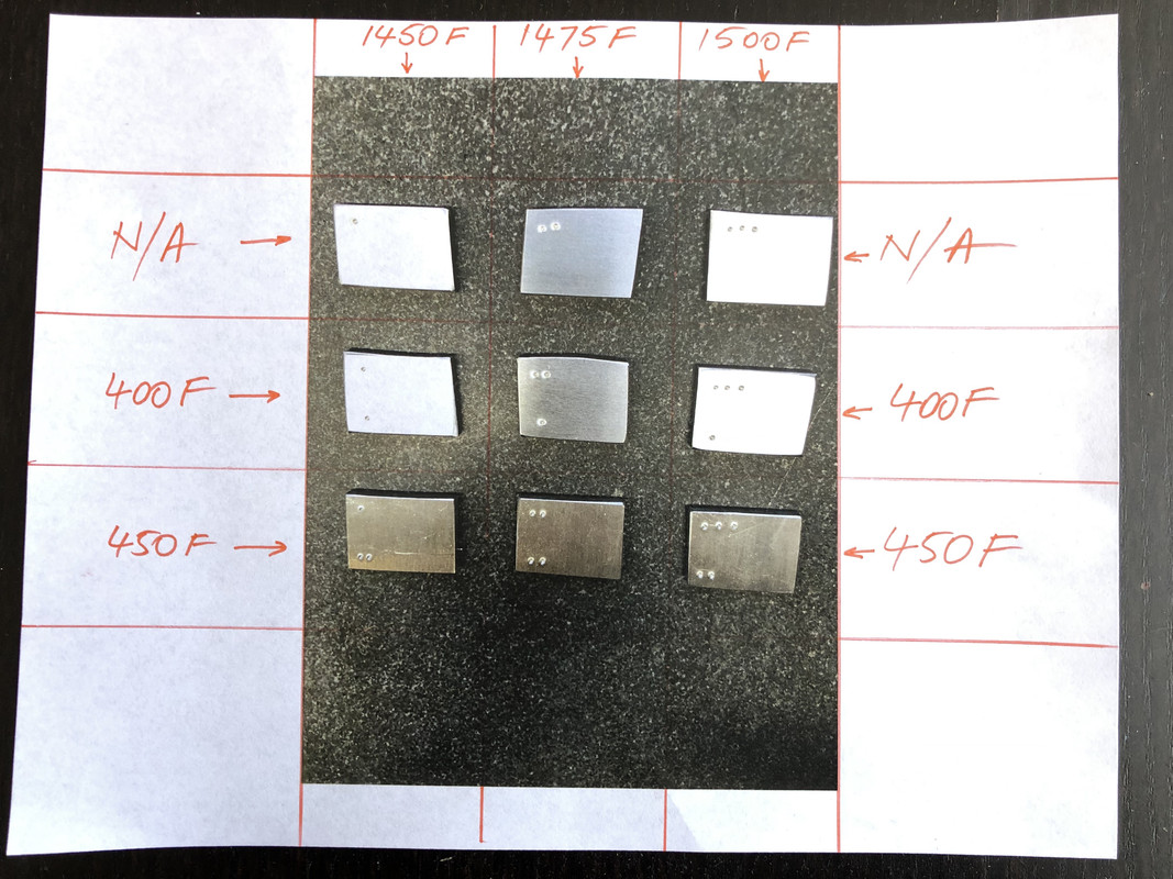

Hi again,
Here are the coupons, almost ready for for heat treat, as per feedback received. I plan on covering them with ATP-641 before the HT, as I usually do with the blades, just to be consistent.
Michael.Drinkwine Michael.Drinkwine , I’m posting this so perhaps other people would benefit from it. I’ll post my particular setup shortly, hoping some other folks use the same setup, or close to it. I hope this is ok. Please let me know if I make sense.
So, on the vertical axis in the picture, is the austenitization temperature. So the left top corner punch mark on the coupon represents just that, 1 punch mark = 1450 F, 2 punch marks = 1475, and 3 punch marks = 1500F.
The horizontal rows in the picture, are for 400F and 450F temper temps.
So, from a horizontal perspective in the picture, this shows the tempering temperatures and it’s marked on the left bottom corner of the coupon. One punch = 400F and 2 punches = 450F.
Please note, The first horizontal row is “Not applicable” because there is no tempering, just as out of the quench hardness baseline.
So as an example, a coupon marked as **/* as in * represents the punch mark and the forward slash delimits the "left top corner”/"left bottom corner” stands for at 1475F austenitization temp and tempering at 400F. Hope this makes sense, please let me know otherwise.
Thanks again,
Constantin

Makes perfect sense to me. For clarity you might include some additional information about your process, if you feel it is relevant. Stress relief cycles, put in a cold oven and ramped, put in a preheated aus temp oven, quench type used, cold treatment used, etc.
Michael
