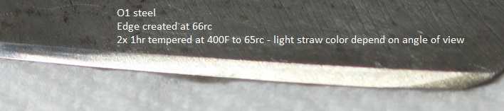

I just tempered 3 O1 blades from 66+rc to 65rc with 2x 1hr at 400F in my Evenheat oven. There is a light straw color for all 3 blades fresh ground surfaces prior 400F temper. I lowered these blades hardness because I want 15dps edge to macro ripple or roll when light chop a 16d nail on anvil. *note: one of O1 blade actually brine quenched, other 2 were P50 quenched.
