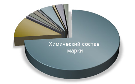

Here's the alloy that he uses,ХВГ (заменители(substitues): 9ХС, ХГ, 9ХВГ, ХВСГ, ШХ15СГ).
And it's composition:
C 0,9 - 1,05
Si 0,1 - 0,4
Mn 0,8 - 1,1
Ni до 0,35
S до 0,03
P до 0,03
Cr 0,9 - 1,2
Mo до 0,3
W 1,2 - 1,6
Cu до 0,3
Fe ~94
It's also a common alloy for drill bits and milling cutters.
But MOST importantly Michail works predominantly(if not exclusively)with this very alloy,and is an expert at HT-ing it.
Which is the crux of every one of these questions,as in:"Is this Unobtainium good for making an axe out of?"
The answer is simple:"ONLY if the maker can heat-treat it properly,to suit the given purpose".
