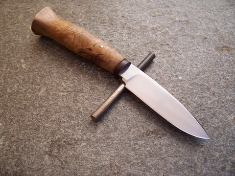

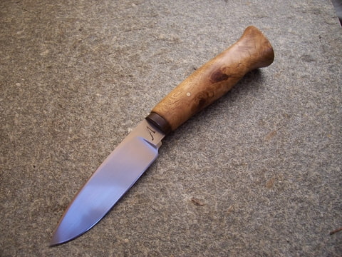

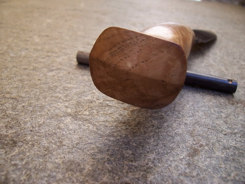

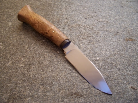

I had a rest piece of 8mm O1 laying around and thought I could make a nice little user out of it. Here is the result.
The blade is between 8 and 10 cm long (it is drying right now, so I'm not going to measure it). The handle I've kept a bit longer than usual, since I'll be bringing this knife to the sweden knifeshow. Because of the long winters over there, I thought a long handle might come in handy when wearing gloves.
Spine 4 mm and tapered to the point, satin finish 1000 grit, grip oak burl.
The curving part between ricasso and blade can be used for the firesteel. I hardened this part also, to get as many sparks as possible.
leather sheath with firesteel I still have to make.
ok here are some pics:
