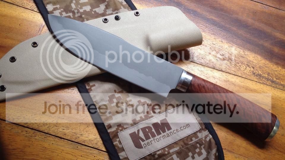

This is a great article as always. I may chine in a littlebit since I have some experiment on 52100 using low temp molten salt equipment.
The steel being use is bohler R100 shich pretty much identical to 52100.
All pieces has been thermal cycle normalizing and hardening by austenitizing at 1525F and soaked for 15 min.
The first coupon ate quenching from austenitizing to lower bainite range (425f) and hold it for 3 hours.
Another one are quenched to below martensite start point (385F) and holdit for 2 min and later forced air cool and then tempered at 415f. Both are test at around 61HRC
For some reason the edge holding of the bainite piece are significantly lower than the later piece ... even at the same HRC and similar hardness. Just my observation tho.

I use the coupons to cut some 2x4 and cardboard. The bainite piece has rather low edge holding.
In contrary the marquenching piece has much noticeably better edge holding than conventional queching.
Digital control low temp salt pot is very popular equopment among knifemakers here. There is a tool maker who make and sold them for $700. There are over 20 of it has been sold. Every makers who use salt pot reported to have the same experience on the improvement in performance. We use it for tempering too.
Actually the 52100 with conventional quenching and 415f tempered are HRC test at 59-59.5 HRC. The marquenching piece with same tempering are tested at 61HRC.

He marquenching the whole piece in salt pot and soak to get the bainite structure first and then do a different hardening by acetylene torch and quench into low temp salt again with set up equipment but this time just a minute soak and then air cool.
Good thing is when we start austenitizing and quench from bainite strucuture the martensite we got seems to be finer and tougher.
