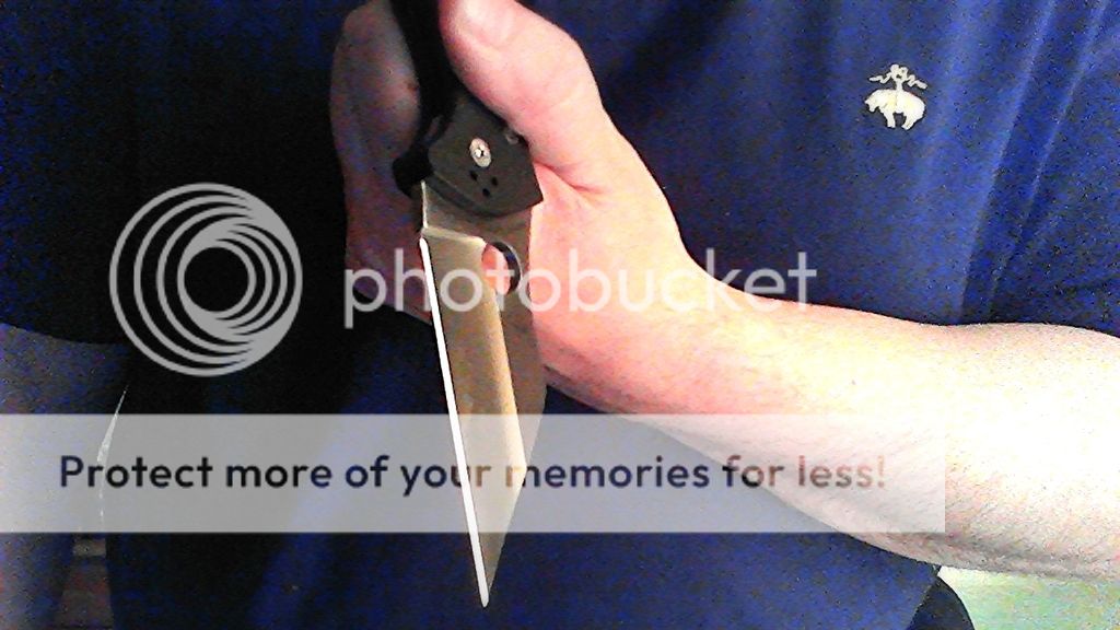

okay guys fine. All I have to work with is a webcam so go easy on me. To note I have already contacted Spyderco and am sending the knife back to them for "repair". I just cannot be without my Yo 2 in my back pocket so I went and ordered the S90V KW special that I will have on Monday. Then I will send in the S30V to Spyderco. In this pic note the staining around the center of the edge. It will not come off. Tried Benchmade Blue cleanser, Tuff Cloth and Ballistol.
Not sure what you've got there. Hard to tell from that pic, but Spyderco will get you sorted out.
just have a webcam to work with cannot get great detail. center of edge looks like fingerprint smudges is actually staining from what I dont know I just know it will soon turn to rust and yes Spyderco is taking care of me was just wondering if anyone else was having a similar issue with their Yo 2
