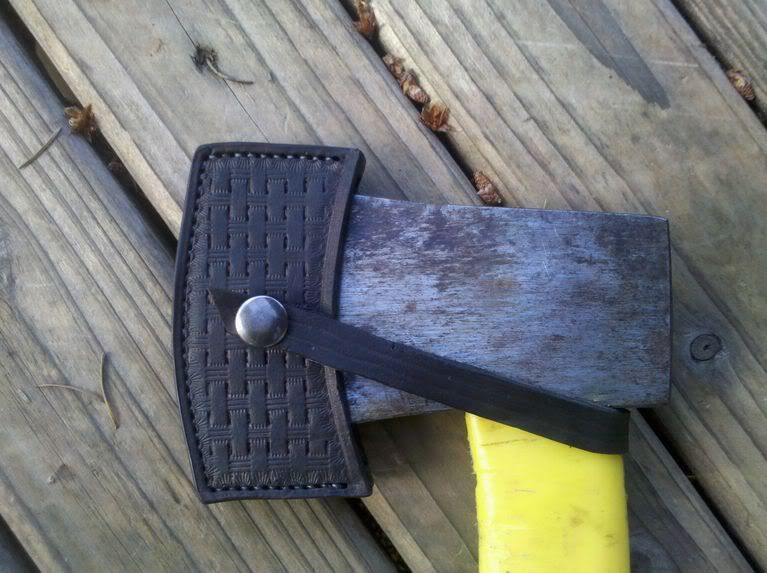

I use the Eco-flo dyes and I apply them with a piece of the blue heavy duty paper towels. I usually go over the leather a couple of times until the color evens out. It works pretty well for me. Here are a couple of pics.
