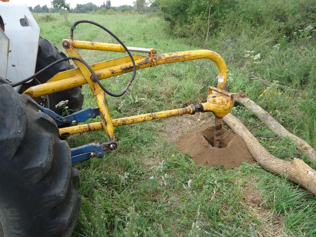

I like my posts set 4 feet deep (as deep as the auger will go, plus a little bit more).

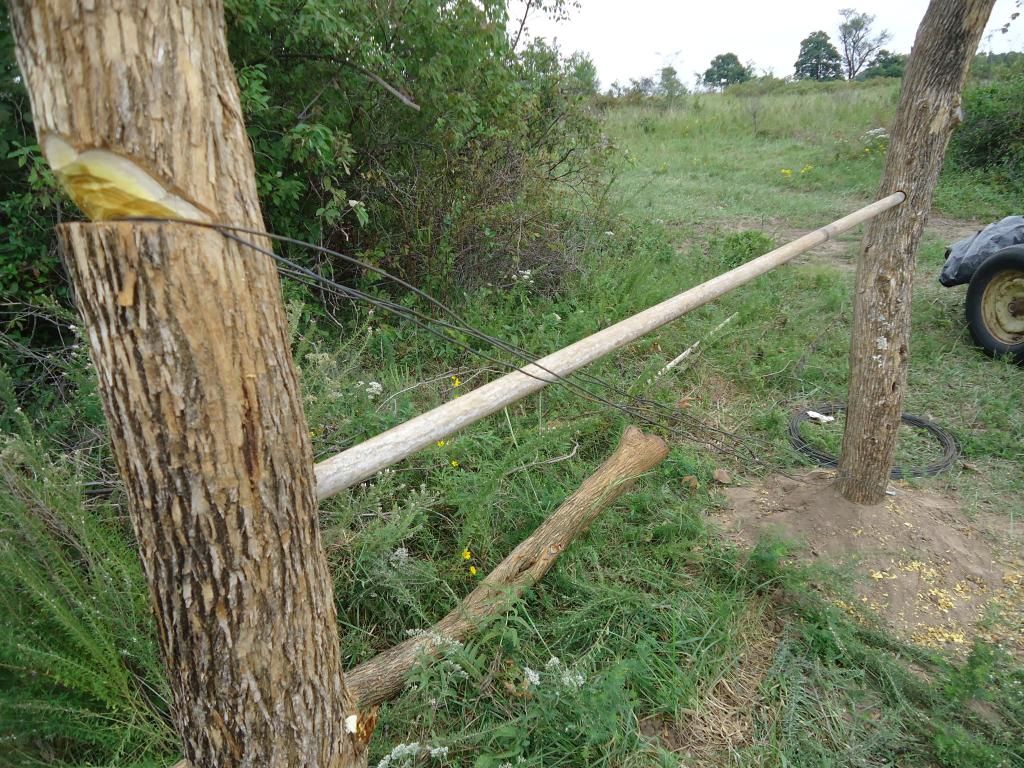

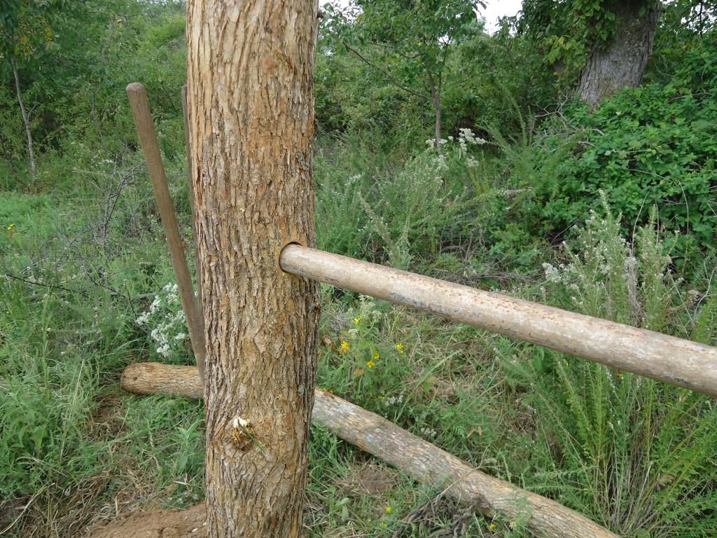

For barbed wire fences, I use a corner post and a brace post with a galvanized pipe as the brace bar. If you pay attention to fences when you're out driving around, you'll notice that brace bars often come loose. Not mine. I drill a hole with a 1 1/2 inch spade bit and put the ends of the pipe in the holes. As long as the posts are intact, the brace bar cannot fall out.

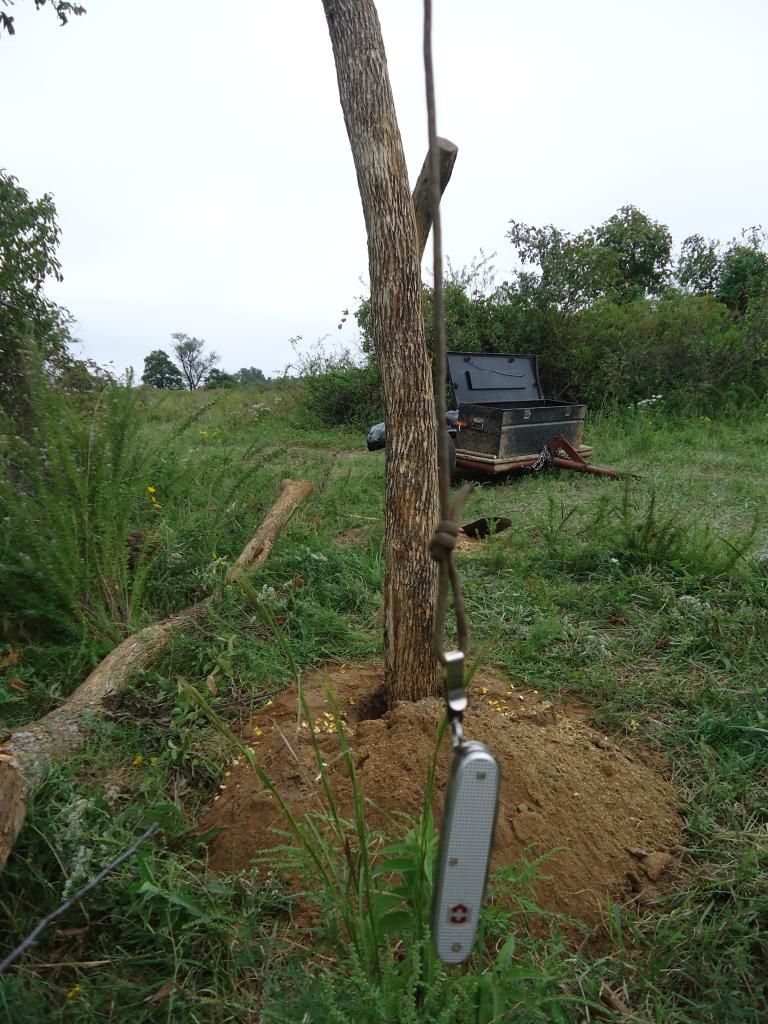

A Vic Farmer and some paracord make a fine plumb bob to check that the post is straight. Then put the dirt back in the hole and tamp. Tamping is the key, the most important part of all fencing. I have strong opinions on tamping which I will not delve into here.

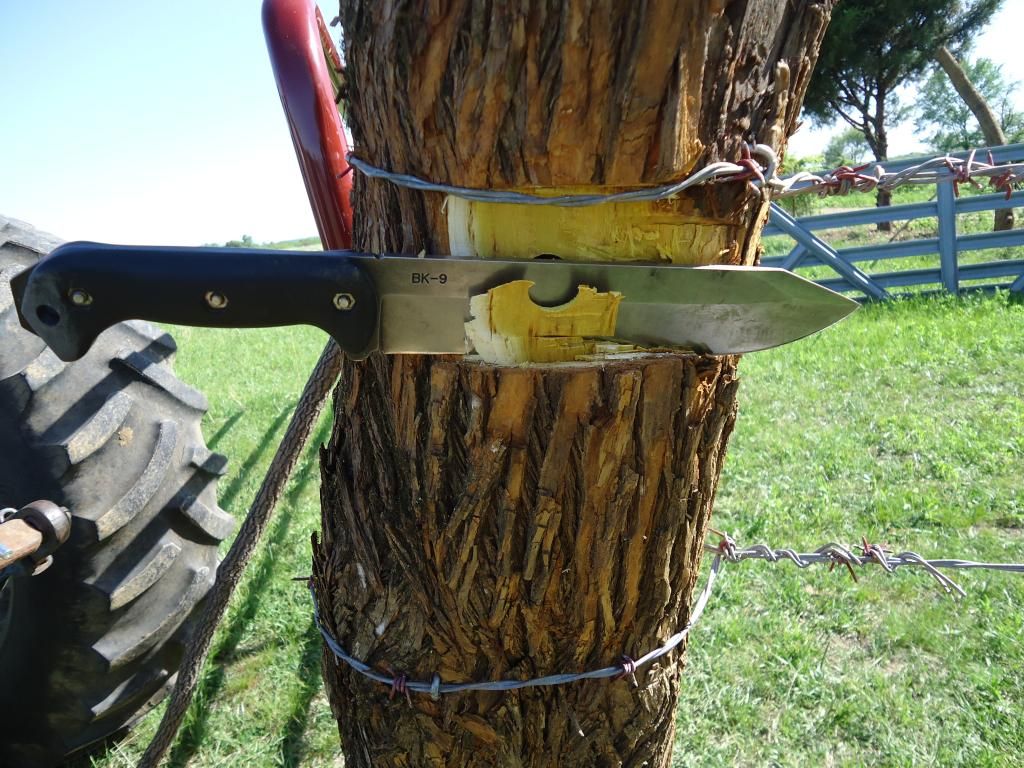

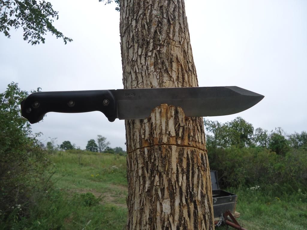

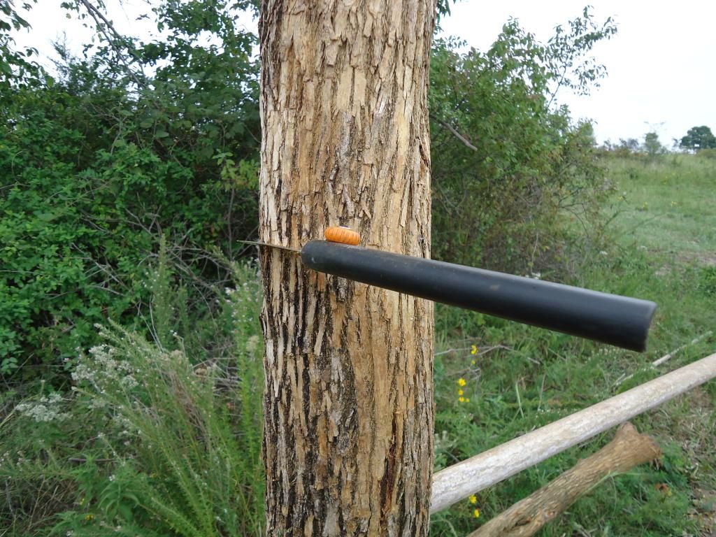

Next I need a notch to hold the tightening wire.
Then wrap the wire.
Then I need to cut a good stick.
Run it through the wire and tighten.

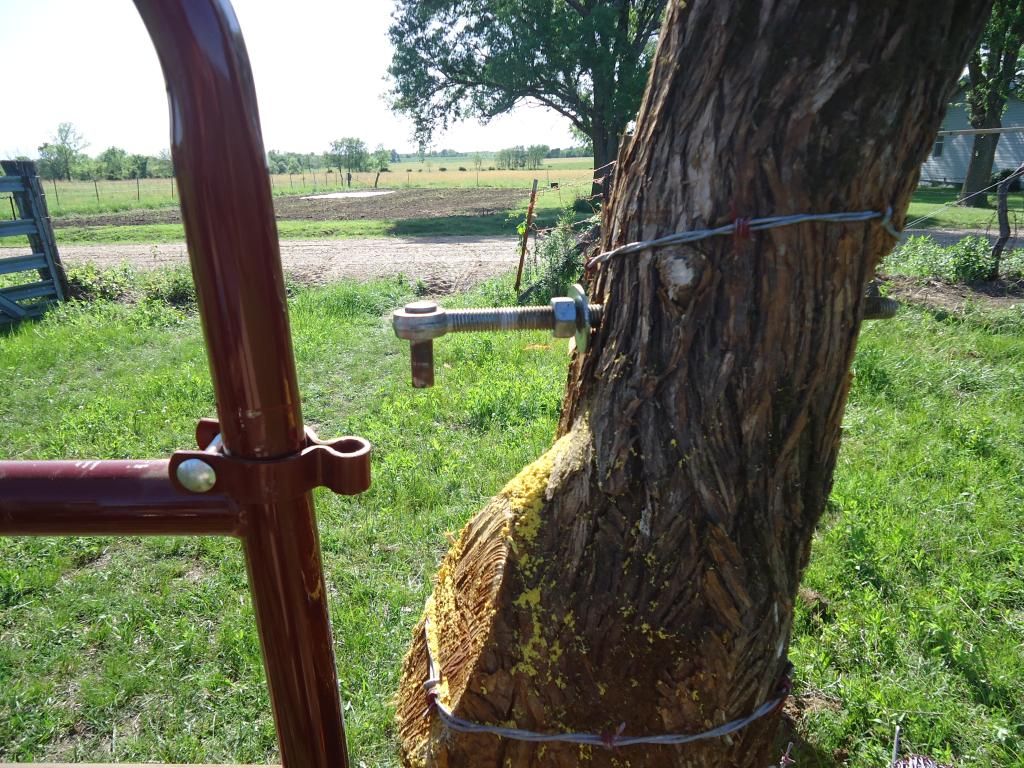

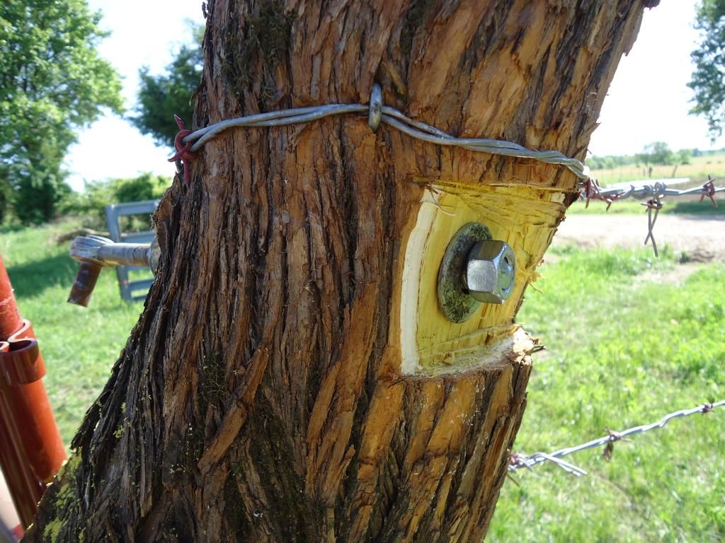

On this post, my gate hinge came up a little short.
I can't make the bolt longer, but I can make to post narrower.
This is what the tang extension is for; batoning point first.
Now it fits.
I don't know if you intended it to be funny, but using a plumb bob to check the straightness on a crooked hedge pole gave me a pretty good chuckle.

... with a galvanized pipe as the brace bar.
Field fence novice wonders ... why not a hedge post as a brace bar?
Many people do use wood brace bars. Then the posts must be notched and the bar nailed or screwed or pinned, and after a few years they often come loose. I just think a drilled hole and pipe lasts longer and doesn't require any hardware.

Those augers are a life saver, wish we'd had one!
