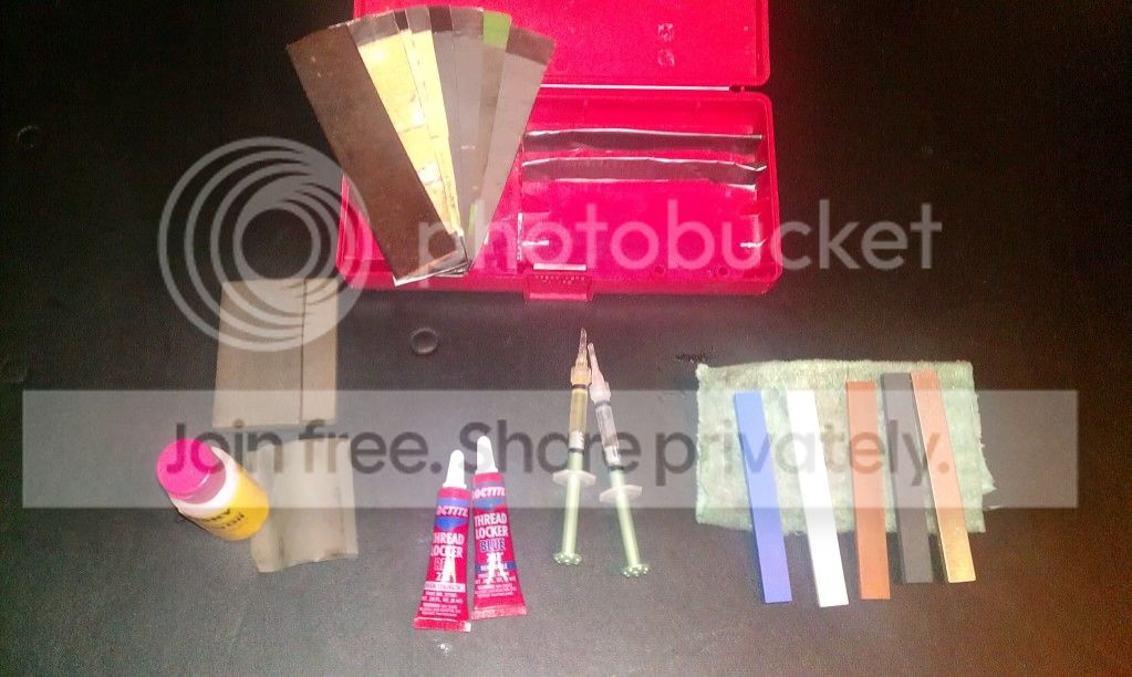

You know a lot of people don't think much of the Lansky, as it is, I would have to agree. But after scrapping just about everything except the honing oil, the stones (don't even have the plastic attached to the stones anymore) and a heavily modified red box, it's not bad as a free hand system, especially on the go.
Here is a pic of my new setup, something I would never have had, had I not started, and continued, with the Lansky system.
