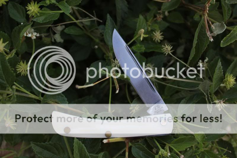

I've been using my Queen D2 Country cousin for a few months now, and food prep has really created an interesting patina on the blade. As you can see from the glamour shot I took yesterday there is a definite line of transition about 2/5's up the blade where the patina gets dark- it looks the same on the other side of the blade as well.
Any ideas as to why this occurs? Is this an effect of tang annealing on the steel structure?

I don't know the answer to the patina, but it certainly looks like differential tempering.

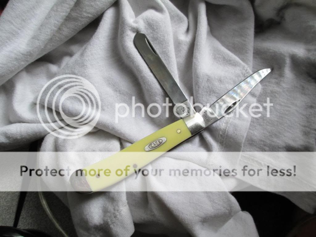

hmmm that is weird. can't imagine the tang anneal would go that high on purpose.
I'd noticed in the 'How It's Made' episode featuring Case's manufacturing, the annealing process they use extends considerably far above the tang on their knives too. On a small blade like the sod buster, it becomes much more obvious and covers a larger portion of the blade. The machine they use anneals a fixed span of every blade, held magnetically on a large wheel and then rotated into/underneath the heat source.

Sorry for the confusion fellas, it is indeed a mod- original thread here.
David, I think your screenshot makes this likely to be due to the annealing, thank you for the effort.
Thanks for the kind words on the long pull Charlie, I added it a few weeks ago- it was a bit hairy to do with a shaky micro mill, dremel cut off wheel and then a round sanding stone. If you look at the pic closely you can see a black line in the pull near the tip- the remants of the original nail nick. I didn't think I could bottom out the long pull without punching through the backside of the blade.

Yeah I guess I should have said other than air. looking again the scale isn't really, just discoloration. you would think that would draw the temper, but maybe its before heat treat?
That's essentially what annealing is. After heat-treat & quench, the blade is re-heated to a somewhat lower temperature. I think this is often done to de-stress the steel, which otherwise might be prone to cracking after the quench. Manufacturers do it to soften the tang for stamping the mark on it, OR for making the blade receptive to crinking/bending for final fitting (I think this is why Case does it). This is why it's best to avoid testing RC hardness on or near the tangs of blades, because they'll often be unrealistically softer than the rest of the blade.

I am aware that annealing is the removal of any effects of heat treatment or other hardening processes (which could include cold work when the sheet is rolled and forge work when the blank is stamped). It would make most sense to anneal the tang after all heat treat, but there are other possibilities I suppose. annealing may require cherry red, which seemed pretty clearly limited to the tang in the video. otherwise it seems case is endangering the temper of a useful part of the edge. surely not.
I was interested to see that the video said that the nicks and stamp were made during the blade stamping operation. I think you want a soft tang to keep it from eating the pin and for strength at a highly stressed area, or perhaps i should say toughness.

I had an interesting email conversation with Marcie Tully of WR Case about the softening process. She wrote that
  • the post tempering hardness of a CV blade is 58 to 61
  • the tang of an un-crinked blade is softened to ~ 46-51
  • the tang of a crinked blade is softened to 34 to 41.
If the heating and softening truly extends as far up the blade as that staining pattern, that would explain a lot as far as the hardness Case says CV has after tempering vs the performance of Case CV when compared to that of GEC 1095. This is something which has puzzled me, since GEC says they run their blades at ~58. GEC 1095 holds an edge noticeably better than Case CV.
