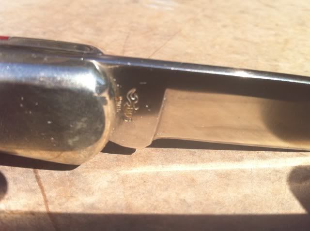

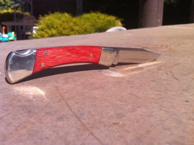

Hello All
My newest addition to my collection Custom Buck shop 110, S30v, Cherry Wood w/ studs and Nickel plated got some rust after first time of use
I decided to use the knife during the BBQ last weekend and somehow the knife ended up on dishwasher.(this sucks I should had known better not to let my wife use(she had good intentions on getting it clean))
When I checked this morning the knife was in the kitchen and had some rust on it.
What can I do to fix and remove this rust...there is some stain on the bolsters also, what can I do to clean this up?
Thx
Cheers

Cleber, that's sucks about your new custom knife... Leroy R. told me a long time ago not to ever put any of my Buck knives in a dishwasher... You can get pits on the blade and rust... :eek: ... Hand wash is ok but always dry it real good with a hair dryer... ITE ...
Try some flitz metal polish on a q-tip to get in the tough spots,then wash with dish soap,and rinse/dry very well.Give it a drop of oil in the pivot,you'll be ok.
I agree with RAZORBLADES, the problem at this stage is only cosmetic and very fixable. Just don't put it in an electric dishwasher again.

Like Razor said, Flitz or Mothers Mag wheel polish and use elbow grease and cloth . Then just keep rubbing . After it goes away wash and use oil on that area and keep it in your shop . DM

I use Hoppes oil out of a gun cleainig kit-works great, no smell, doesnt get sticky. Tastes good with steak if you dont wipe it off good enough before using:p
I have used Mothers let dry and scrub with the rough side of those green and yellow pot scrubers and clean with a fresh cloth
